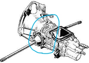

So I've taken in consideration an option .
Custom build one.
To adapt the original gearbox to the engine I'd have to laser cut an adapter plate ,then skimmed to make it perfectly flat and parallel.
Because of the bell housing which requires mods too ,cut parts etc.
Being this project a rally car,it will be always under load,stresses etc
My idea is to build the new housing out of steel ,yes more weight but an initial disadvantage can be considered a bigger advantage.
It's placed right in the center line of the car longitudinally , and at floor level.
This would surely increase weight but , it will make an huge difference in matter of weight distribution and center of gravity of the car itself
Mid rear so it will be less prone to roll over in my head.

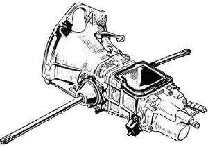

This part in the middle is what contain the differential
I believe it would be possible to make it ,line bore for the shaft put .

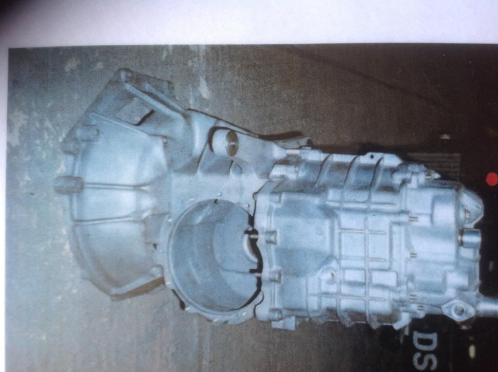

And drive the diff using the output shaft from a FCA group modern 5 speed transmission (obviously modifying it) .
Also the diff from the same transmission so modern axles can be used "solving" several problems
I should take a modern gearbox, a 126 gearbox dismantle both study both and make it fit "together"
Unfortunately rules Don't allow me to cut the original car frame otherwise engine and gearbox would sit in the car as in a normal FWD car but moved to the rear which would be ideal.
This idea involves custom built input output shafts, gear housing, and modern stronger gear train from OEM.
It's hard to understand I guess but it works in my head

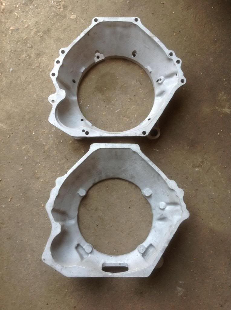

I don't know if you need to go as far as laser cutting and skimming.
I've seen bell housing adapters made by people just drilling a ring of holes and cutting it out with a jigsaw.
A decent bit of billet should be flat enough for that job as supplied. I bet if you could accurately measure the angle between the original belhousing face and the input shaft it won't be 100% from the factory anyway..
