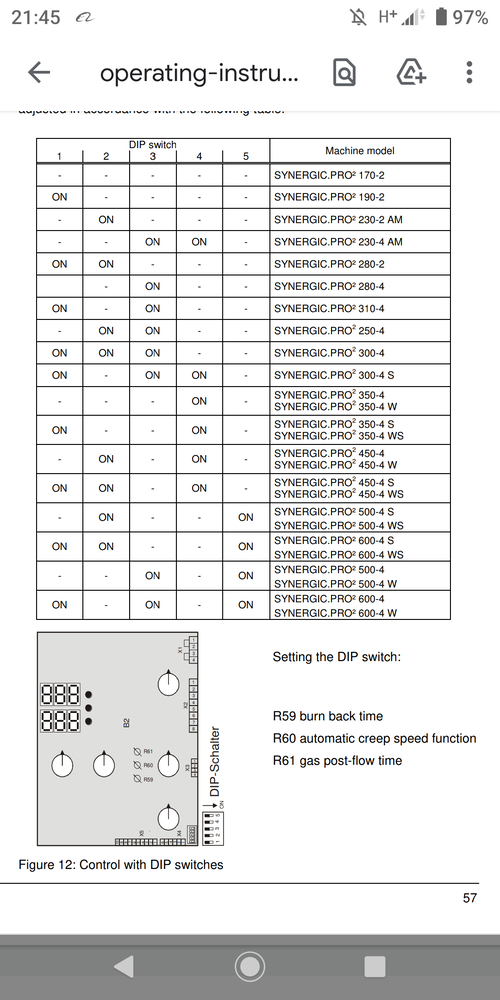

Hi, just bought REHM Synergic 230-4. I want to change burnback and postflow gas. In manual it say to change, R59, R60, R61 potentiometer. I cant find it. Does anyone have experience with this model?

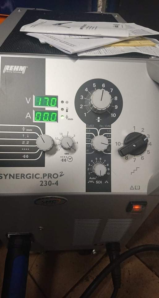

Thanks for you reply. I have my welders front photo. If i look to manual it refer to R59. Isint that wire speed knob? I check my DIP SWITCH. Its correct 3 and 4 position is ON. I dont understand where i make mistake. Seems everything clear when i look at manual. But i can change only wire speed. Maybe there is special knob combo? Thank you for your time helping me.

I don´t own that machine, but it seems that you have to open the cover to get access to the 3 little pots on the board to change these parametres with a little screwdriver. It´s not possible to get there from outside.
