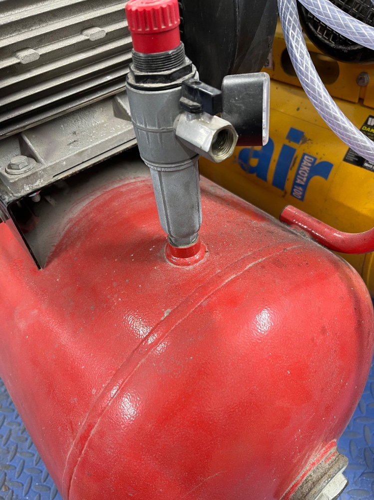

V Vixerfixer123 Member Messages 45 Location West midlands Friday at 5:31 PM #1 Hi folks,is it ok to blank off this regulator,as it’s leaking? IMG_2115.jpeg 327.2 KB · Views: 23
V voipio Member Messages 3,846 Location Not Cambridge Friday at 6:28 PM #2 The outlet valve is set to the "on" position. Could that be the cause?
V Vixerfixer123 Member Messages 45 Location West midlands Friday at 9:39 PM #3 voipio said: The outlet valve is set to the "on" position. Could that be the cause? Click to expand... Yeah it is the valve,it leaks when closed.

H hotponyshoes Member Messages 7,600 Location Somerset. Uk Friday at 9:44 PM #4 If you don't use it the just remove the whole thing and put the blank on the tank. Will prevent any further leaks in the future.
