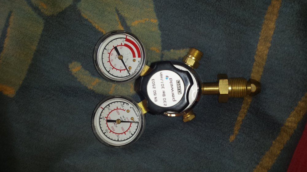

choco Member Messages 452 Feb 8, 2015 #1 Can some one be able to tell me if this regulator will fit an argon/co2 bottle for mig welding. Thanks. 20150208_155323.jpg 102.6 KB · Views: 90
gordon stephenson Member Messages 7,455 Location Skelton in Cleveland U.K. Feb 8, 2015 #2 Cant see too well in the pic.But it it has a rounded nose on the fitting it will fit. Just make sure the pressure rating is adequate for the bottle pressure.

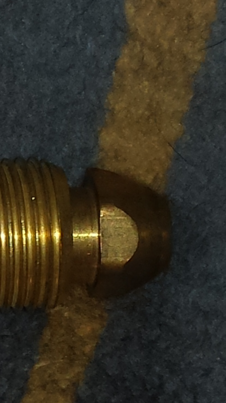

choco Member Messages 452 Feb 8, 2015 #4 This is a close up of the fitting Screenshot_2015-02-08-20-00-35.png 375.7 KB · Views: 68
HMB Member Messages 1,241 Location Essex near the Thames Feb 8, 2015 #5 Looks like a bull nose. As long as its rh thread and 1st stage is rated for your cylinder yourll be good to go
