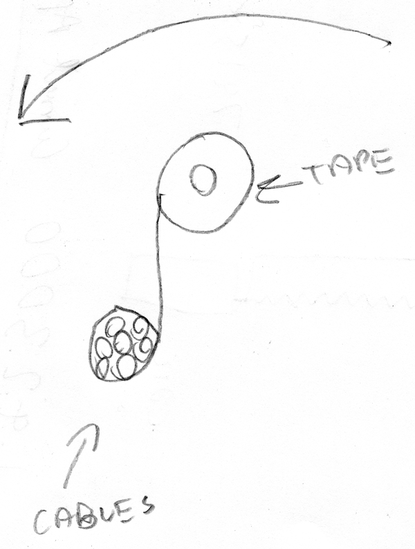

I've finally managed to get time to strip the rest of the wiring loom out of the camper and I was thinking of buying a new one to replace it, however they now seem to be around £300 and not quite correct for our camper.
So now I'm thinking of keeping the original one, cleaning it up, replacing all the connectors including the few multi blocks and retaping it.
For cleaning - carb cleaner for the general muck and something a bit stronger where its got old overspray on it.
New connectors - use the crimp ones with heat shrink casings
'Modern' multi blocks instead of the blade type
And possibly a blade fuse block instead of the old torpedo type
I may add a few extra circuits as well!
Sound like a plan? Anyone got a better ideas?
