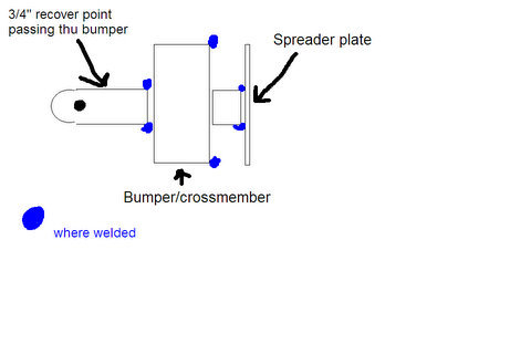

hey guys im think of using these http://cgi.ebay.com/ebaymotors/Heav...tegoryZ33653QQihZ007QQitemZ170113572655QQrdZ1 with shackles thu them as recover points on my suzuki front and back bumpers. Trouble is no one in this country makes and sells them and i dont think i would be able to make them for the money i could get some to do them for me.
i have no doubt the piece its self is strong enough to with stand the forces involved in recovery but would 150mm or weld?
dont hold me to this or shoot me down but from what i can see is over in america they mainly rock crawl so recovery is mostly the weight of the truck on its own. However over here its mud mud and more Mud and when your up to your axles in mud the forces are alot greater @least double/tripple.
Maybe if the pieces were long enough to go through the rear xmemeber and welded onto a spreeder plate with was welded on the back of the cross member and also welded on the front where it come thru the box section bumper/rear crossmember.
