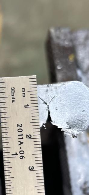

No matter what settings I can't get the sides of the rebar to fuse.
16mm rebar, 0.9mm wire, Ar80%/20%CO2, 180A, 27V, 320mm/min travel speed, short vertical weaving up and down, stick out 15mm.
I'm starting to think that vertical down is a nearly impossible and it should be vertical up.
Anyone have success with vertical down?
