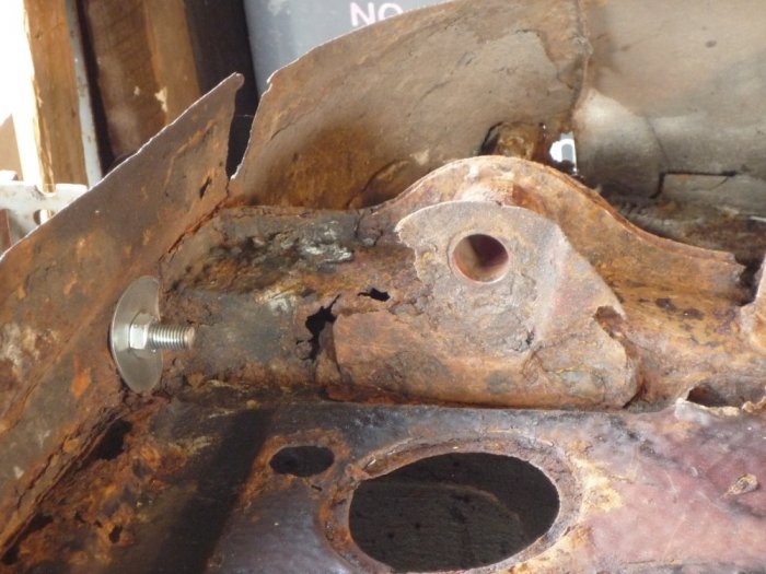

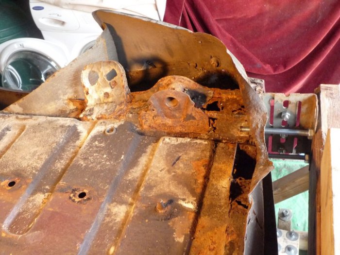

Hi All, I am renovating a 1979 MGBGT, Has anyone seen any photos on the forum where rear chassis repair sections are being replaced? the part where the leaf spring shackle attaches to the chassis, I have made a rotisserie so I can turn the car upside down which was useful for repairing the cross-member, sills, and floor panels, I have never repaired this part of the chassis and never seen it done so I am not shore where to begin, As the rear of the car is fastened to the rotisserie at the chassis the car will have to be taken off the rotisserie and supported to work on the chassis!there are a lot of spot welds inside the boot/trunk to drill out and a lot of welds underneath to be separated so is it best to work on the car in the upright position or turn the car upside down? once the work has started I will be unable to rotate the car until the rotisserie and chassis are reconnected.
