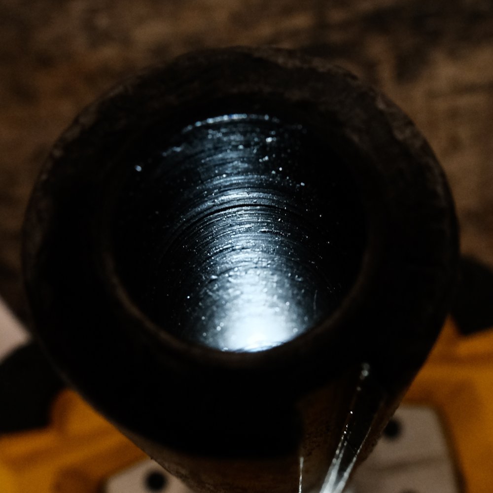

I plan to ream the MT2 tailstock of my Harrison L5 because a previous operator has spun tooling and grooved it pretty badly.
What is the correct or best way to go about this?
My initial plan is to chuck the reamer in the 4 jaw and get it turning true then set the lathe to the slowest speed and peck at the tailstock with a regularly oiled/cleaned reamer until a reasonable amount of grooving has gone.
Then lastly remove the quill and face the end off so that the tooling doesn't bottom out before the taper locks.
Should I confirm the alignment of the tailstock first using a centre?
Is dykem layout blue ok for checking the contact area or do I need something else?
Is this something I can even be trusted to do or should I ship it off to somebody that can do it?
Would pictures help?
Bearing in mind that I have very little machining experience and certainly didn't do any at school, not even a wood lathe (I'm too young to have had a real education; mine was all screens and keyboards)
