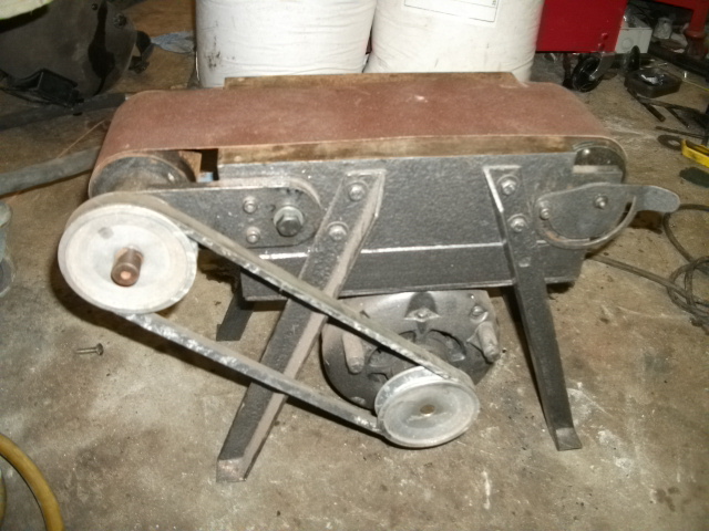

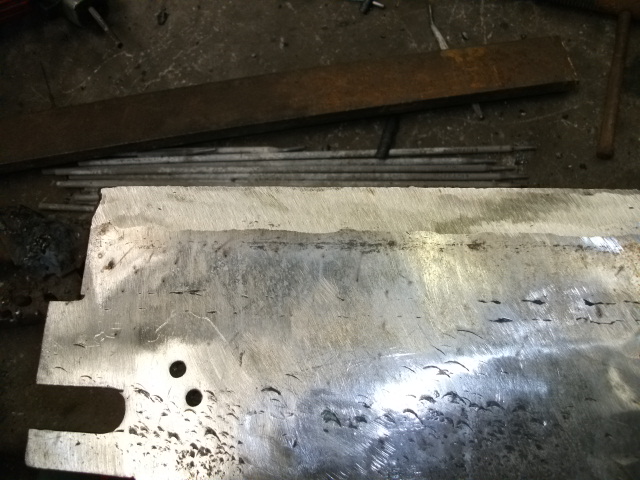

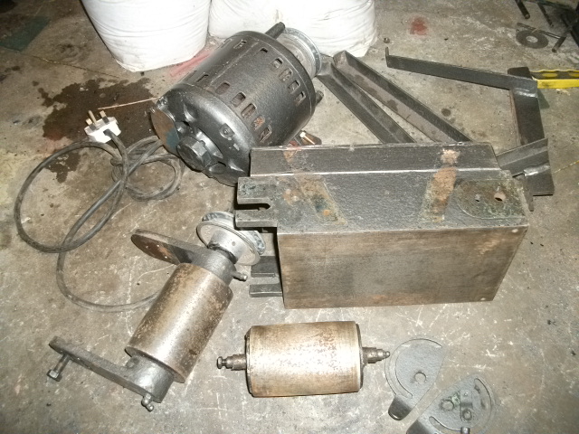

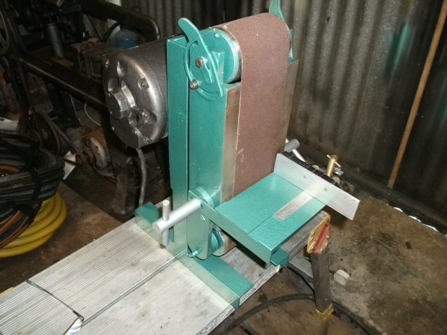

after over 30 years of good service i decided to improve my belt sander . it didnt have a protractor on it so angles were guess work. heres the before and after . the protractor was a cheap afair which i improved and made new adjusters for and fitted a fence so when doing angles theres no gap between the belt and fence . the sander is now vertical . ideal for sharpening hss lathe tools ect
