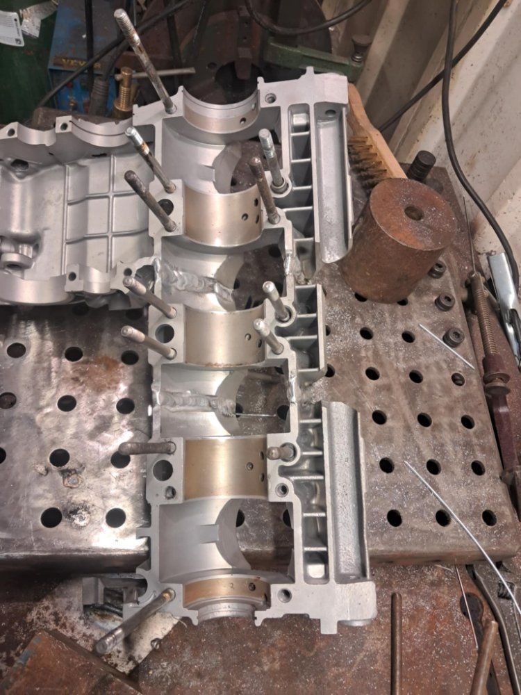

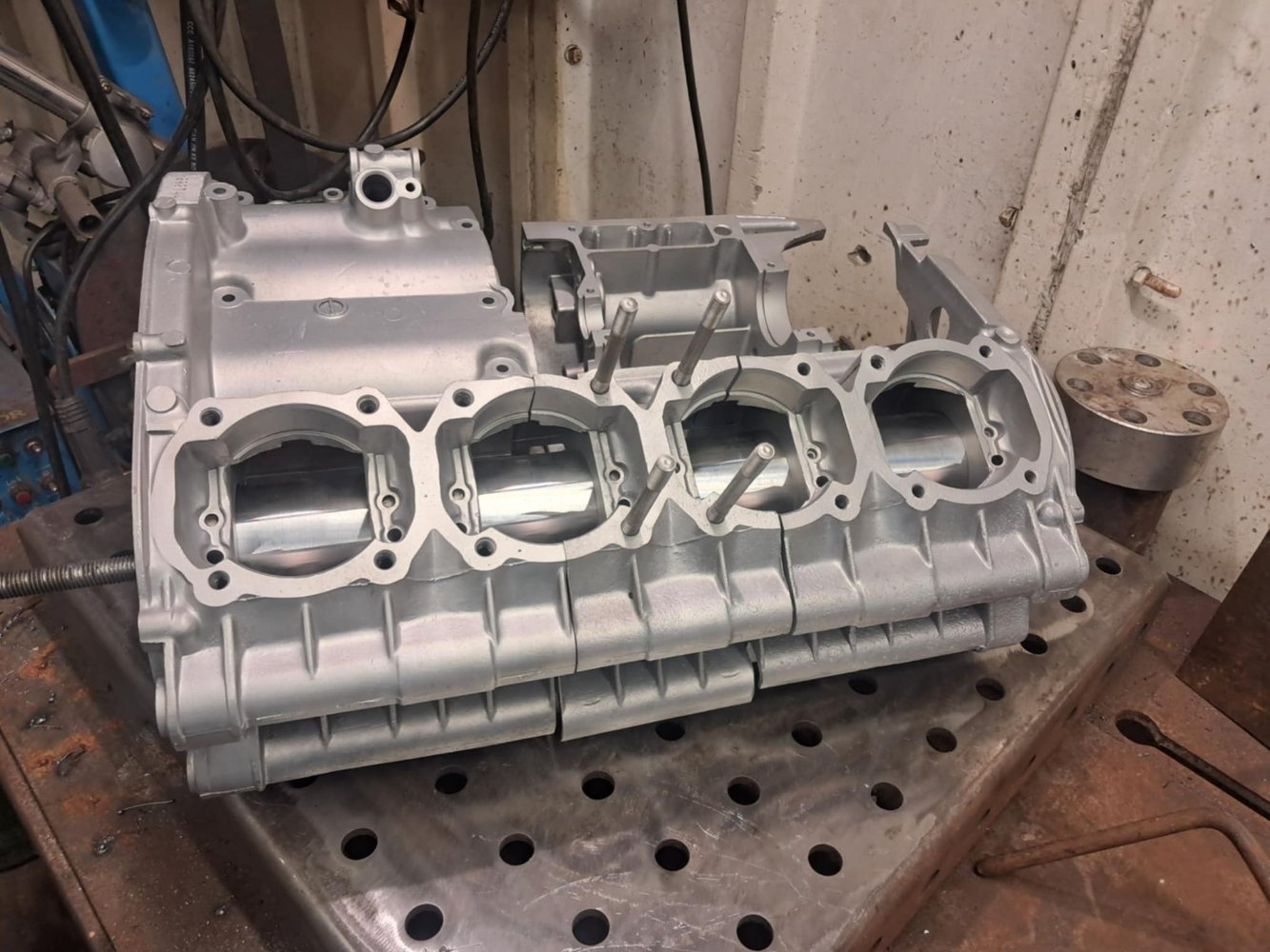

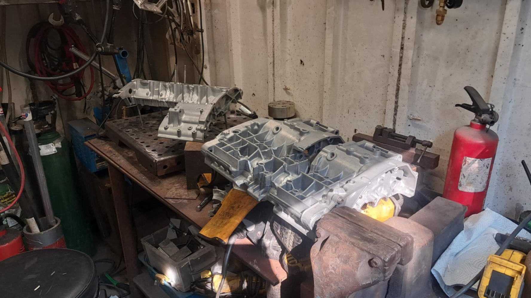

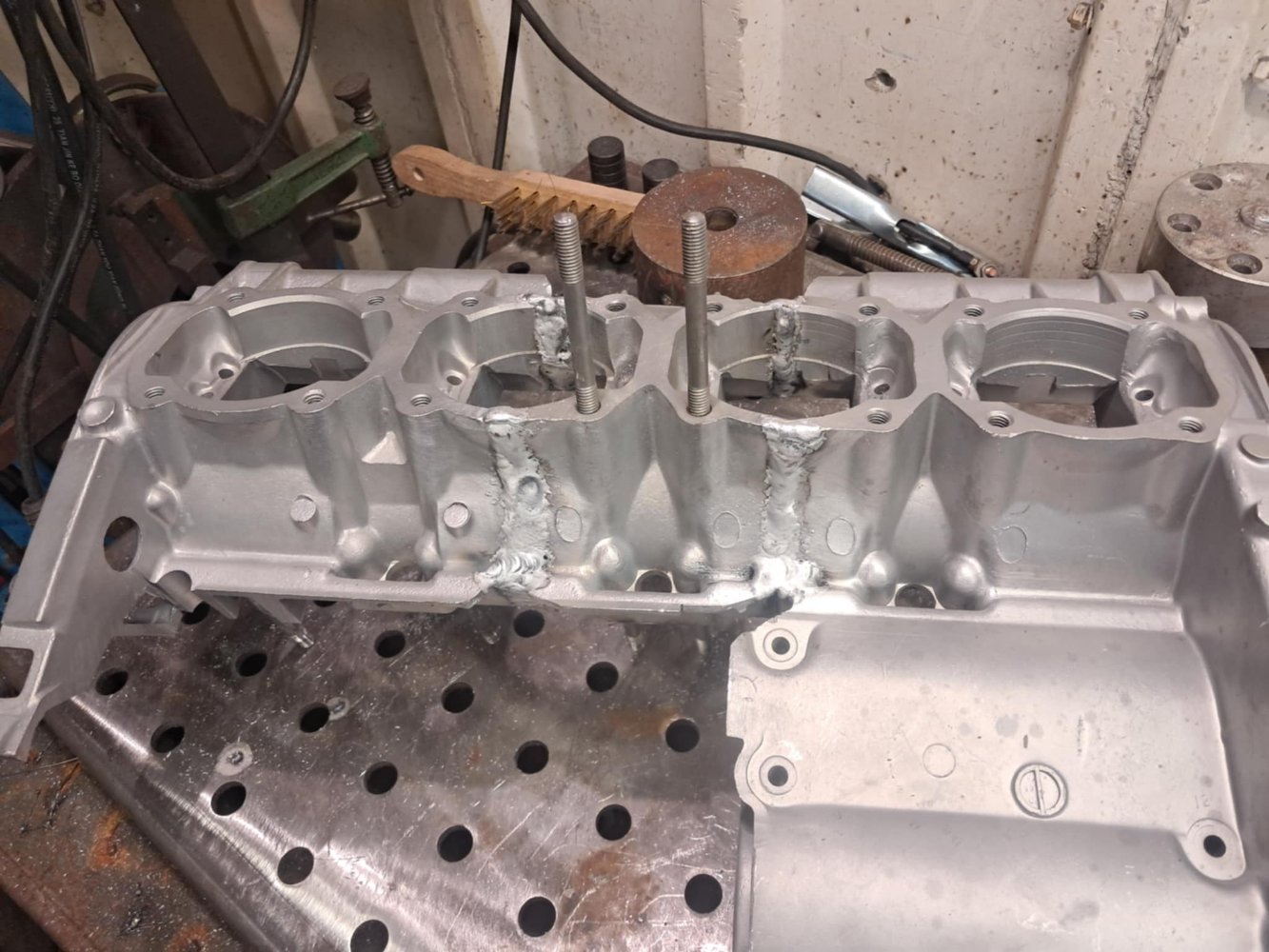

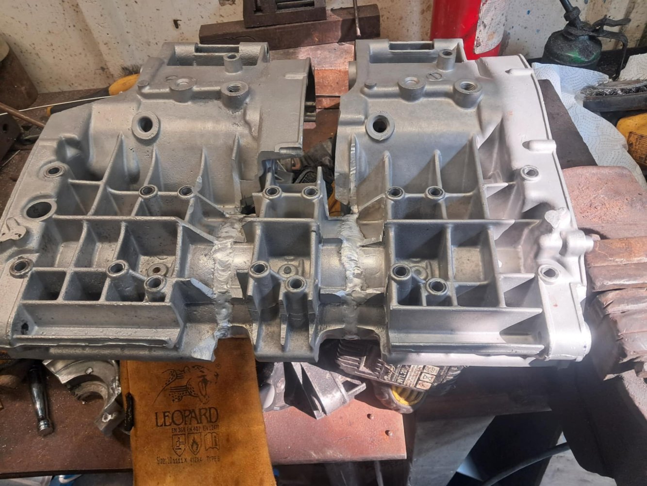

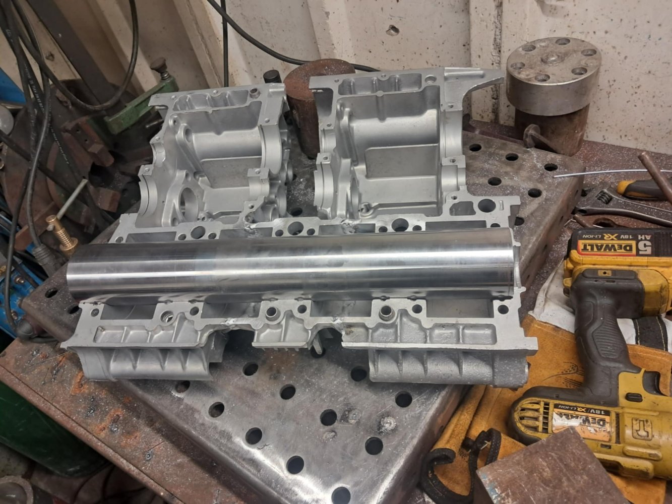

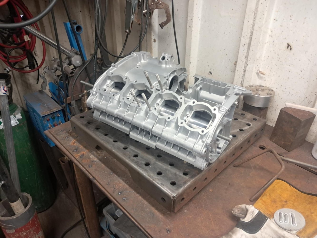

ThingsI have been asked to help with this project.
2 RD 250 engines made in to a in line 4.

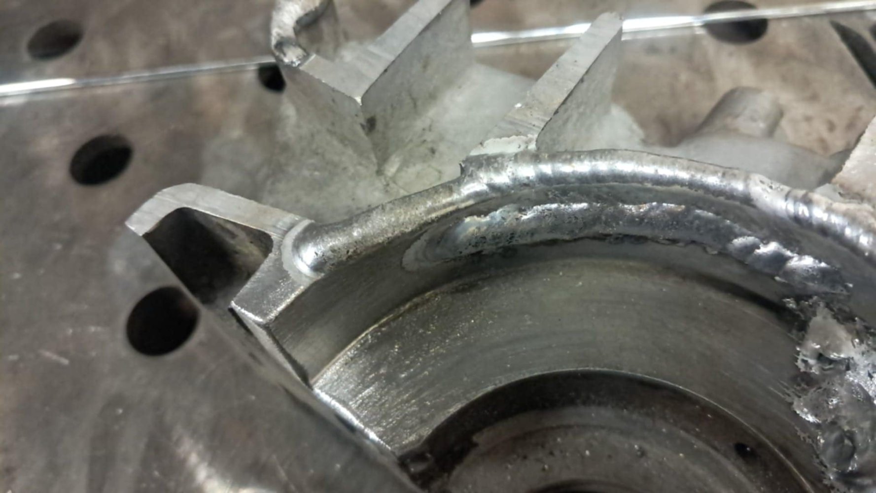

I will be doing the welding.
T tried a scrap bit even dirty it welds ok.
There will be plenty of video to come .
View attachment 494825View attachment 494826View attachment 494827View attachment 494828

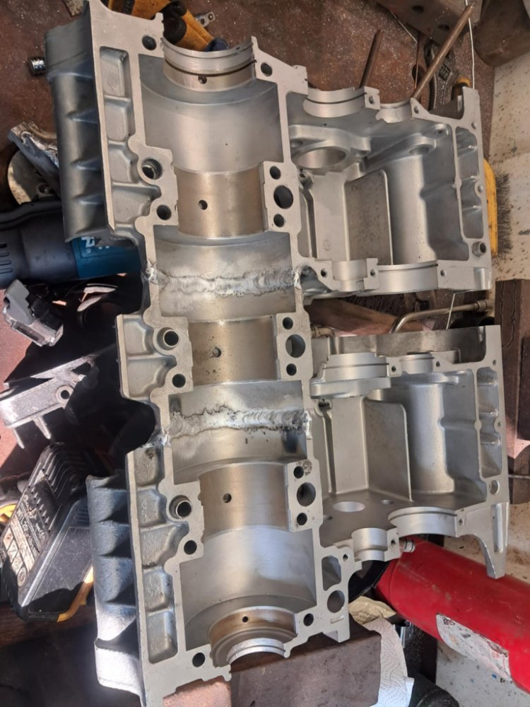

Think thats what the machined bar through them is supposed to do.Are the crank bearing faces going to be line bored/reamed to ensure everything lines up?
Thesolid bar they were welded on should have kept them in lineAre the crank bearing faces going to be line bored/reamed to ensure everything lines up?
