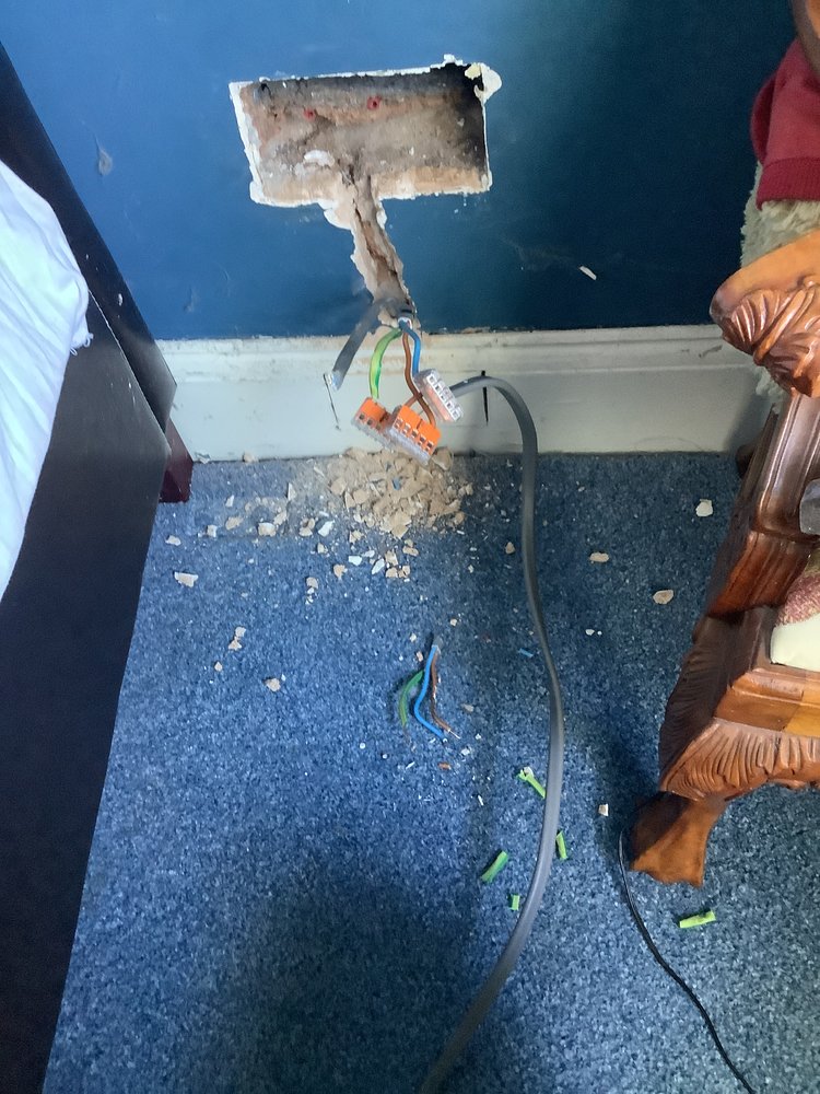

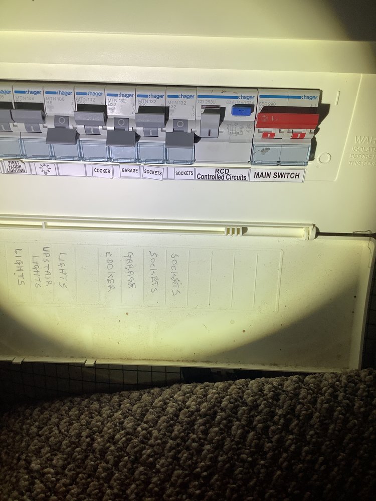

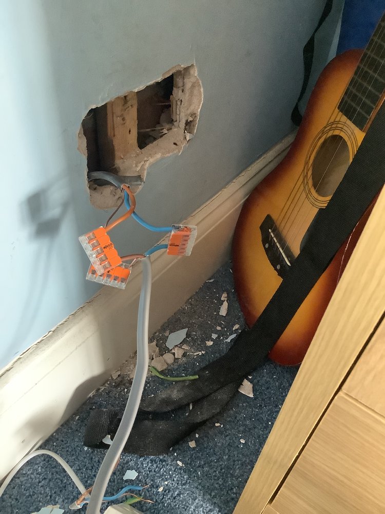

i did one yesterday a trapped neutral behind a socket to earth had to take 4 sockets off to find it and test with meter .bout an hours work
just take extra care with face of the db off live cables exposed and socket
