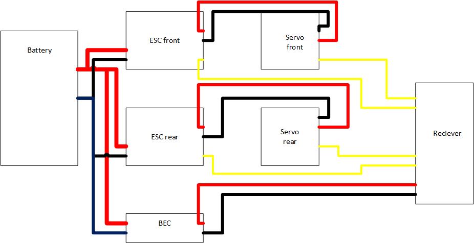

current project is going to be dual esc 4 wheel steer.
Heres how im planning to wire it up.
my only concern is signal only from escs and servos no ground.
Is it likely to be an issue. info on dual esc setups is sketchy.
1080 esc becs are 8 amp each and the servos are beefy which is why i want to go this way
