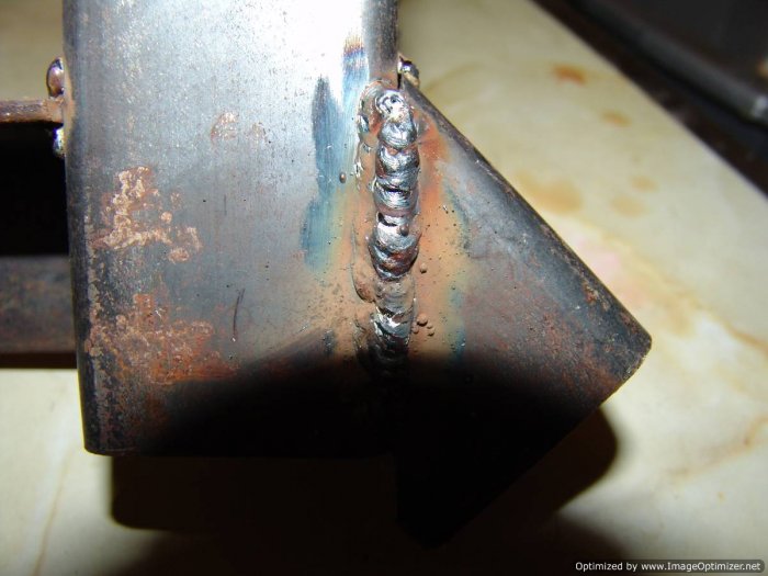

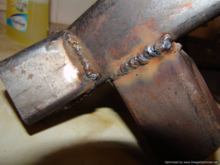

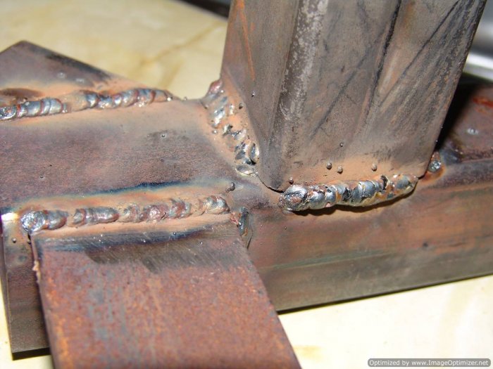

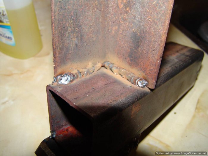

cheers for all your advice yesterday, as advised i ditched the gasless wire and fitted 0.6 solid core and used pure CO2 gas.
i upped the settings to max i theink it was max, 2. wire feed was at 5
i immediately saw and felt the the difference
i think they are better than my previous post although any advice will be greatly appreciated
