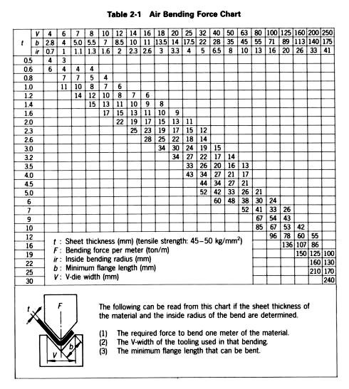

I have two home made folders, at 500mm & 1000mm, that do all of my general folding. But have been hankering after a powered press brake at 2000mm long. Nearly all my stuff is 1mm. thick, but let's say up to 1.5mm.
So, what power would the ram need to be? I know that this depends on the width of the V in the former, but anybody got a ball-park figure? ( I looked in my engineering manuals, not much there.)
