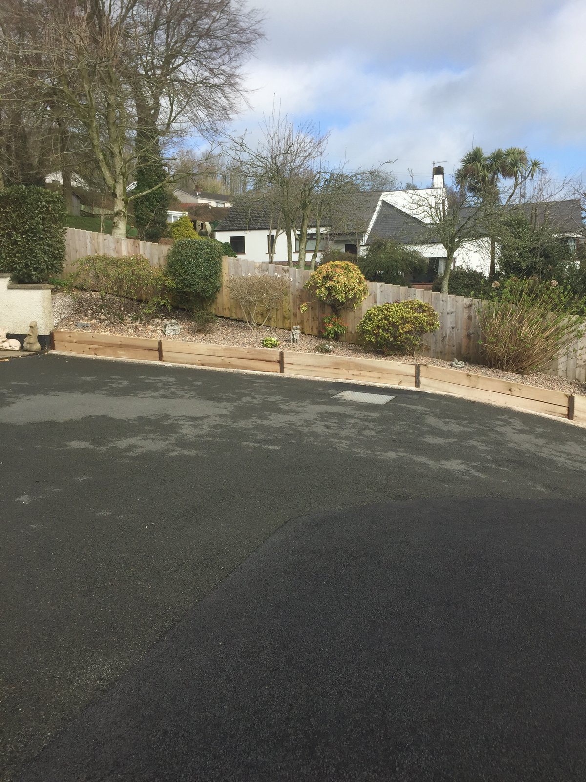

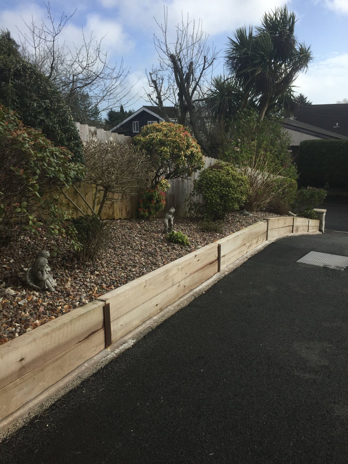

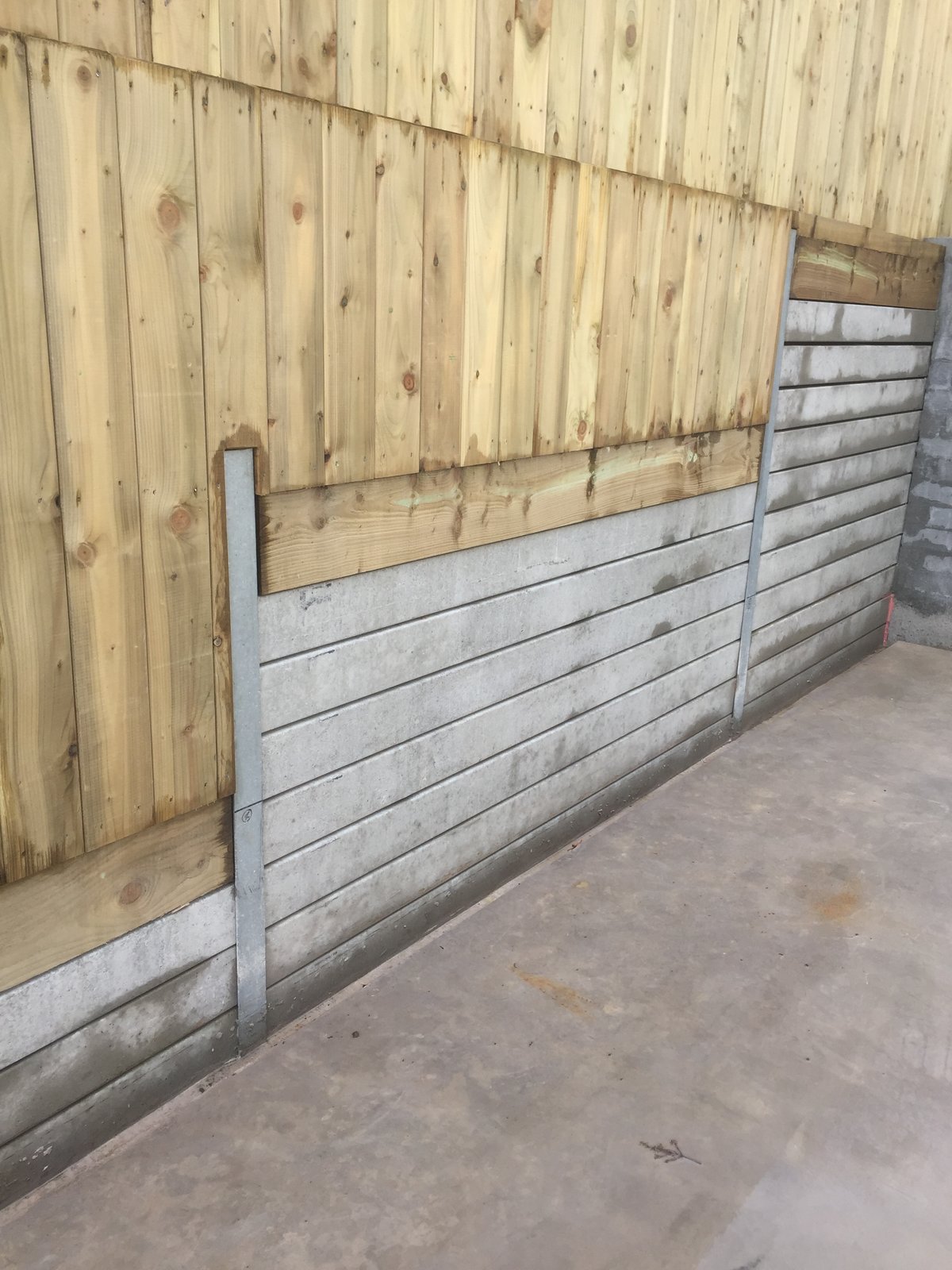

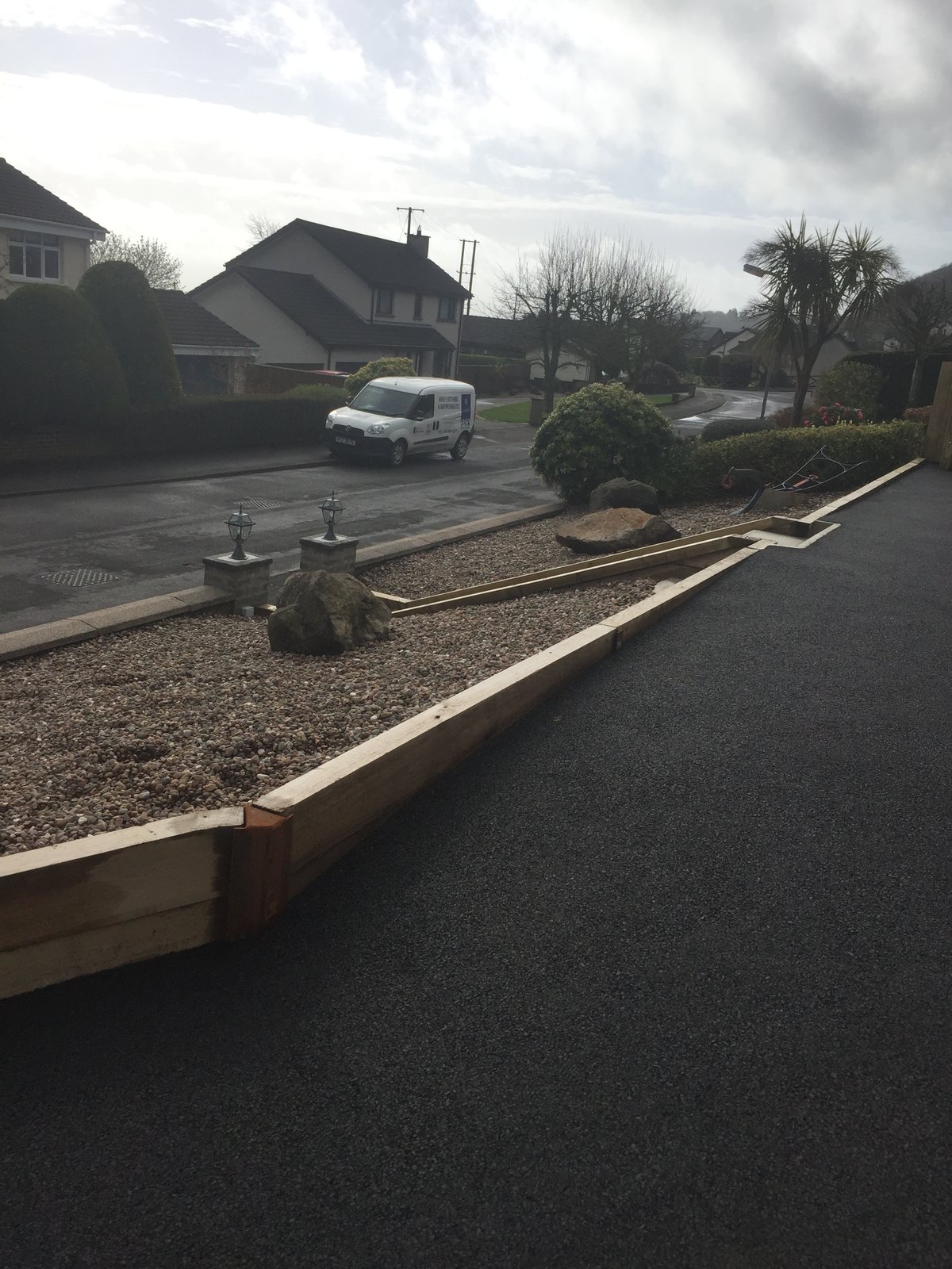

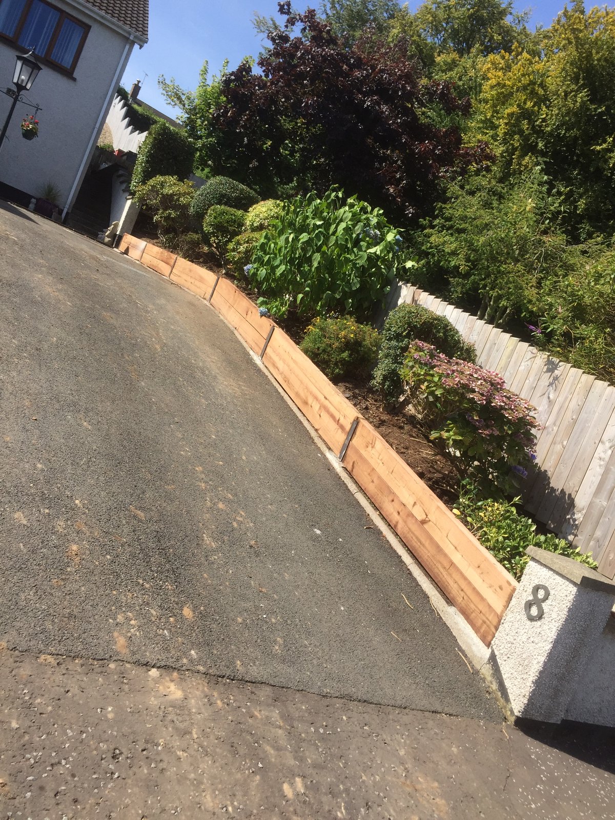

How many meters you got to do, £16 x 2, I used two bags of postcrete per hole and the 5” RSJ was £8 a meter so it was easier than building blocks, I also bought a set of scissor shovels and crowbar to dig the holes and keep things neat
There’s about 50 m ish in total to do, mostly two high but a small section that will be three high. I like the RSJ idea but ultimately it will be up to them
