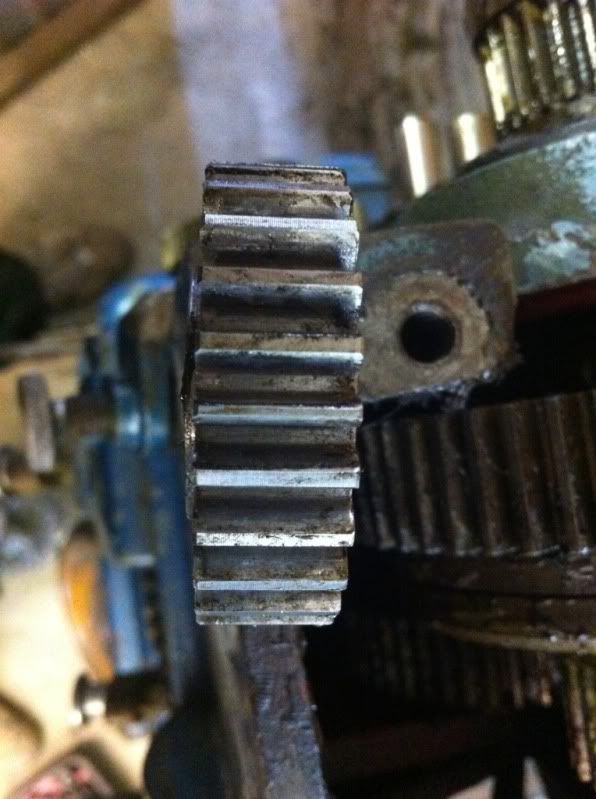

Today i was having the first tinker with my raglan lathe since i bought it a good while ago now!
i was having a fiddle with the various knobs an levers to work out what everything did.
during my tinkering i came across a bit of a problem. i noticed that there is a lever which engages/disengages the gear box. I has 3 positions forward/reverse /disengaged
i found when the lever was put in the revere position it was making a horrible clunking/banging noise, however when in either neutral or forward it was fine.
on closer inspection i think it was because of a poor replacement idler gear which wasn't meshing properly. I've taken a little video to highlight the problem
and also a pic which hopefully shows that the teeth seem to be of varying thicknesses
i'm pretty sure the gear is the problem
does anyone know anywhere apart from lathes.co.uk to get new gears from or anyone able to make one? Its has 26 teeth and i could get some more measurements if someone could knock one up
Cheers
