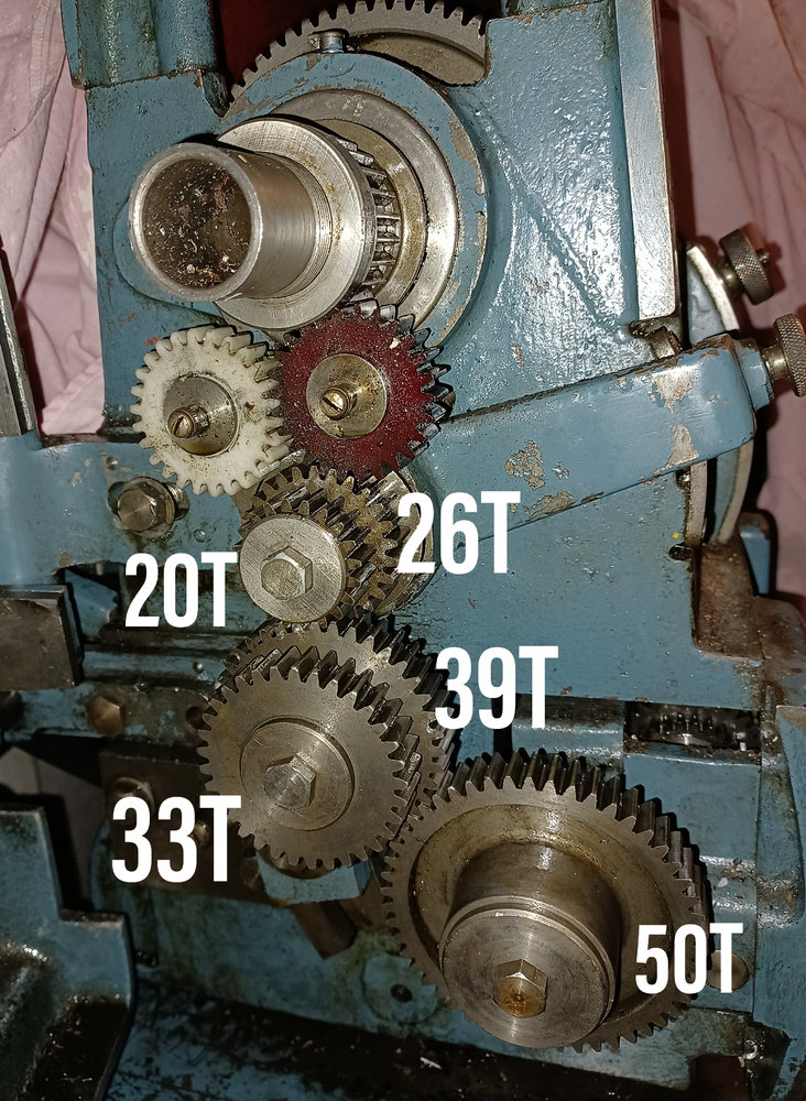

My new Raglan is set up for the fine (30 to 60 tpi) threads which is not convenient and therefore I need to source the 40T gear. I do have the 33T and 39T (see pic). Has anyone got a 40T and is it part of a fixed double with a 26T on the back like my 20T?
If anyone has a spare 40T I would gladly purchase it (14DP with 14 1/2 PA). Cheers
