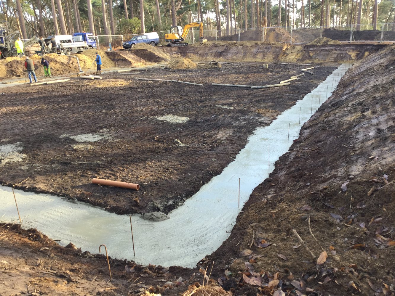

No, not sections. It is for the house extension on a sloping site. semi underground garage and retaining wall.Layers....do you mean sections?

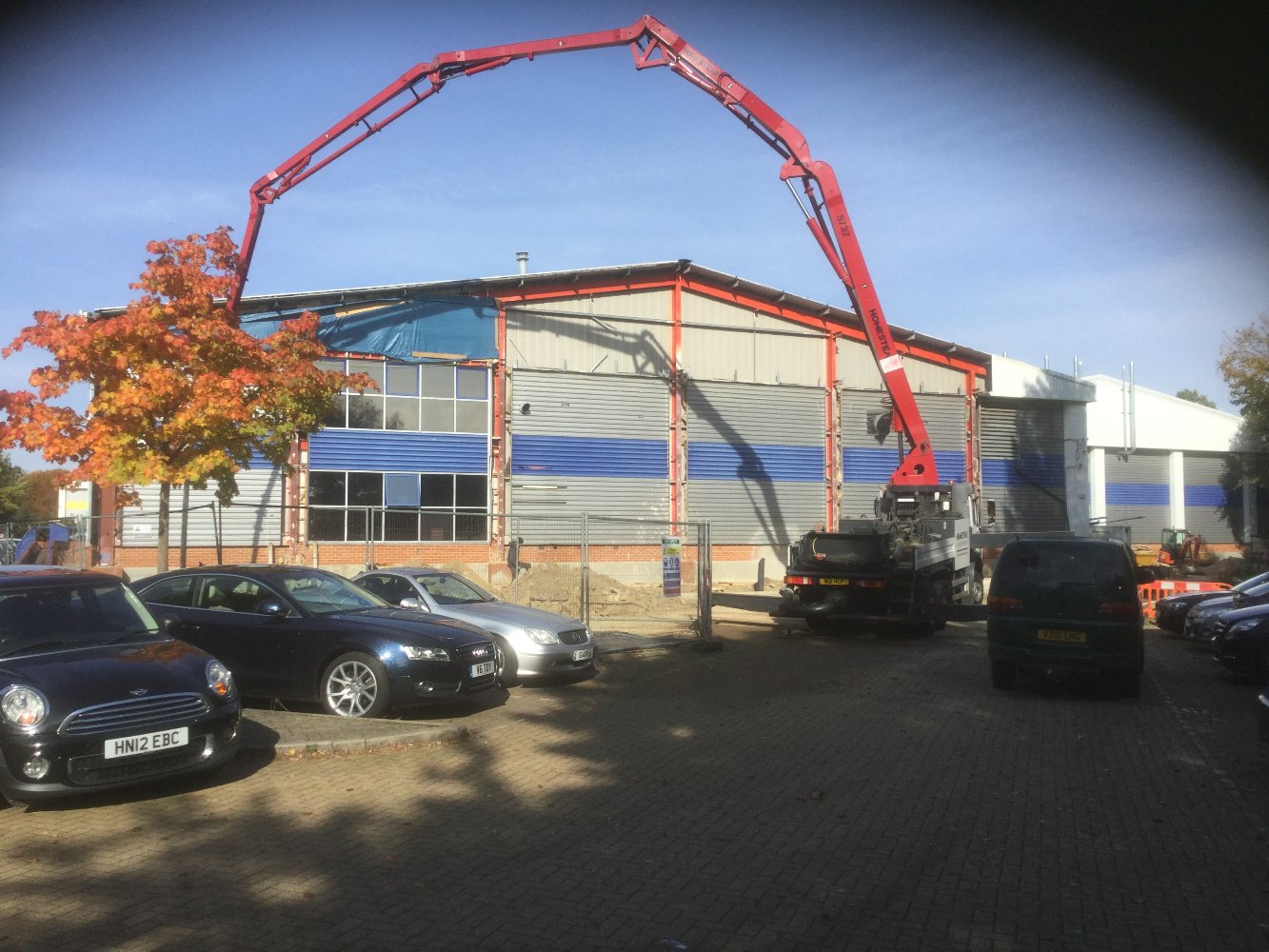

Bob what sort of distance can they pump when the pipes are laid on the ground ..80m ????Better in one. Concrete pump? they are a very cost effective way of transferring large amounts of concrete.

I know this would be the preferred option, and it will be needing to be pumped anyway, but this involves the lane being blocked for several hours, and will need at least three mixers worth.Better in one. Concrete pump? they are a very cost effective way of transferring large amounts of concrete.

They can pump that far I think. They ban also pump vertically. If you want much more than a cubic metre, is in not worth the hassle of wheelbarrowing it, even less mixing it yourself. Ready mix costs just over half what it would cost to buy the materials to mix yourself, with no effort. Its a no brainer.Bob what sort of distance can they pump when the pipes are laid on the ground ..80m ????

The excavation was done years ago and never finished. It was also overdug, so I need to raise the level somewhat. It is on pure chalk, so I thought maybe I could cast the understructure more or less on the surface of existing surface, then do some infill and then pour the slab over this.
Structural engineer has massively overspecified because of this, but am hoping for some input before I go to building control with it.
What a lovely easy site. If only ........Yes, no problem pumping 50mts + even with a small rig. They are cheaper to use than labour and dumpers.
