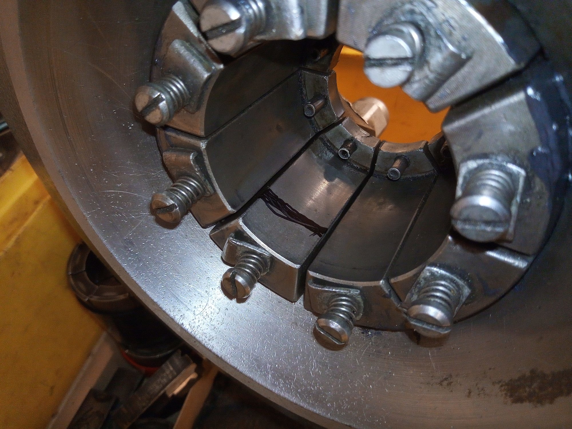

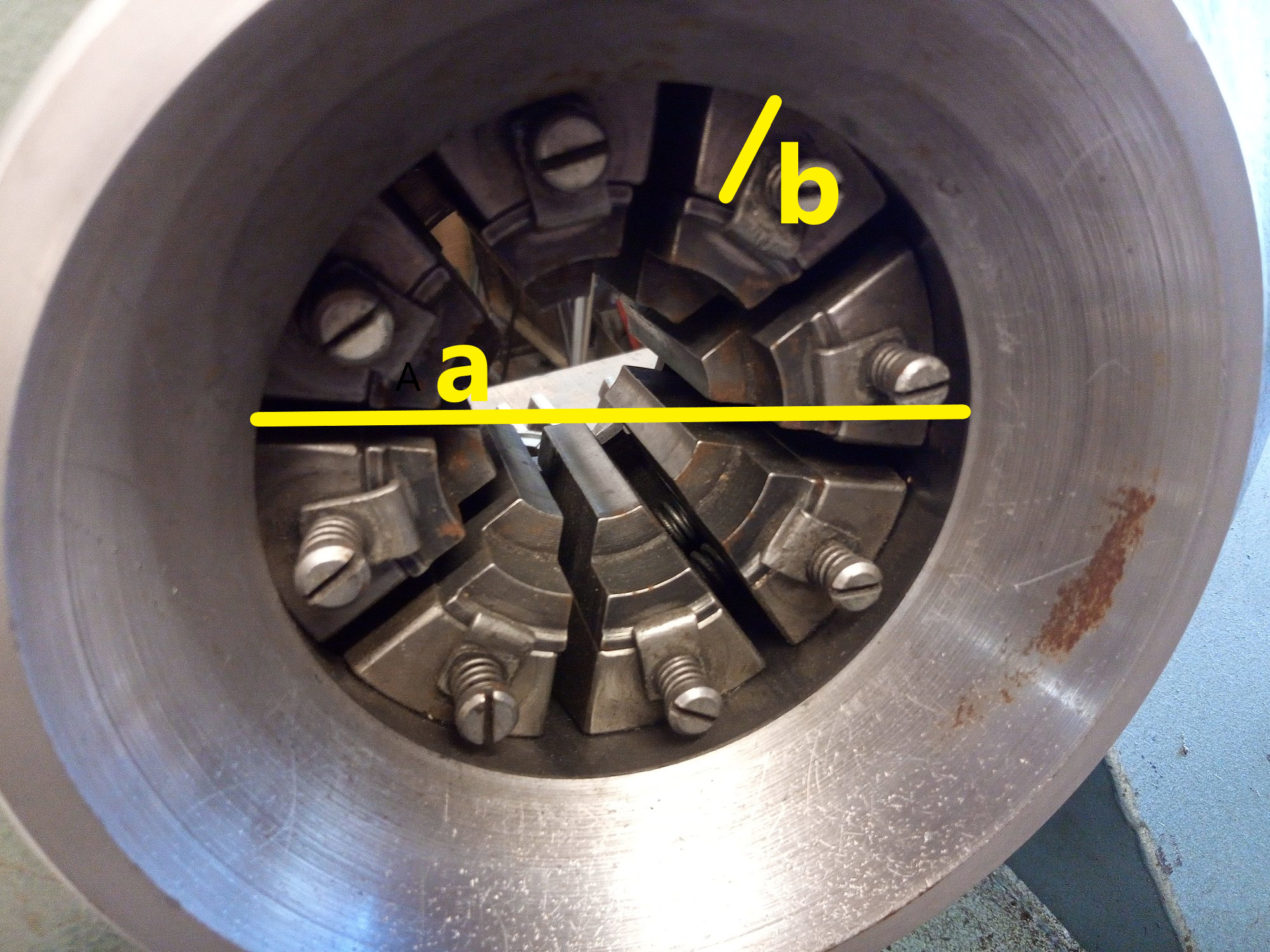

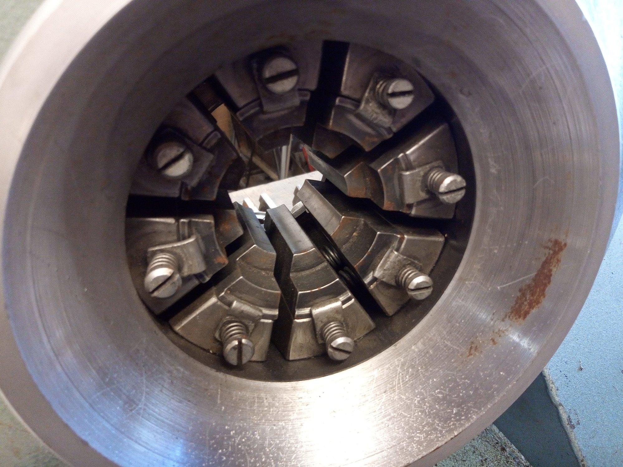

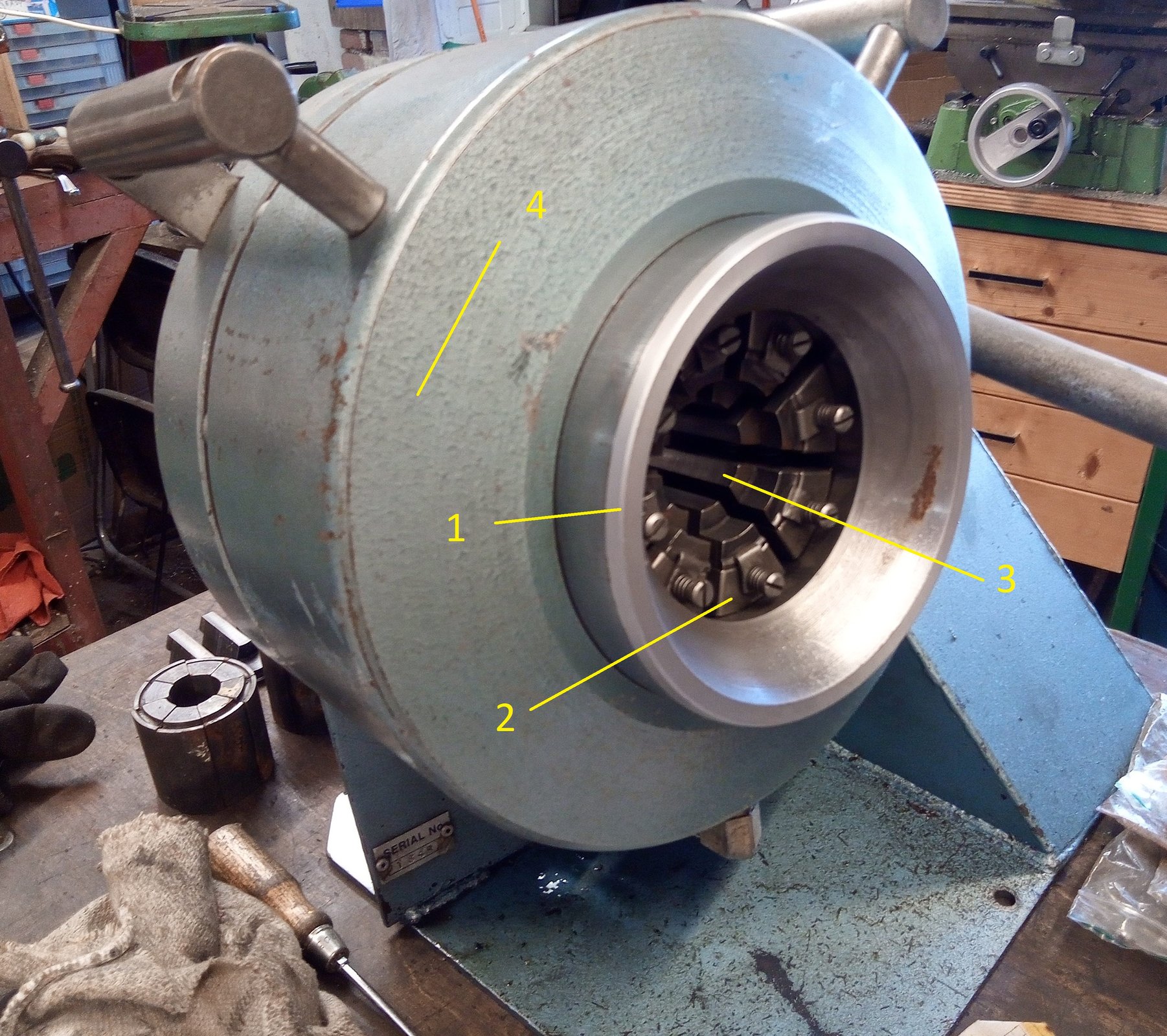

How do they work? Take the diameter a of the outer they are held in and deduct twice the height of one segment b .View attachment 250609
You can't do that. The 'diameter' is a cone that the jaws pull in to. You don't know what part of the cone the jaws were held at when the inside radius was machined.
