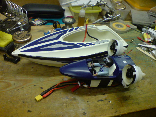

so that's two project boats to make and I thought I'd better get on with another project which was to fit a couple of ducted fans to the hull of a 1/72 scale Vosper Motor Torpedo boat.
so I got the completed hull bottom and ducted fans and thought about how to fit them to turn it into an airboat, at the same time I had one of the Playmobil boats to hand and thought that the ducted fans on on the back of that would look pretty silly (and the hull shape may be better for playing with on a lake). so that became a third Playmobil boat to convert to radio control, and this is the first one that Ive been working on.

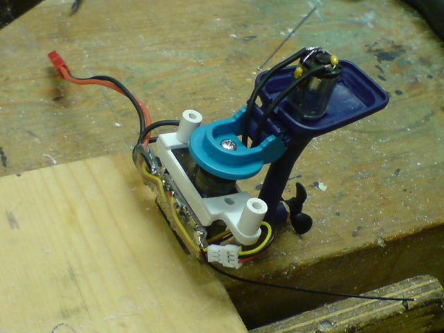

With the radio control side of things, I run single LIPO or Li-Ion batteries so all my models work off a nominal 3.7V and used brushed motors. so a fir while ago I go a paid of 30mm ducted fans off ebay.
and between them they have 90 grams of thrust. the motors on them are 20mm long, 8.5mm diameter and draw 6 amps on fully charged batteries.
the speed controllers Im using are designed for powering motors that draw up to 1 amp and are reversible

but by sticking a mosfet on them, can be converted to 20 amp forward only

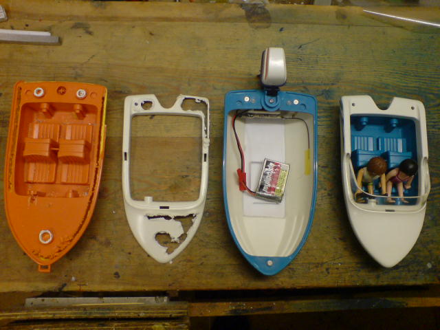

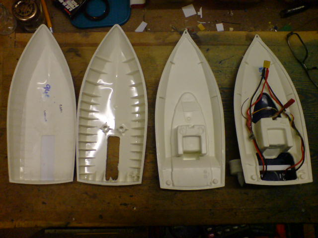

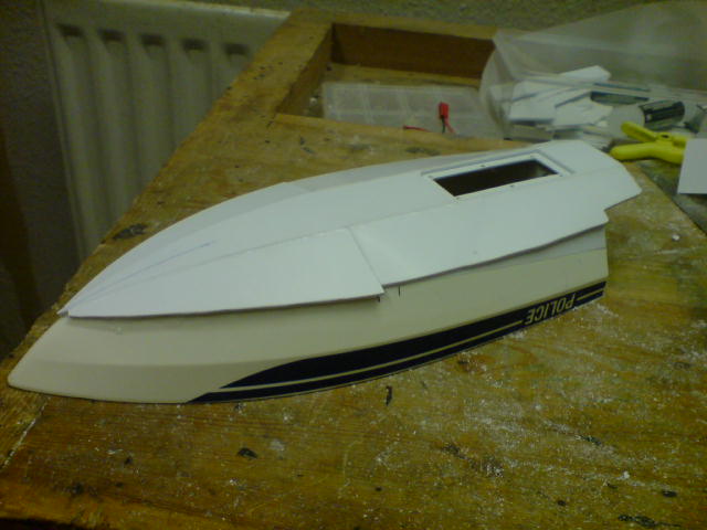

as these are children's toys they arn't supposed to be taken apart. the top is stuck to the bottom, so to separate the top of the hull from the bottom I had to run a knife along the join, then cut a section out of the hull ( this was going to happen anyway) as there are a couple places where the top is stuck to the bottom and this needed to be attacked with a chisel
and a standard hull on the left compared to one that has a bit of extra plastic removed (and radio control gear fitted)
the blue part on the top of the boat is impossible to remove without attacking the top with a dremel to remove the double skinned section and this clips into place, so originally I was going to attack the top of the hull to the bottom with rare earth magnets, but now I can glue them back together and have the top section clip into place as the ducted fans and radio gear would be stuck to it (I would still need access to the battery).

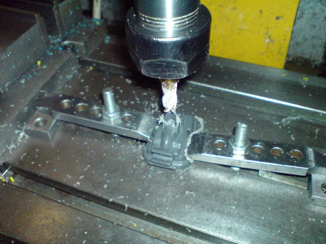

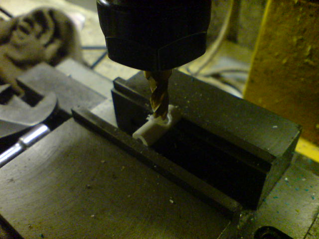

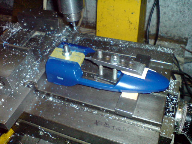

I needed to mill some slots in this section to temporarily fit the ducted fans to have a first test ( I know I shouldn't be using a milling cutter in drill chuck, but I do sometimes for very light work).

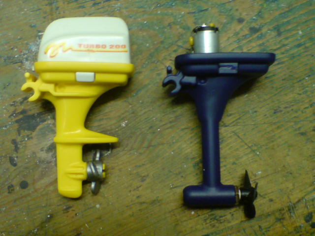

so that was the police boat at the back, and while looking for that I got distracted by the little speedboats with the outboard motor, and thought that would be another little project to make a tiny working outboard motor. Ive now got a few of these to play with as they can be be had for £4 to £8 inc postage on ebay.

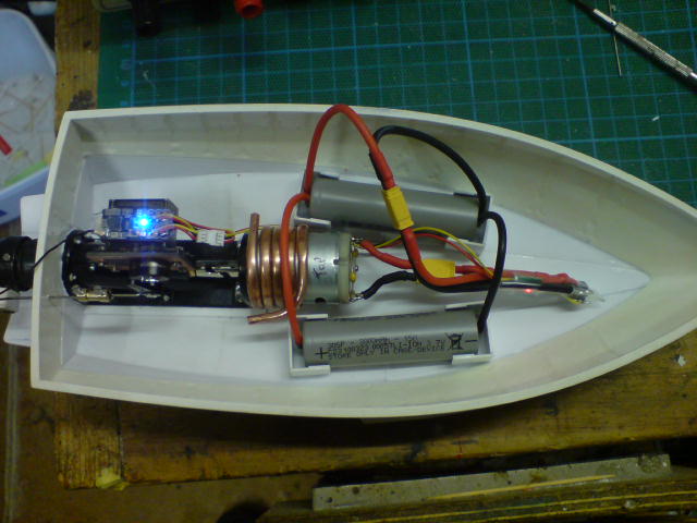

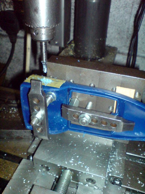

so that was ready to have a test play on a lake, and it went well enough, (and didnt sink). the wires to the ducted fans do get warm, not surprising really when they are drawing 6 amps and only 0.7mm diameter (including insulation)
