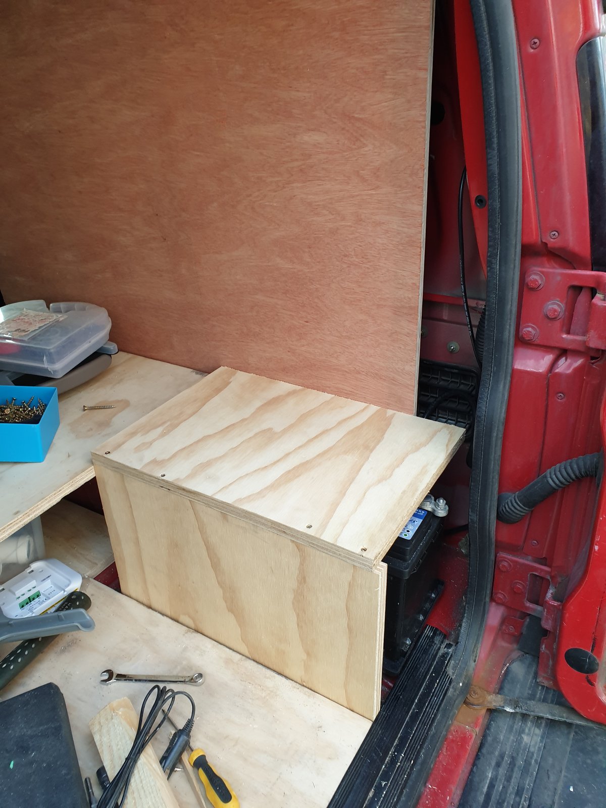

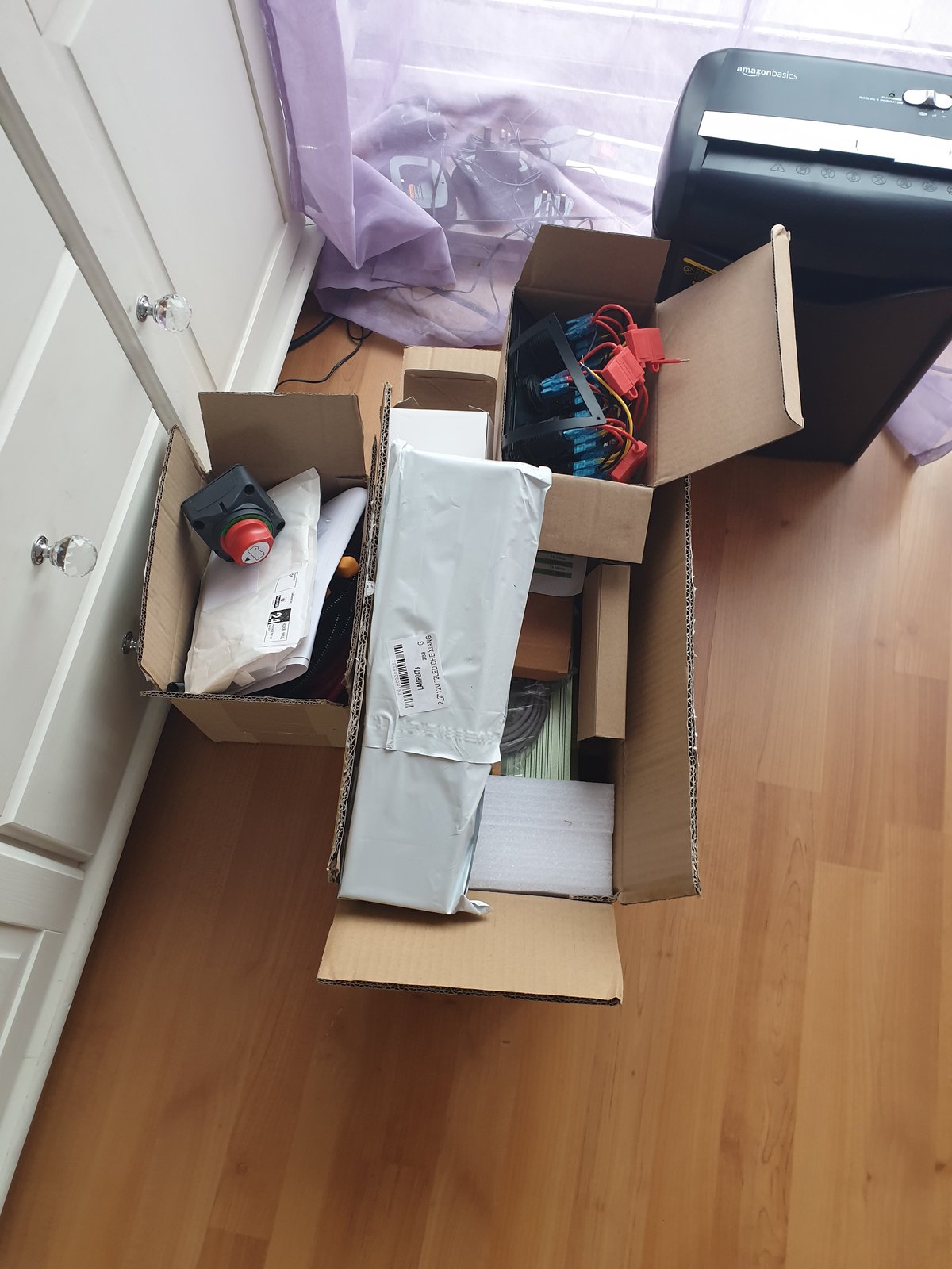

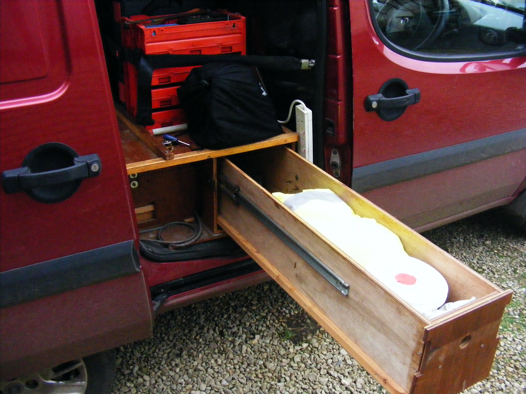

Assume your going to run a leisure battery and split charger in it.Big pile of electrical and electronic stuff arrived over the week, few bits missing but should have them by next weekend

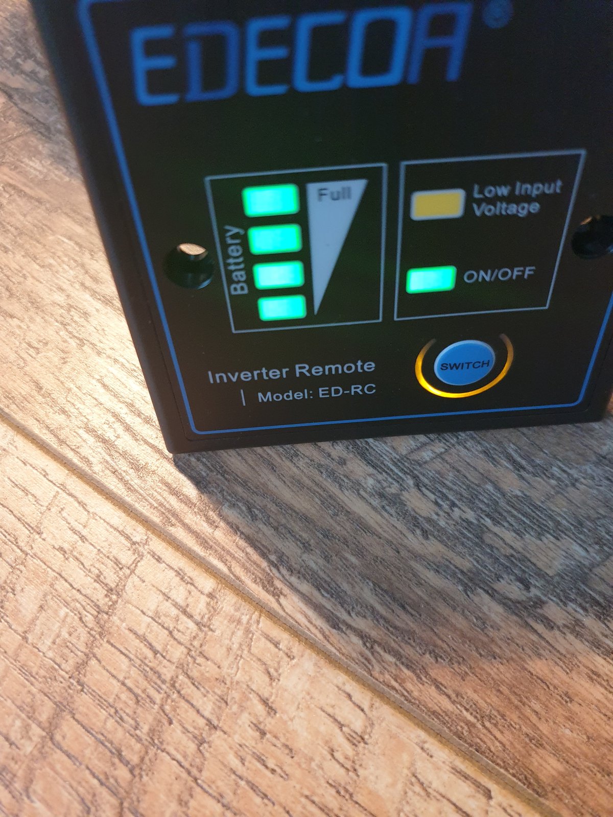

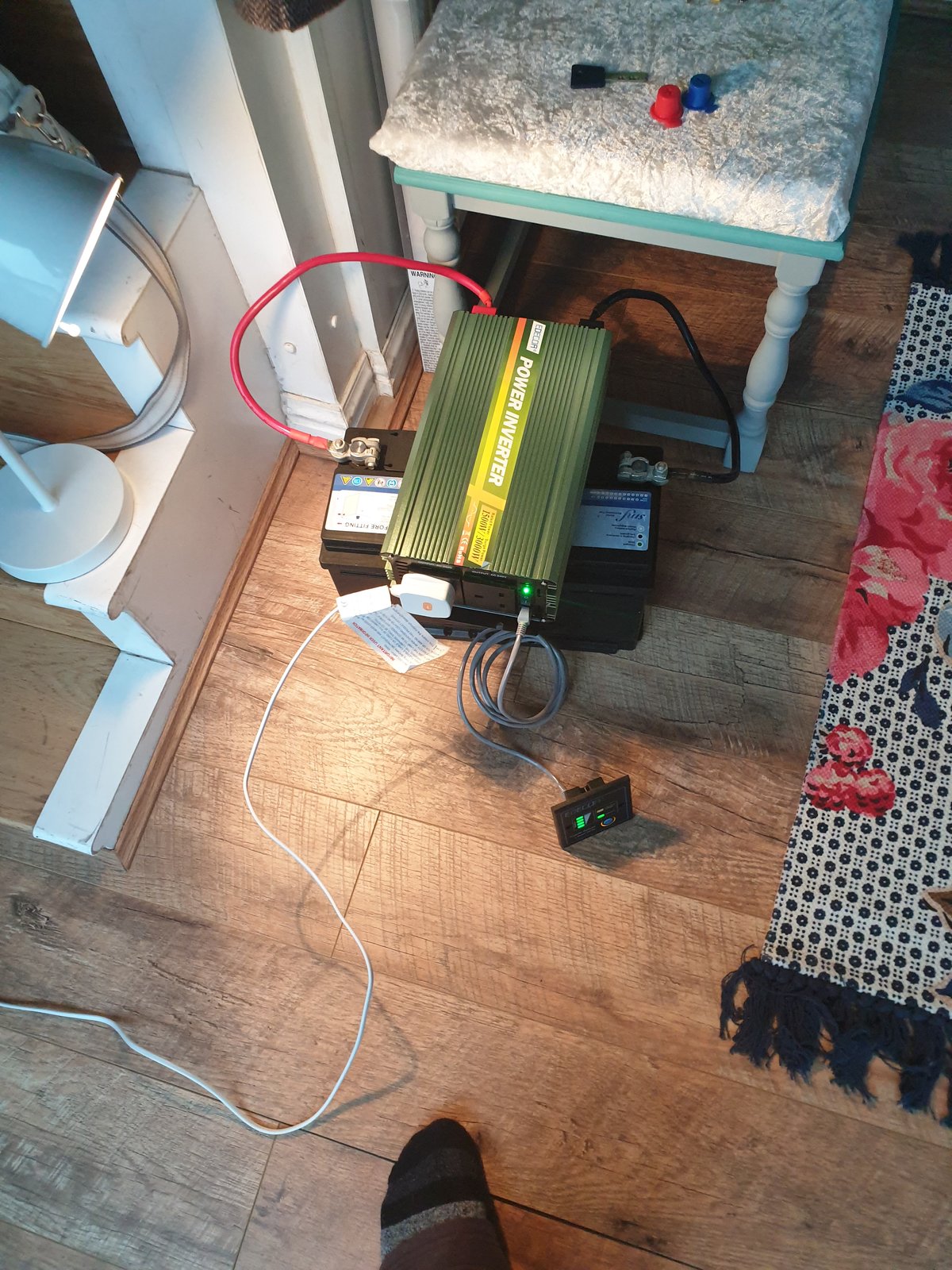

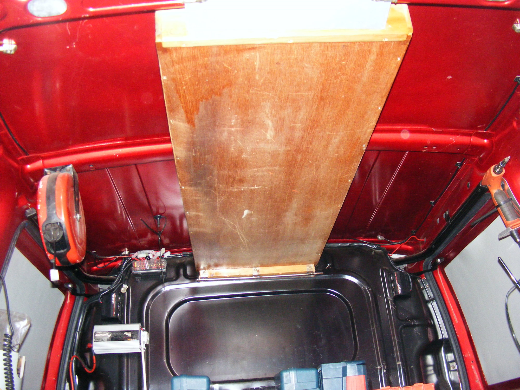

Quick test of the inverter, seems I don't need the remote panel but it may be useful in the cab, not decided yet
View attachment 170453 View attachment 170454
Not the most taxing load but it's a 240v, 40w bulb running from a 12v battery

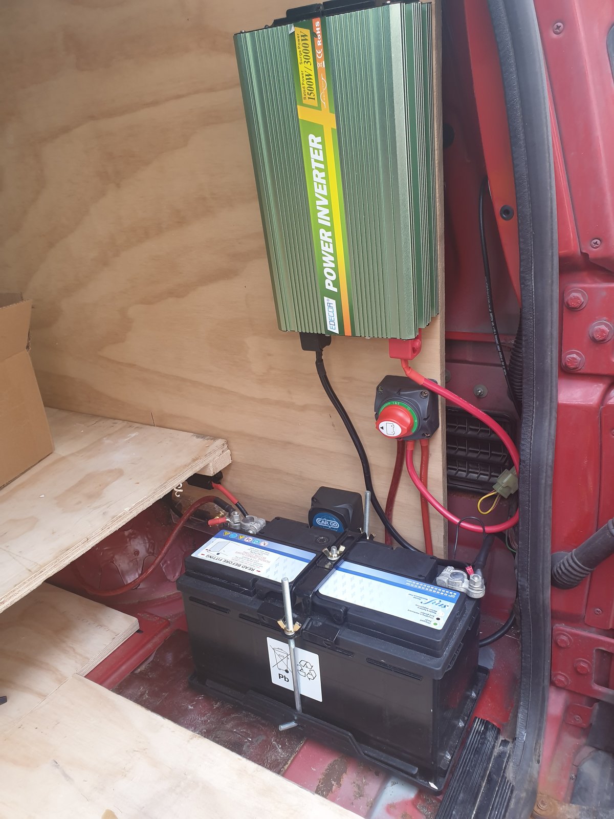

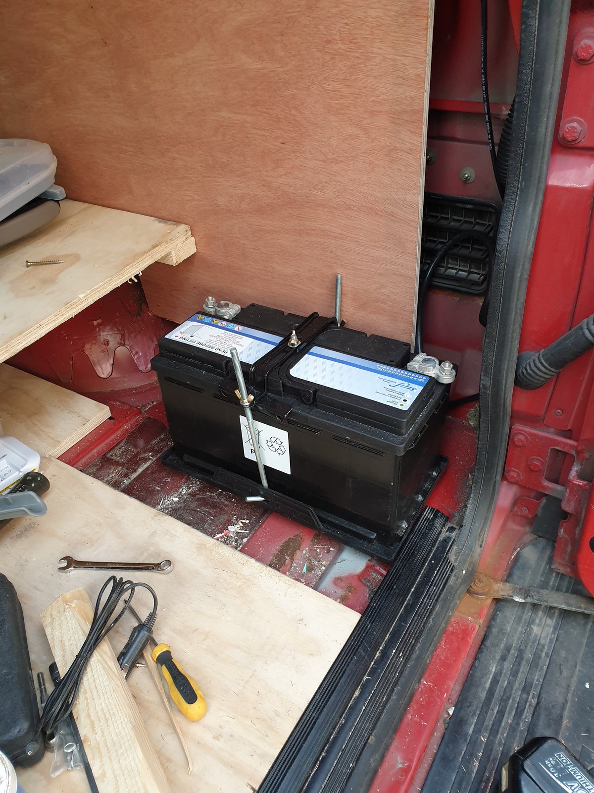

Not considered shoving a caravan dist board in. Plug into the mains when on site/home to trickle charge the battery and power your chargers natively.That's a 110ah leisure battery, biggest I could fit in the style of tray I want. Will have a split charge but also a 3 way isolator and 25mm cable so I can link the main battery if needed
Did that on my old van. Plug it in and roll out the 110v leads. Was part camper so the hook up made sense at the time.
