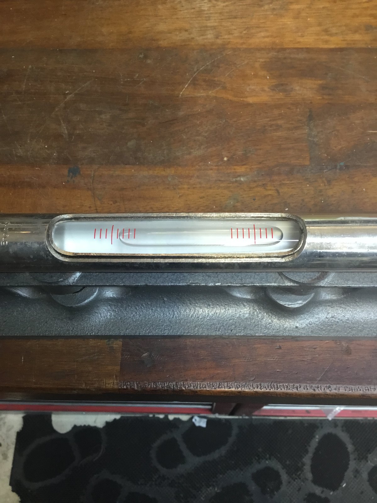

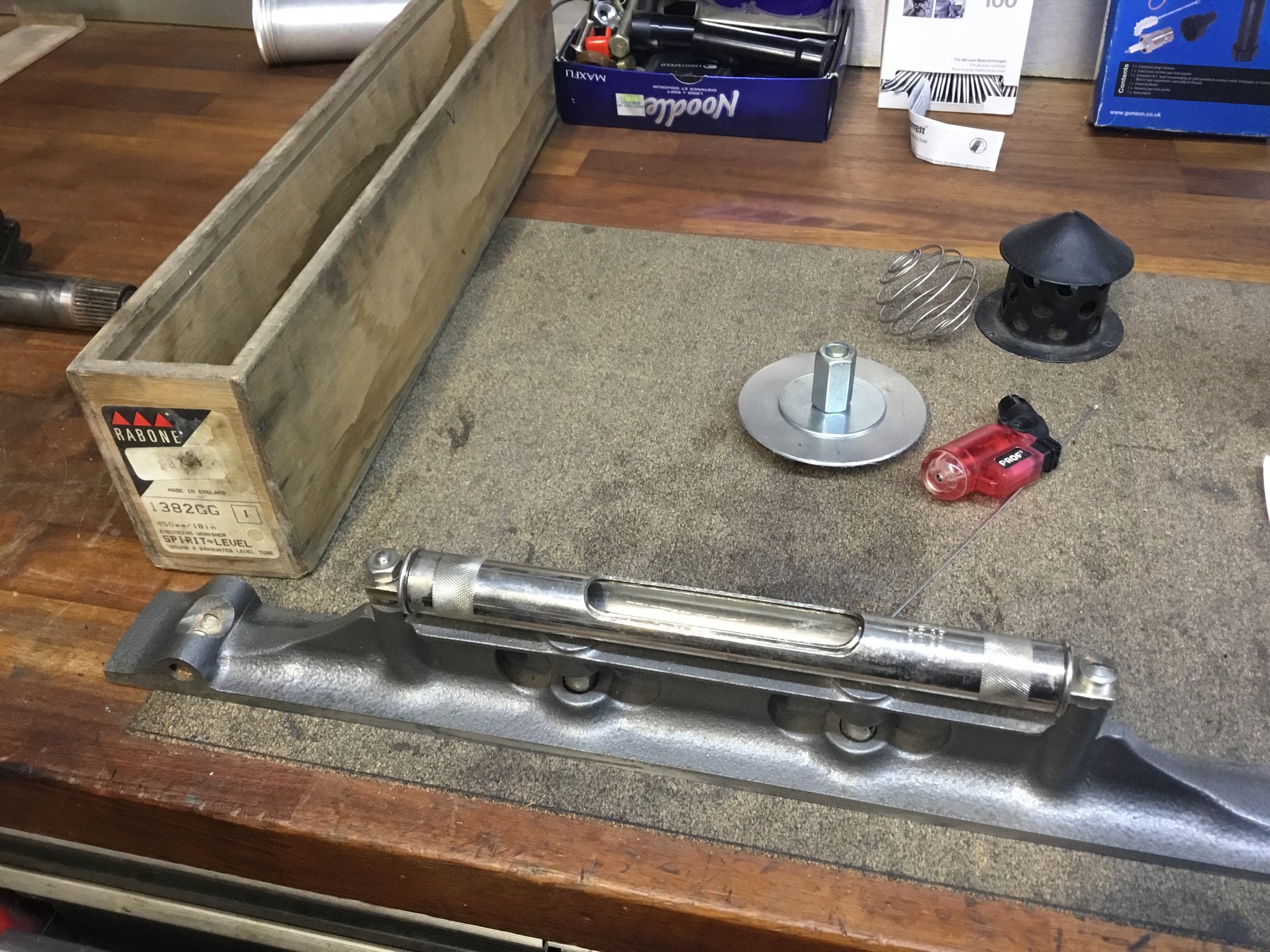

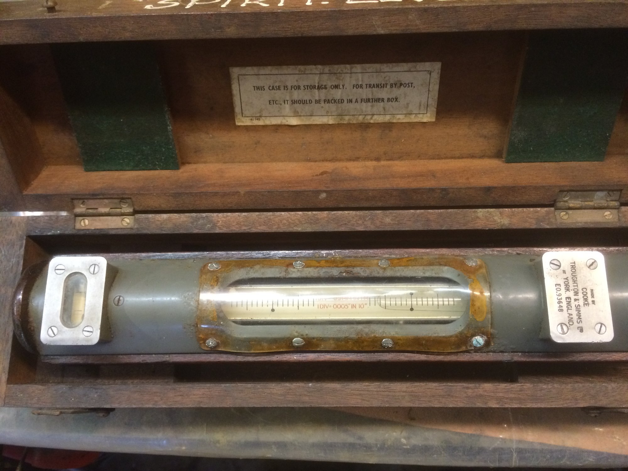

I have a Rabone 18" Spirt level (1382GG)
At some point in it’s life the vial has been removed, broken? Possibly dropped? I dont know.
I’ve found a company for a replacement vial, should be here nextweek.
https://www.leveldevelopments.com/p...6101-ground-vial-15x95mm-sensitivity-0-02mmm/
Apparently you fixed the vial in with plaster of paris
Do now.
