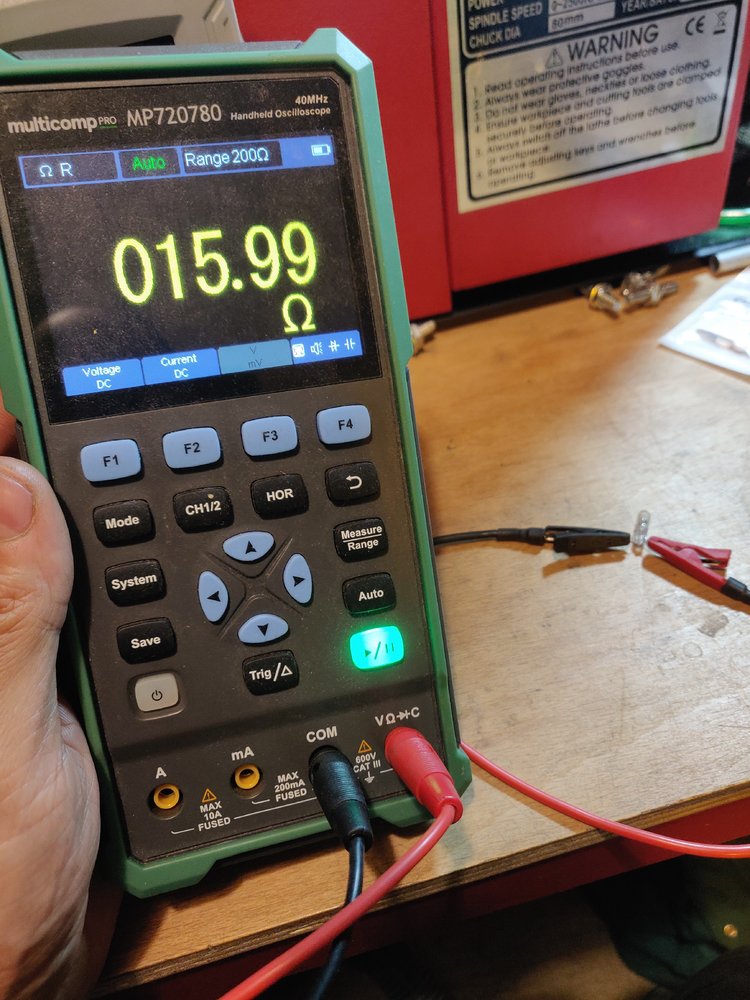

Then I remembered I have some spare dashboard lights so I put a multimeter to one. I get 13 Ohms. Totally different result.

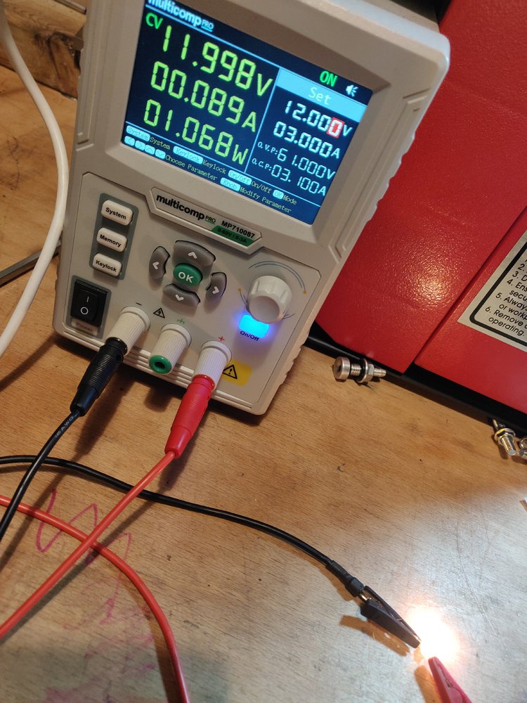

Confused, I connect the bulb to a power supply. The power supply shows the bulb is 1.1 watts and is drawing 0.089 Amps which according to V=IR gives R = 135 Ohms.
So the multimeter is giving a different result to the power supply and my calculations (the latter two agree with each other).
