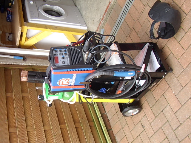

Machine sitting on its cart with consumables and argon botlte

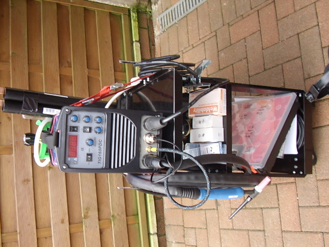

Front shot of machine
Another side view showing my rod holder it consists of 4 950mm lenths of 40mm plastic tube

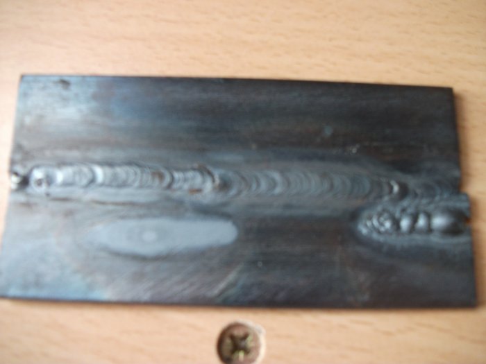

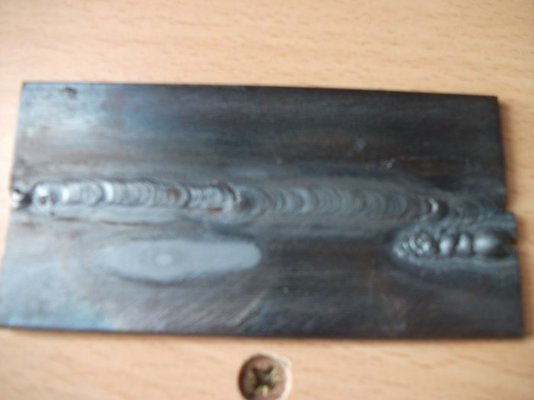

First attempt 3.0mm mild steel flat bar welded at 85A using 1.6mm gold tip tungsten and 1.6mm filler wire

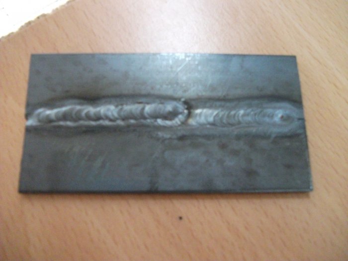

Another peices welded, was playing about with the settings on this one

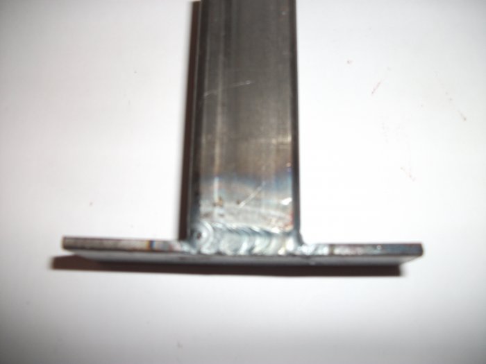

Welding a peice of 25x25x2 mm box section to a peice of 3x25 flat bar, using 80A
