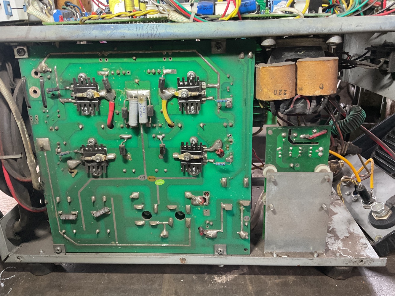

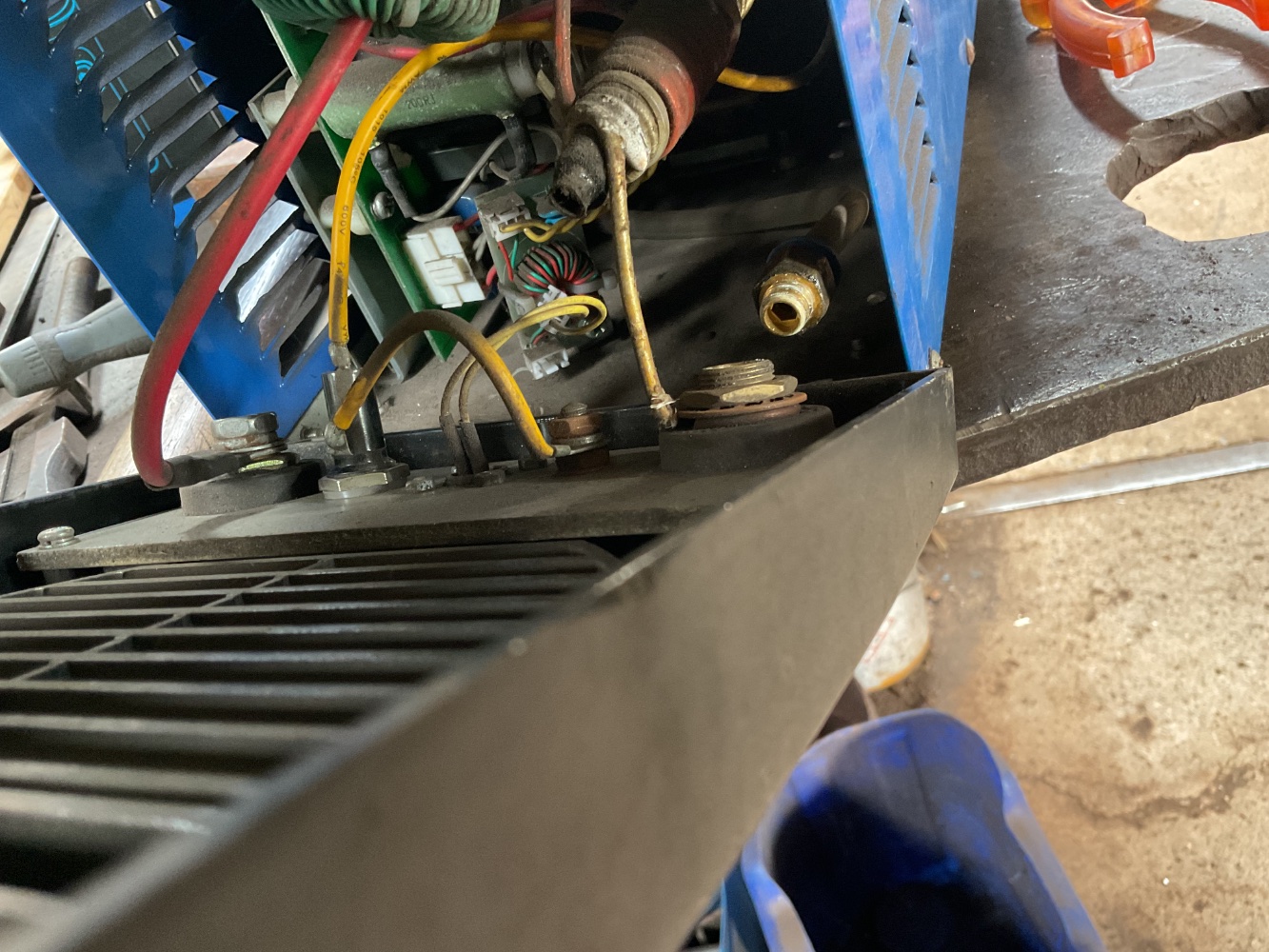

Did you connect the earth up? I’ve made that mistake more than once…Forth time in 14 years,doesn’t get used a lot,air is hissing when you press the trigger but no blue jet out of the nozzle,if I send it back for repairs,it’ll be at least £80+ vat. Can it be anything fixable by me,simple?

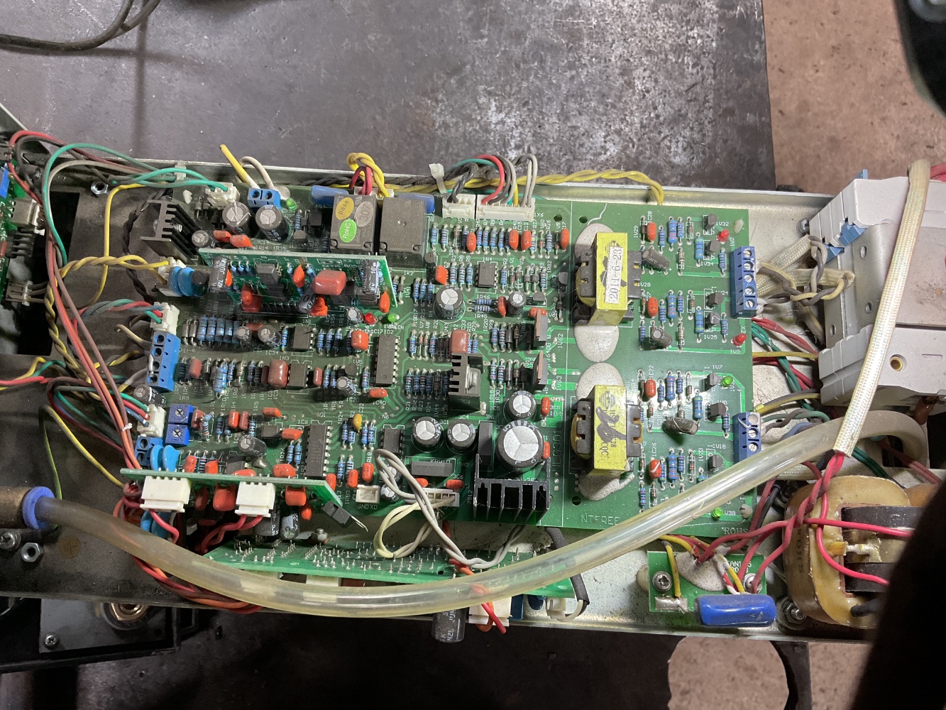

Look at any accessable PCB's for signs of burnt components

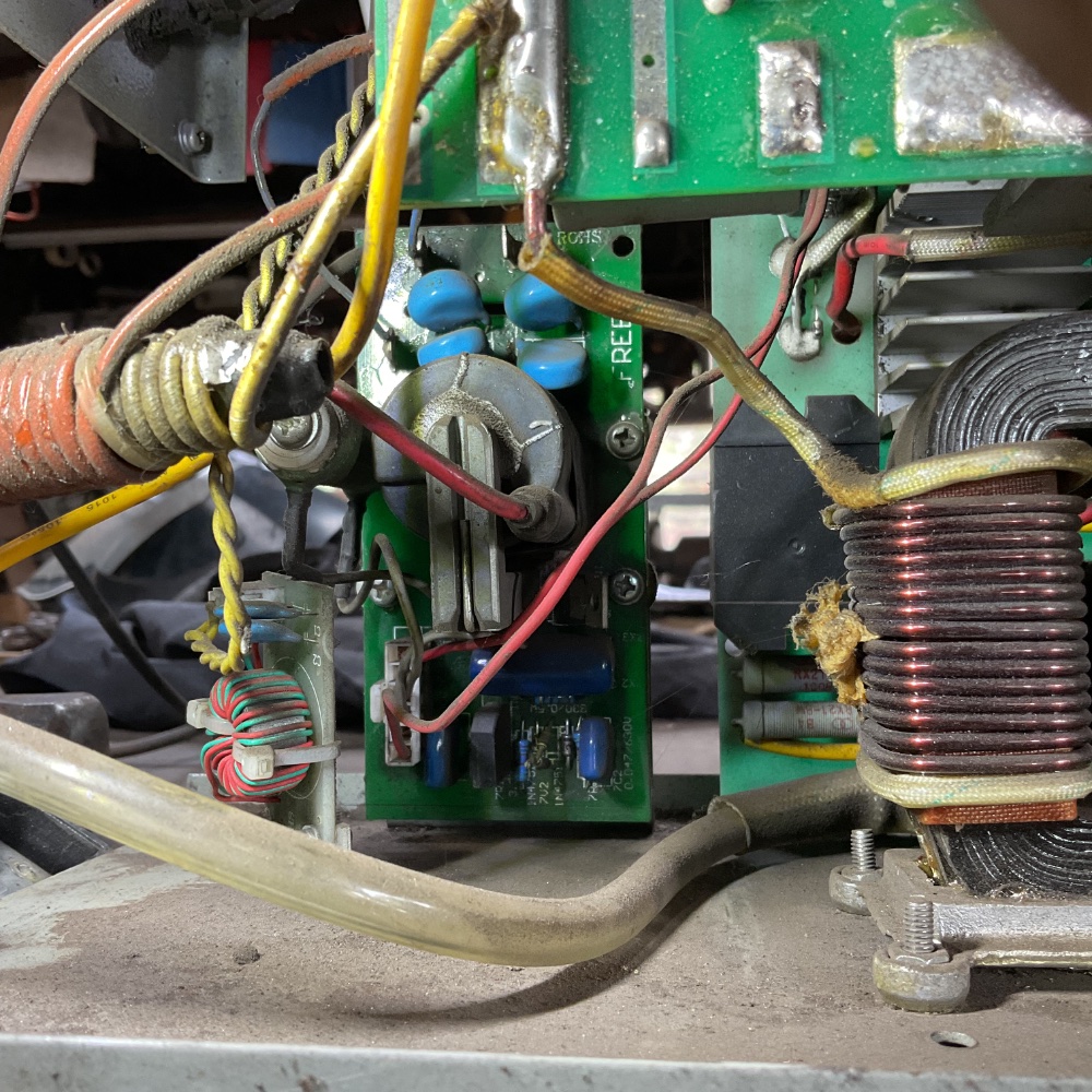

They STILL use spark gapsGive them a call. I had my P50HF being a sod to use and gave them a call to see what the cost would be to look at it.
Technical chap phoned me back and guided me through some diagnosis and then said if its this try this (adjusting spark gap on the hf board) that did the trick. No charge at all just genuinely helpful and wanted to help, if that hadn't worked they'd have happily taken it in to look at (obviously charging).
Is it the slim black sausage shape,horizontal?Top left of the last picture, looks like a resistor off the the regulator has popped? Maybe it’s just the angle.. Don’t shoot me, I know nothing!
Good luck, though,
Bernie
That's quite typical of high voltage PCB design, as to ensure good insulation gaps while getting all the required components on the board, you sometimes have to do things that are less than ideal from an installation point.I dont like the quality of this pcb!! Through hole components should be through holes in the pcb and not "green wired" to solder pads on the back of other components. On a product thats likely to get hot, the components weight and vibration can make solder joints fail, parts fall off etc..

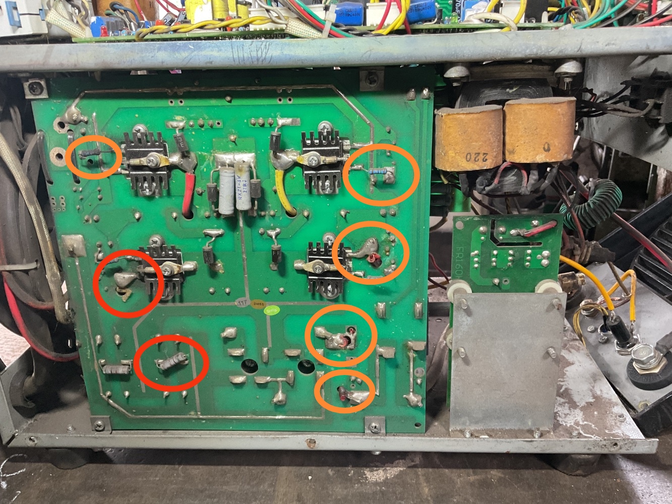

Check the orange circles.
The top red cicle looks like it could be a bad solder joint and burnt wire through the hole.
The lower red cicle looks like the right end has snapped and came free from the board.
Id say the previous repairs and manufacture were not up to standard!
