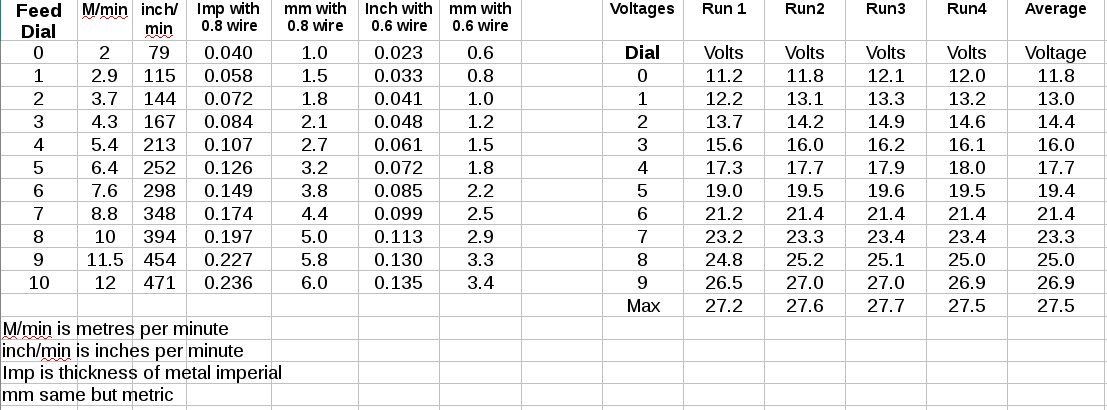

Hi Guys,
Well I took the dive and purchased a R-Tech 180 Inverter Mig.
Just need to sort gas out now.
Knowing R-Tech don't give any idea of settings for material etc, I wondered if any of you guys had any ideas of base settings I could start off at, then dial in as I go etc.
Looking to weld:
2mm box section
3mm plate
Cheers!
