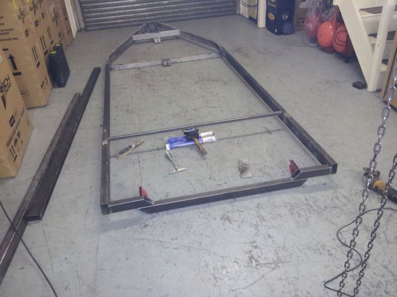

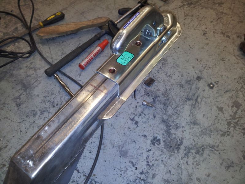

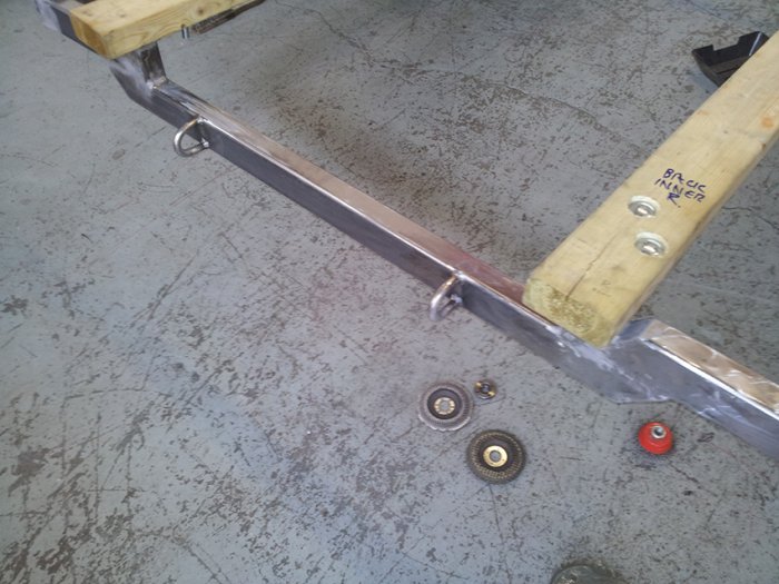

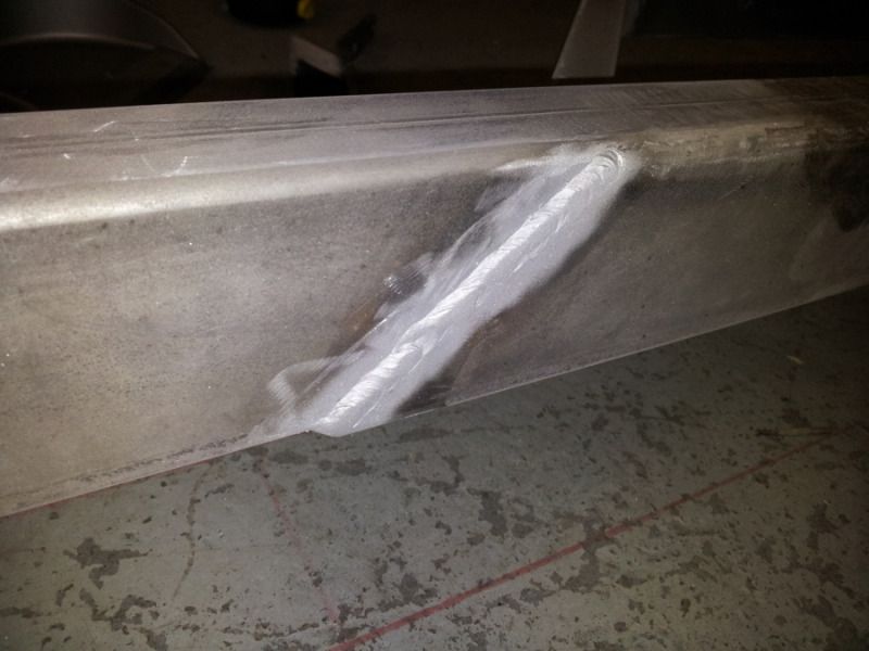

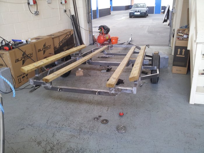

Hi all

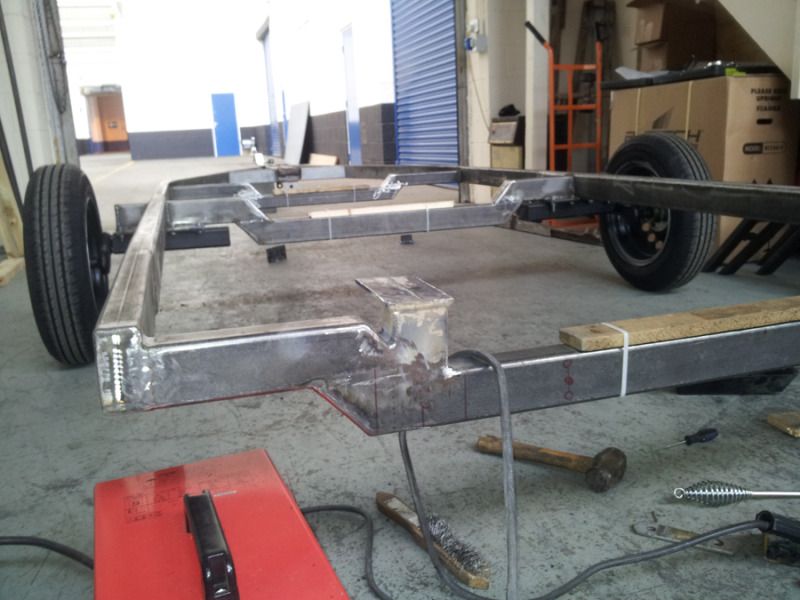

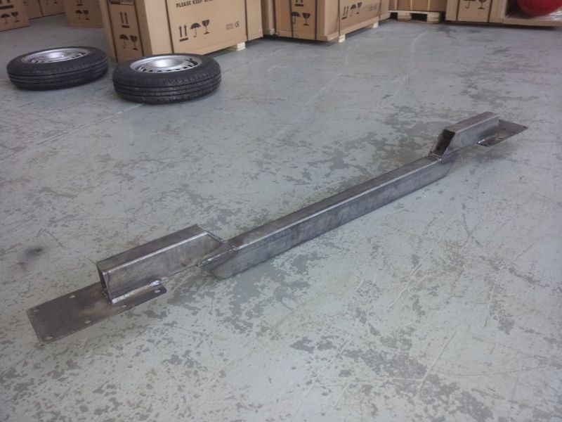

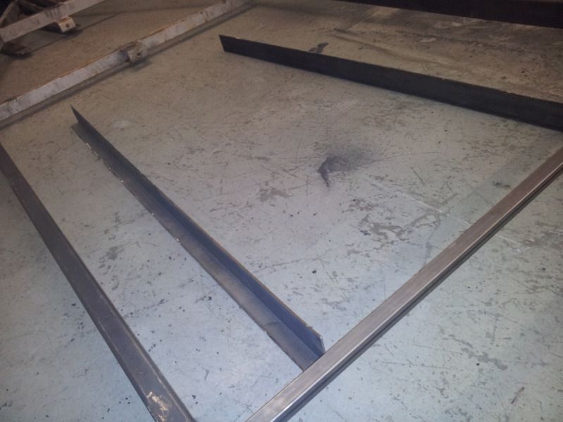

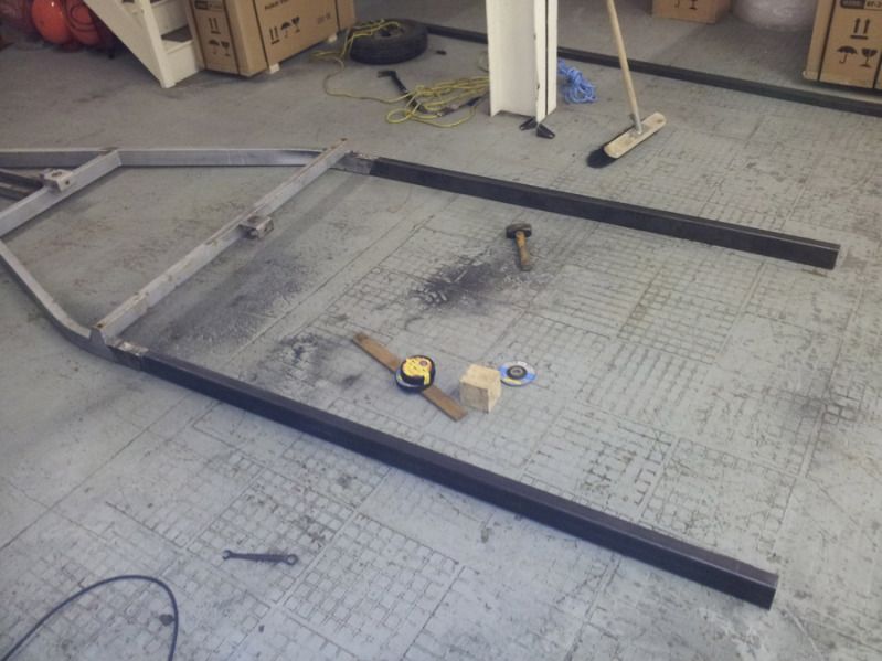

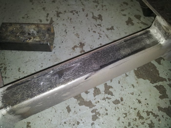

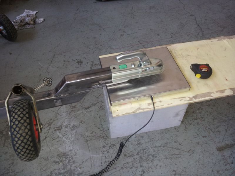

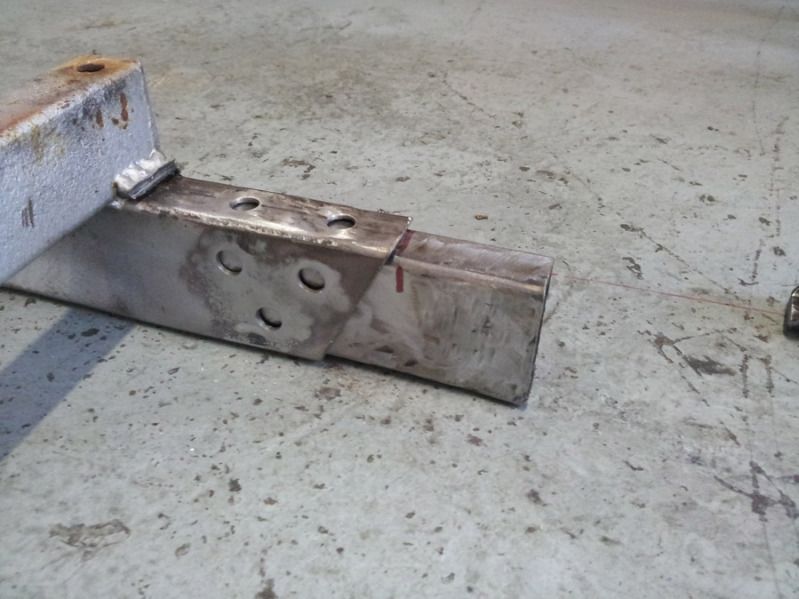

I've been welding up a boat trailer for a couple months part time, and I'm about ready to start painting. However I am looking for the quickest, least time consuming method of stripping the oxide coating (see pic 3) off the steel and some paint in areas... I have been using flat sanding discs on a 115mm grinder, but find they clog quickly when it gets to the parts of the steel tubes with heavy black oxide, and also I have to keep angling the grinder... seems that perhaps I might be using the wrong attachement?
I've tried a wire brush on the grinder (not the twisted type though), are the twisted any better? The normal wire brush is useless.
I've sandblasted in the difficult areas and at all the welds, so its just really the flat long sections - my sandblasting rig is just not up to the whole job, nevermind finding a place to do it....
Please can someone suggest a good method... the prep of this is very important as I will be painting in cold zinc paint, and then 2k, as the trailer will be dipped in salt water.
