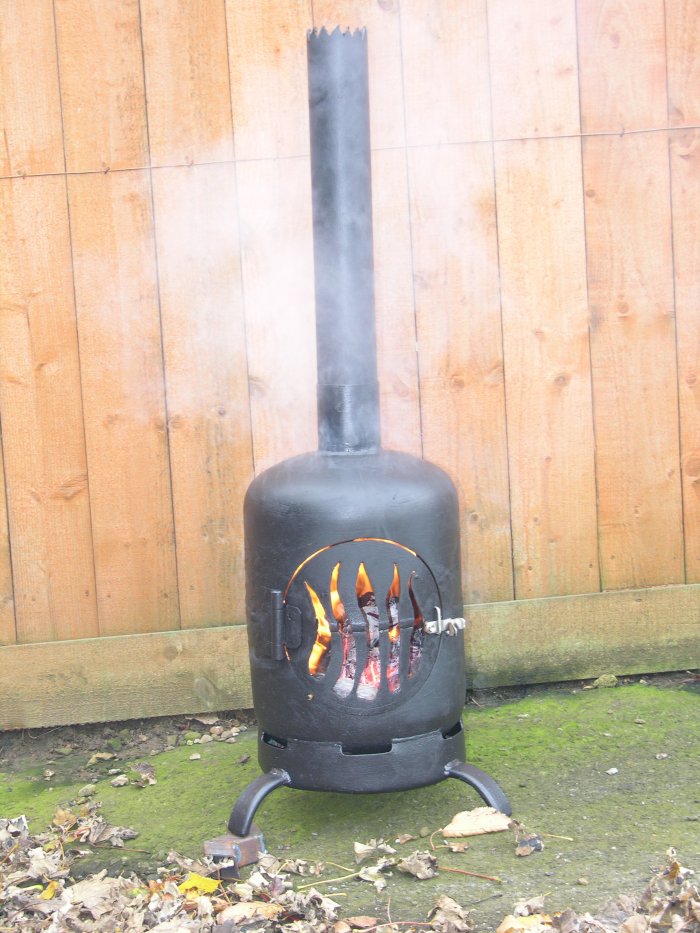

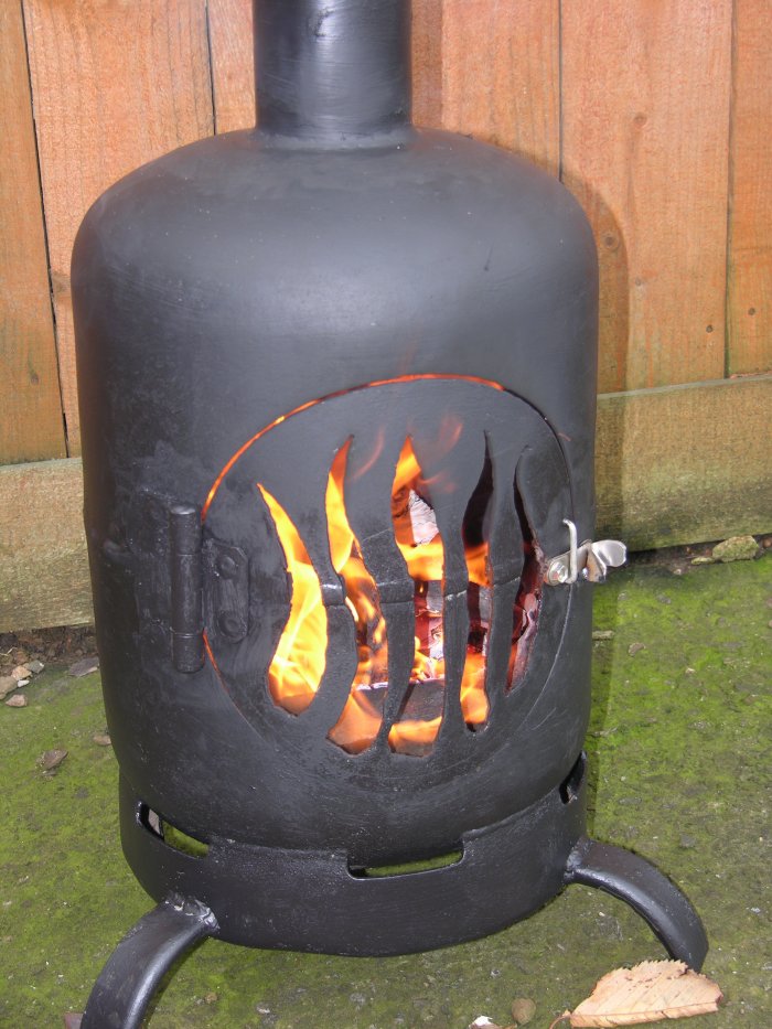

Just knocked this up yesterday,Done in a hurry but still looks and performs OK.
Plasma cut door and flame shapes,Did not bother with any air vents or grate ,as it is intended for wood only.Cut down a T hinge,Drilled it 12mm and plug welded to look like rivets.Hand formed short tube and welded it to the top so the flue is detachable.Don't take any notice of the smoke in the first picture,it's just the high temp paint solvent burning off,I think the cut-outs in the door are quite nice when the flames are dancing about.
