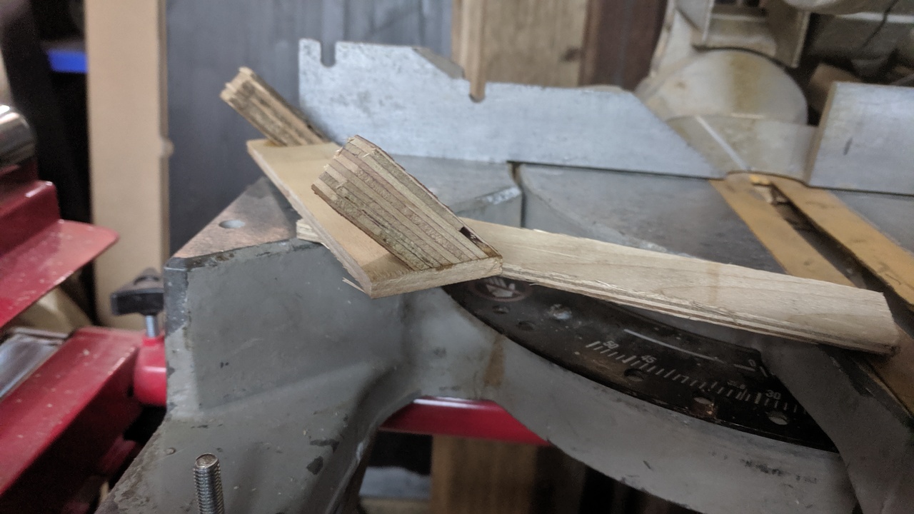

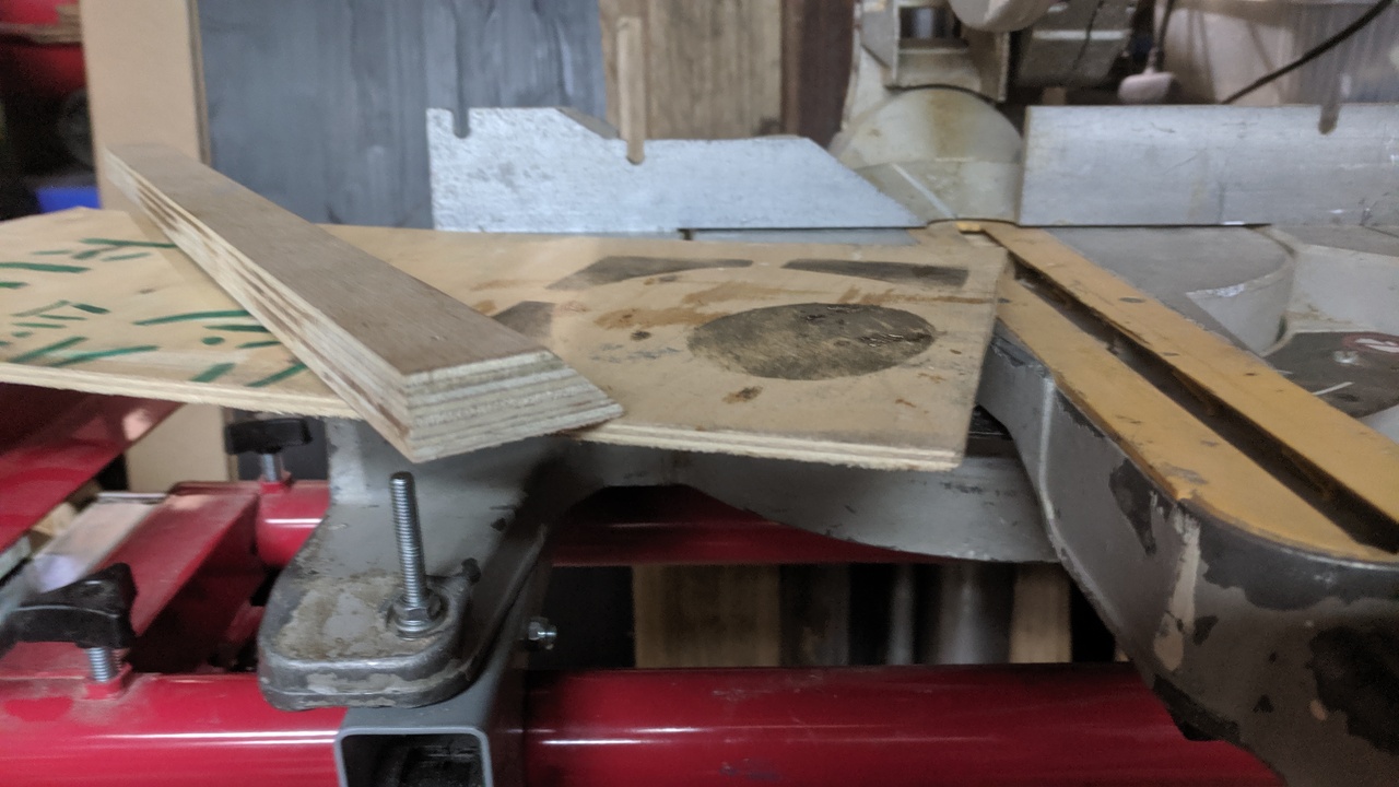

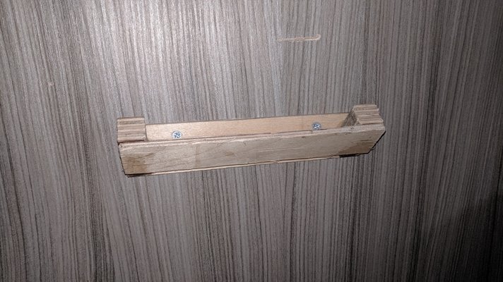

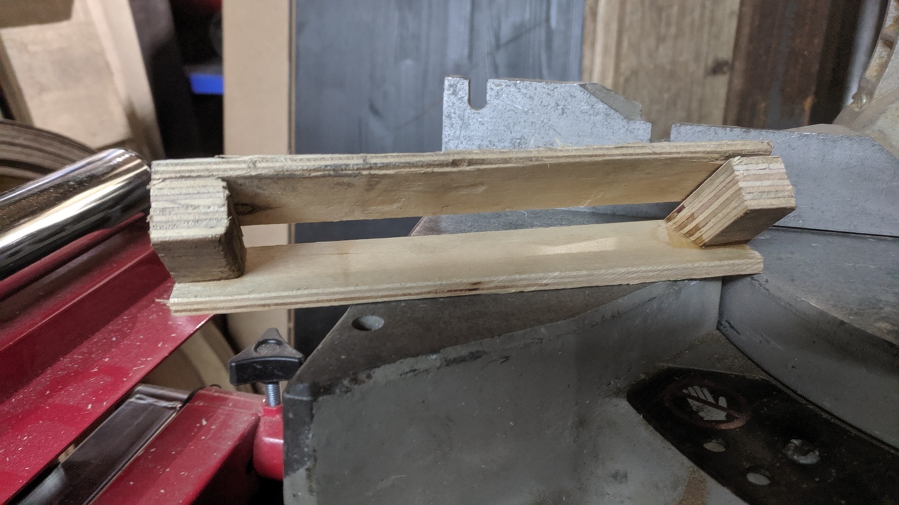

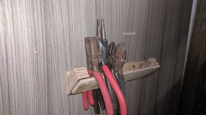

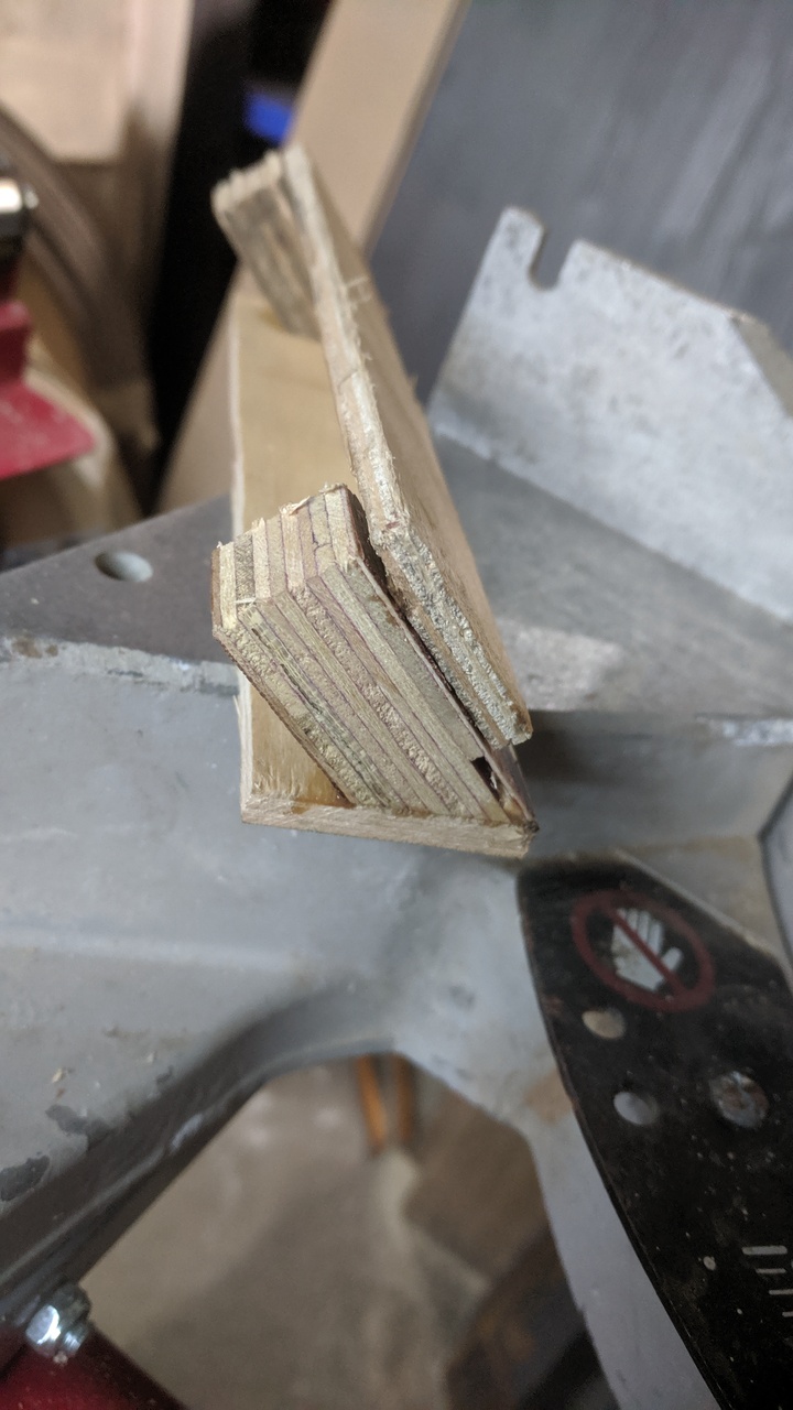

left over piece of french cleating: 18mm ply, cut to 2in wide, with a 45° bevel.

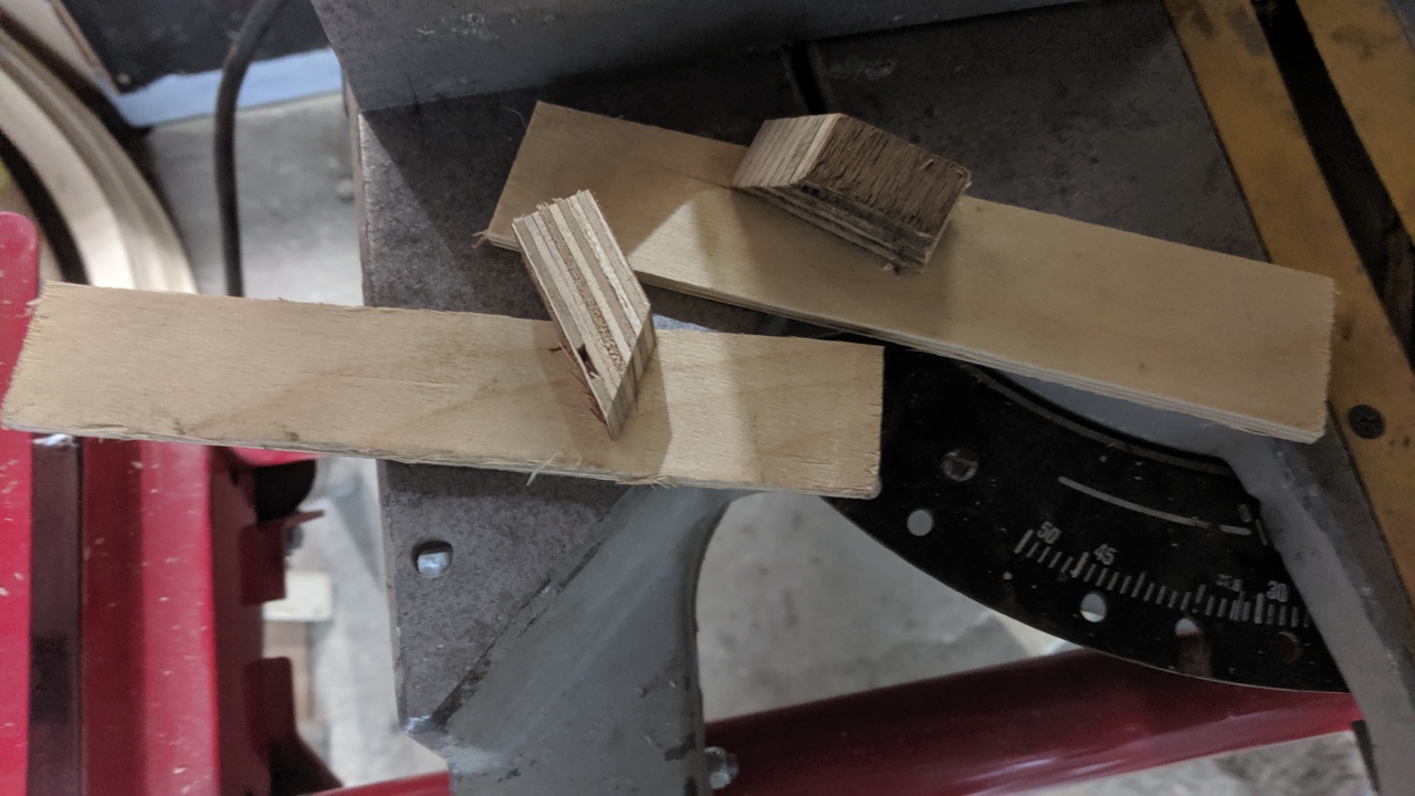

plus a scrap of 6mm ply.
cut a couple of strips of 6mm ply, around 2in wide, and two pieces of french cleat, about 1in wide.
glue/pin/screw together.

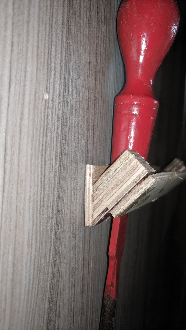

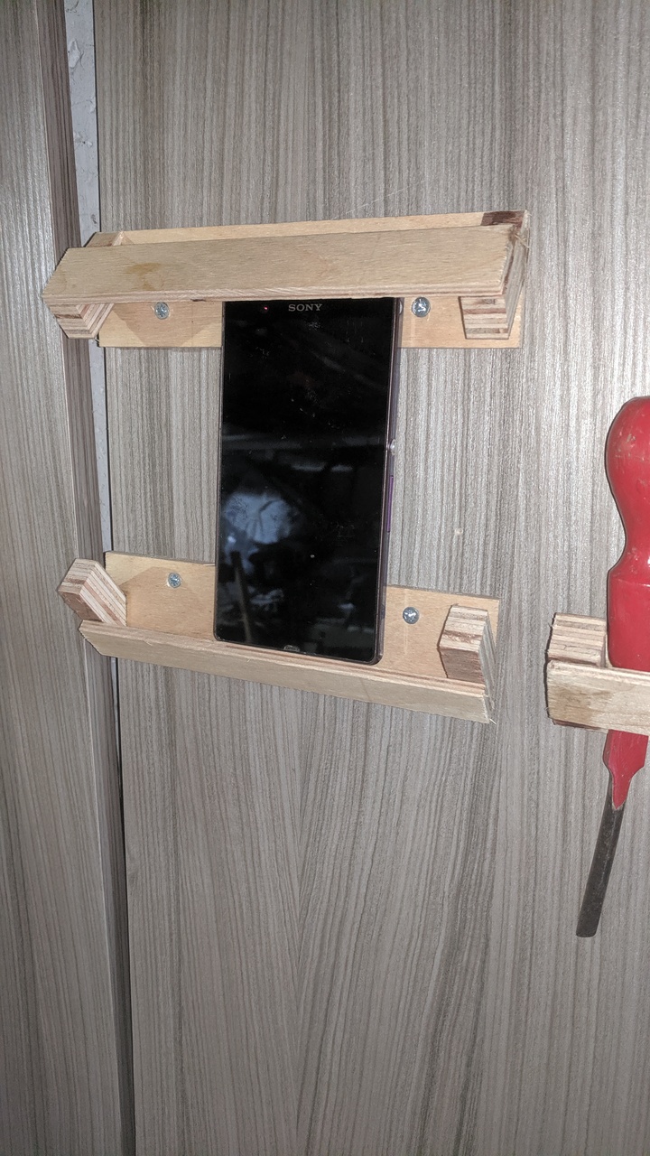

vary the height of the piece on the "flat" to change the slot size to match tool thickness.

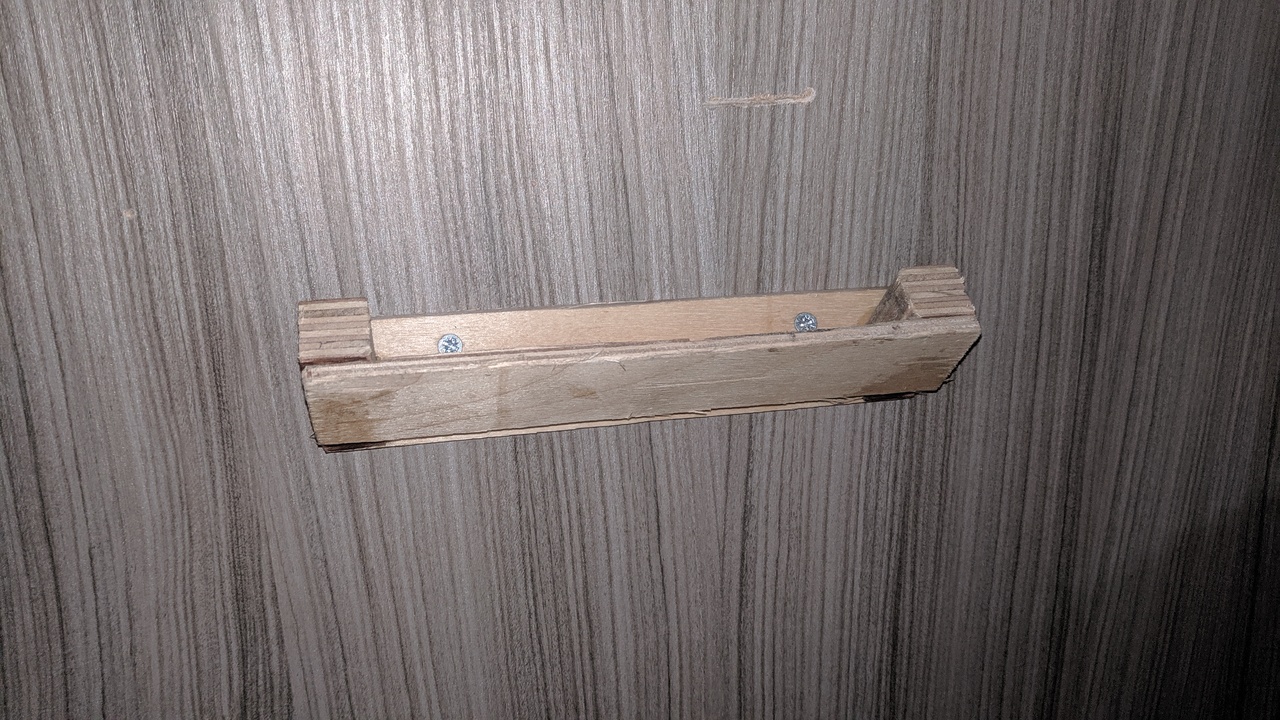

vary the thickness of the piece fastened to the "angle" to account for tool handle size.
the "angle" side goes to the wall.

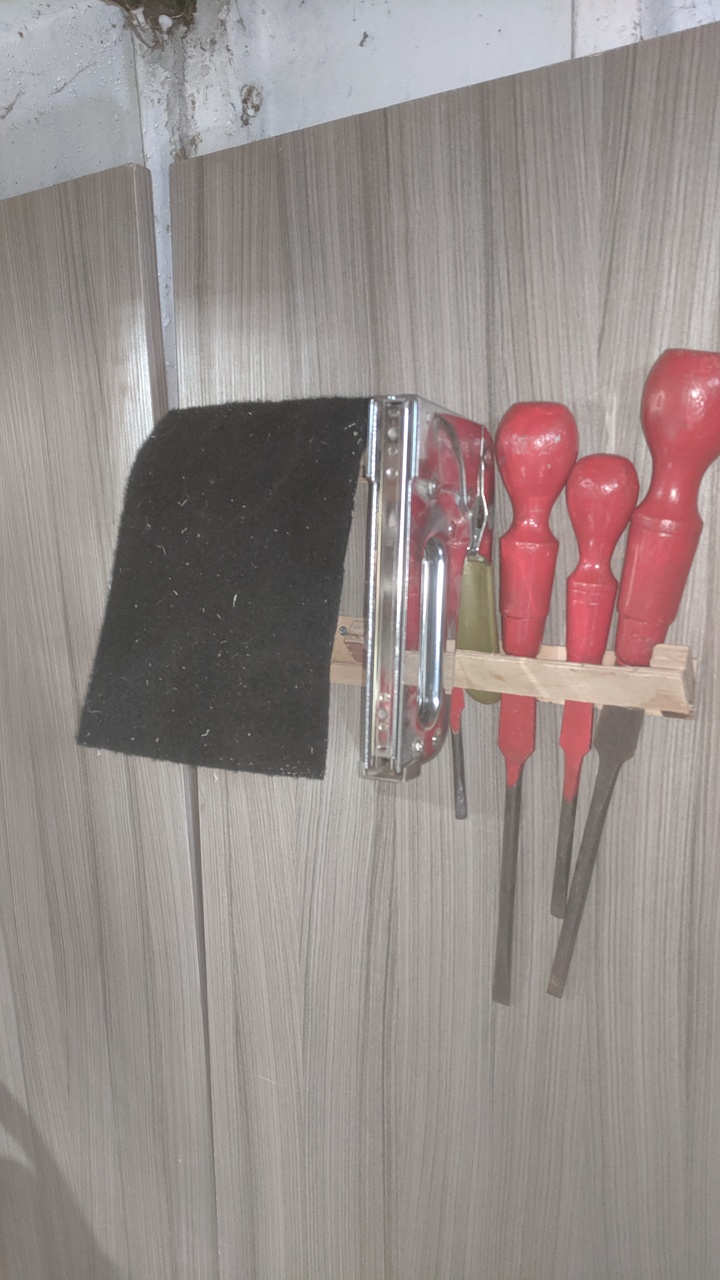

fasten to wall with a couple of screws:

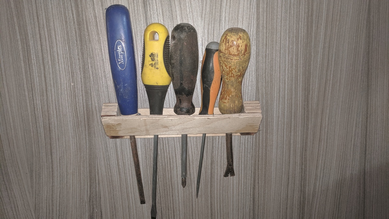

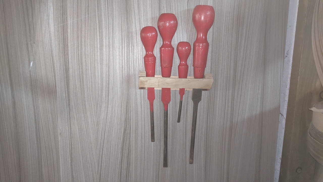

fill with tools:

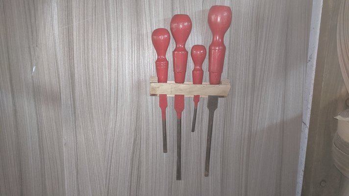

fill with tools:
