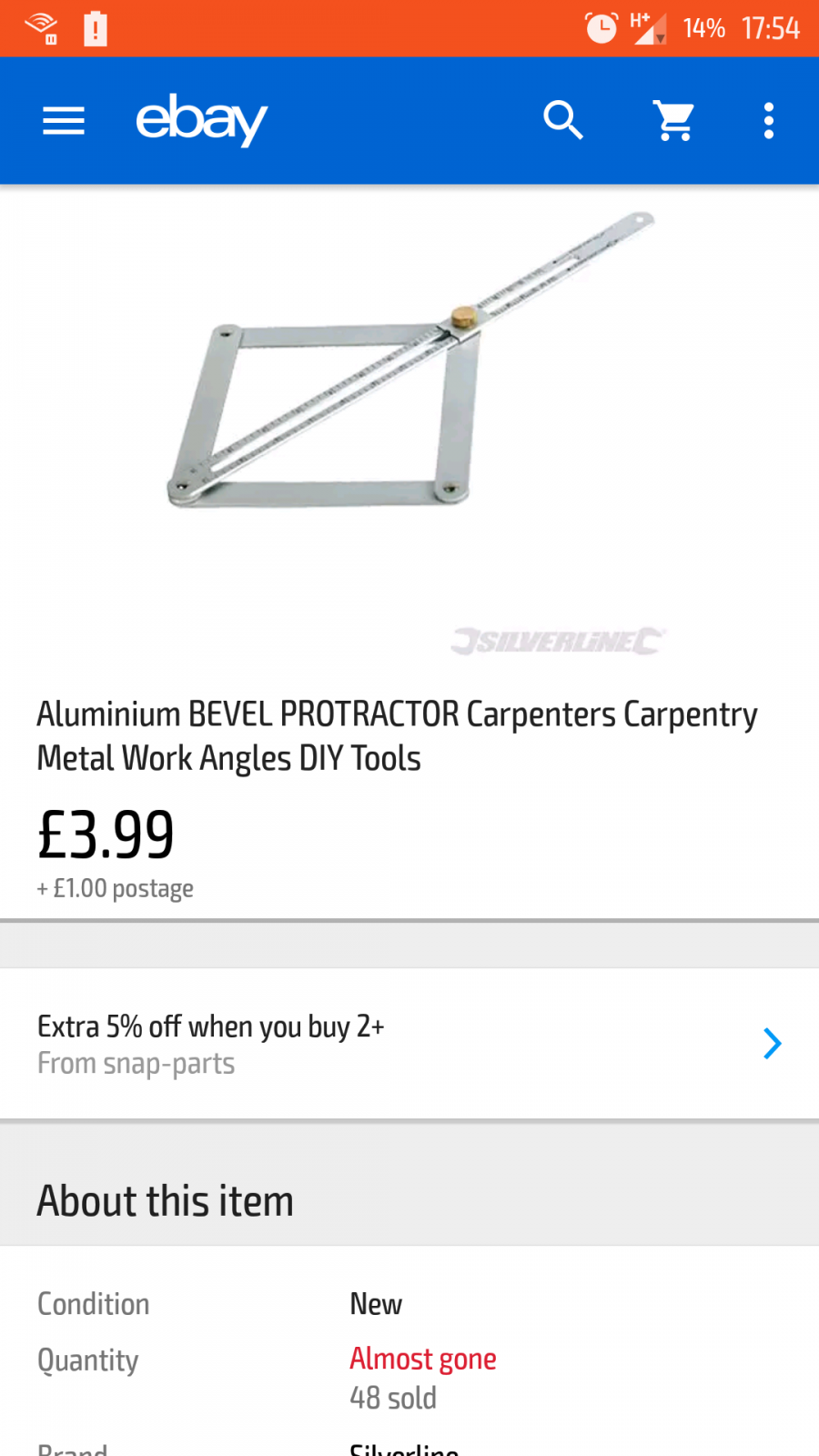

This is just a quick one to show I quickly figure the correct angle to cut a tube at, its great for one offs or in tight spaces, if I was doing it a lot, I would probably get some proper tools and a jig or chop saw. I don't need to do it a lot so this is how I get by.
Small bolt through two hacksaw blades, hold one in line with the pipe, and point the other where the pipe needs to go
lay the blades on bench and fold a piece of paper, so it matches the profile of the blades, just turn the edges in and press flat, no need to go making an origami protractor or swans or anything
