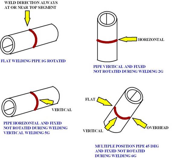

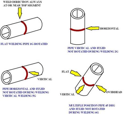

Hello, Recently my company went bust, so looking for a new job as a welder is a bit hard. I am an experienced welder, with twenty years of experience. I haven't done 3G/6G before, and here's my confusion. I know that those are welding positions, but, what's the difference ? is the welding different, stronger ? Could someone please explain to me, what exactly they are, if they use the same equipment, or it's different than just standard TIG..
