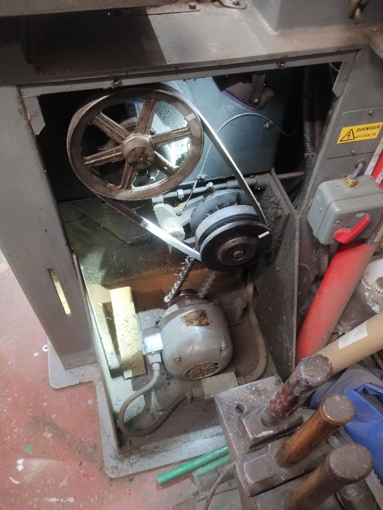

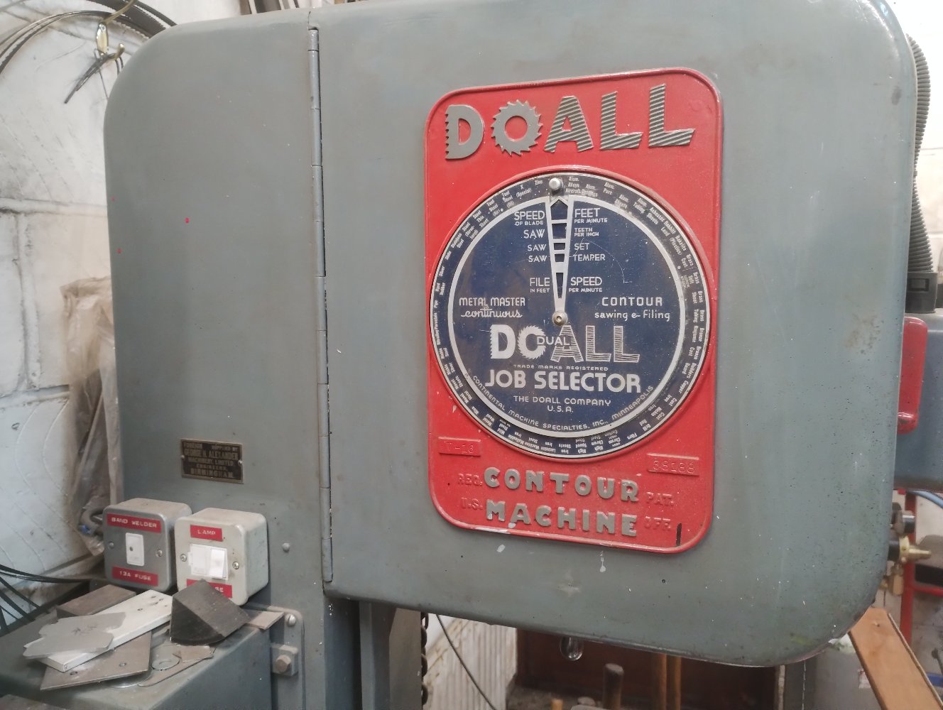

I have had a 'DoAll' vertical bandsaw for a long time, which has always given me great service. However, the speed adjustment is by a cone pulley setup which is both really awkward to adjust (a handwheel round the back where I store various sawbands) and quirky, in that any speed adjustment seems to go in leaps and bounds. So I have always used it at a bandspeed of about 250 FPM, which is fine for cutting steel etc. with an M42 HSS band, but could usefully be a great deal faster when I'm cutting Aluminium or wood.
My idea is to replace the existing 415v four pole 3/4 HP motor, with a 1 HP 4 pole motor and change the pulley arrangement to provide static gearing which delivers the existing 250ish FPM @ 30HZ, then adjusting the frequency up to 90HZ to achieve the speed increase for cutting plywood etc. Is 30-90HZ likely to be sustainable on the motor for reasonable periods of time? the idea of increasing the motor size from 3/4 to 1HP is in recognition of the power reduction which will occur at low frequency/RPM, the existing 3/4HP motor has never shown any signs of struggling even cutting heavy steel plate.

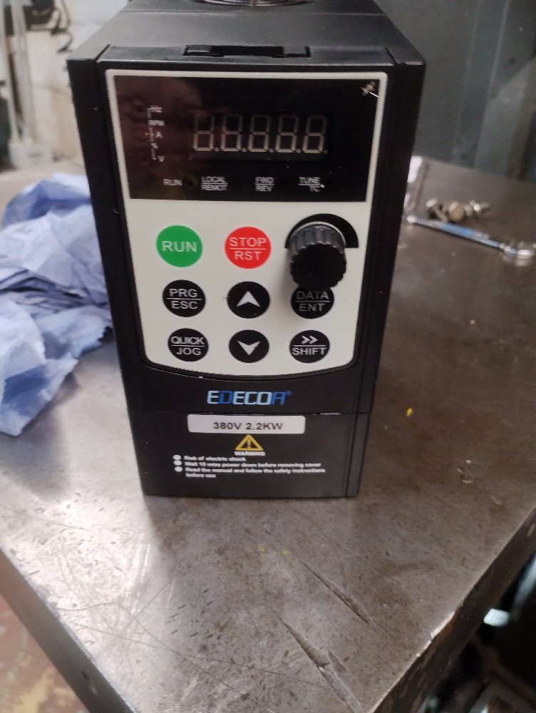

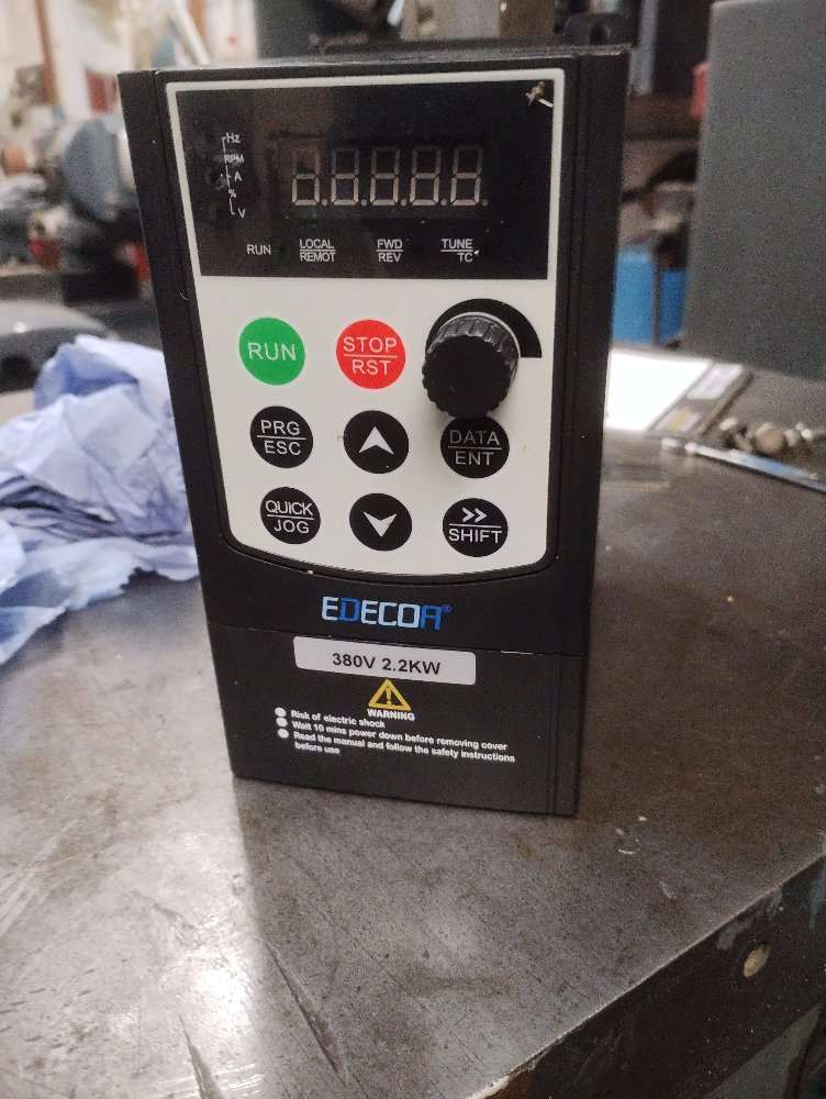

I have a new 415V in 415V out VFD as in the photo below:

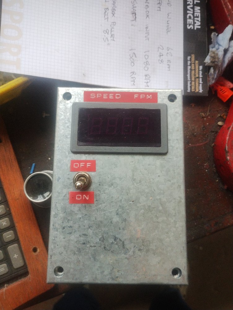

I have absolutely no experience with VFDs, so configuring this one, using its 'Chinglish' manual looks like it might be 'interesting' for me. I won't be needing the jog, reverse or any other fancy features. But I will want to use a remote potentiometer which I intend to install in my home made speed indicator. The VFD manual shows a remote pot as a configurable option, but no resistance for it is specified -working on the basis that most of these VFDs are similar inside, what would the potentimeter resistance value typically be?
