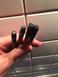

As promised, I report back from my experiences.
All stars lined up favourably today. I cranked the wee buzz box and loaded a set of fresh gouging rods.
They do not work and I explain why, and I compare to some presumably "right" rods that were in the torch.
I started off with 40 Amps. This is the low setting on my buzz box. The arc starts nicely, the sound is as usual.
Shade 13 works well and may be even too big. When pulling the rods apart, a nice flare of 2-3cm appears. Indeed it worked best around 50 Amps. Unfortunately it breaks down again after a few seconds. This is not the case with the original rods that have a metal core.
That´s the story. It is not that they work inferior, they don´t work because the flare is extinguishing.
For the record: I used Abiarc (Abicor Binzel) 8mm copper clad pointed rods.
So, I`ll cast the fishing line into the *bay...
