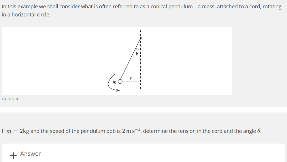

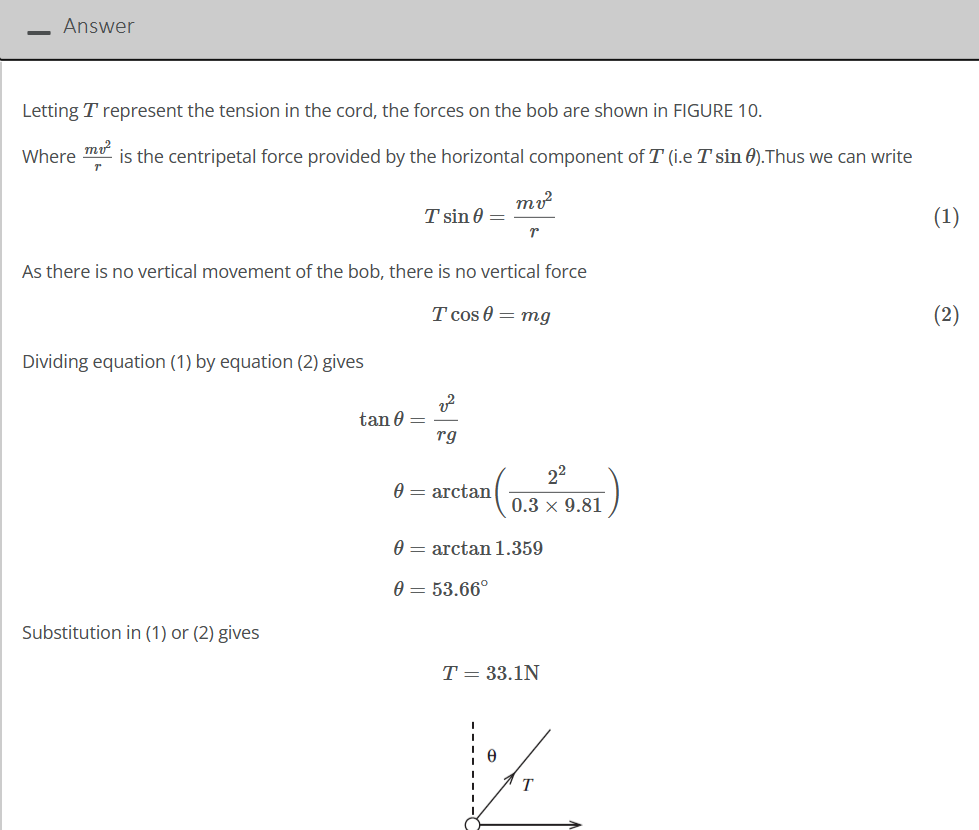

I'm working through an engineering maths module just now, and this example has me questioning my abilities.
Am I correct in thinking that the following example question is missing the radius?
The radius magically appears as 0.3 in the worked answer, and I want to make sure I'm not missing something blatantly obvious...
