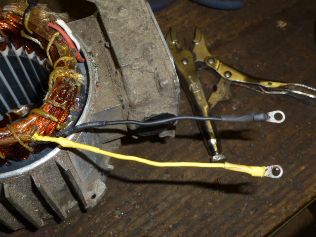

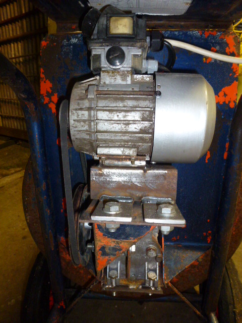

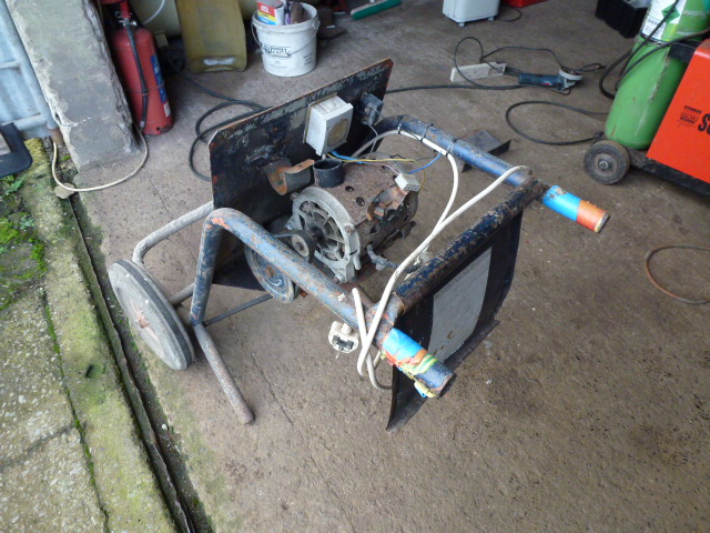

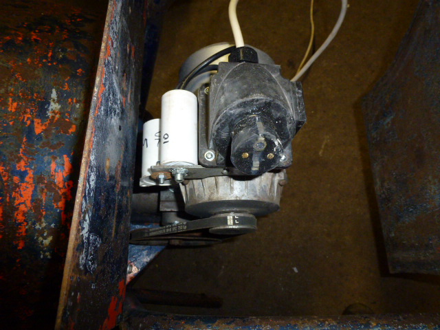

I'm trying to get an old mixer running again. I inherited it from my uncle who had fitted a 300w washing machine motor to it, it ran ok for years but it has now stopped working.

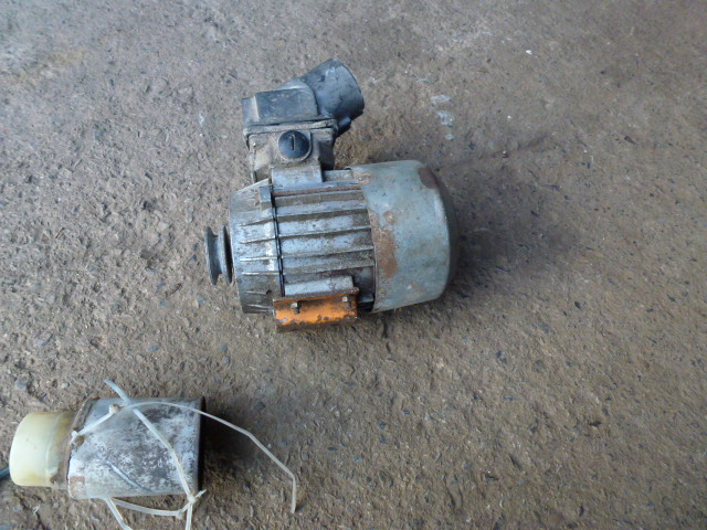

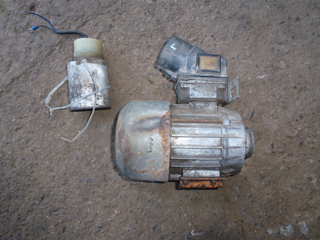

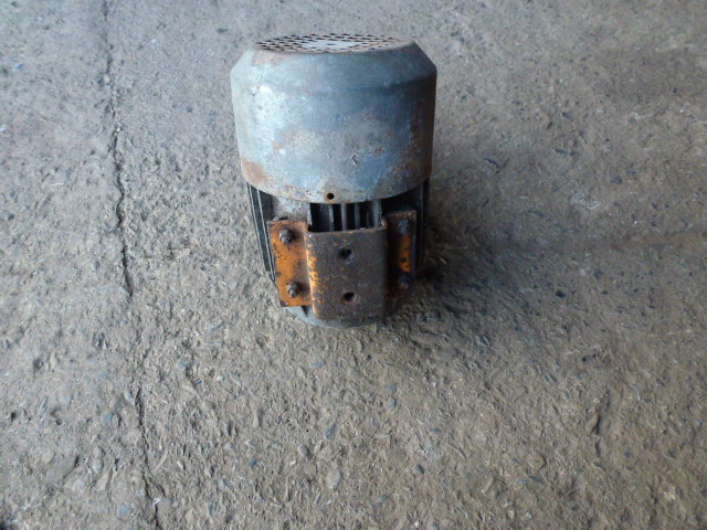

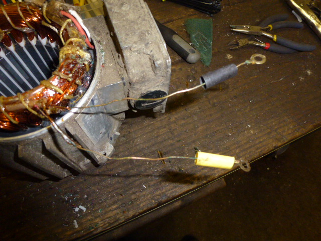

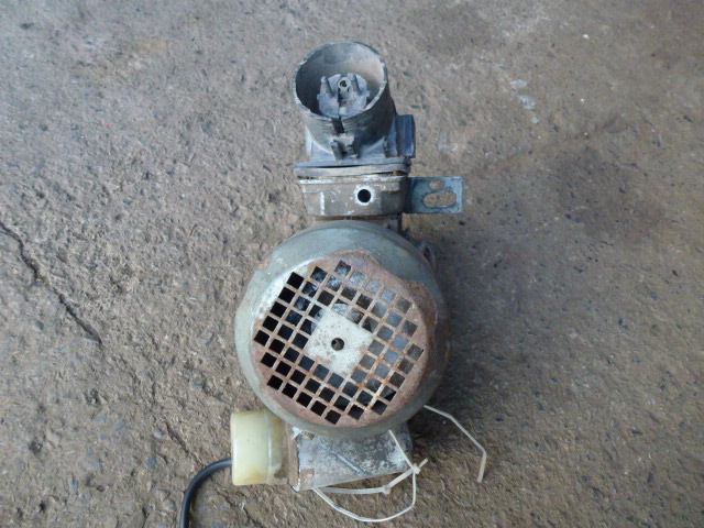

I have another motor to go onto it that came from another mixer but unfortunately the motor plate is missing. It looks like the correct size but I don't know if it's 110 or 240v (no cable), what the current rating is or what capacitor it needs. The capacitor on it is not original, no markings but I measure it at 8uf which I think is too small.
The motor has a socket like this moulded into the cover, similar to a euro socket. This was used on some older belle mixers & you use a fly lead for it. This would indicate it's a 240v motor but I've tried it on both 110 & 240v and it runs sweeter on 110v and draws a lot less amps - 0.2A on 110v & 1.6A on 240!

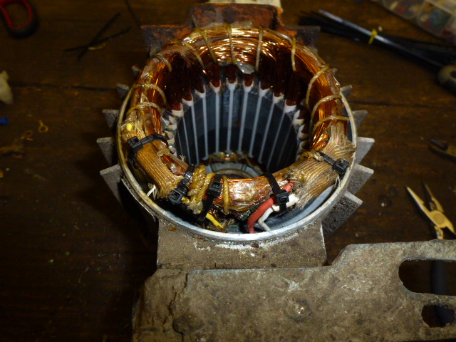

I repaired some wiring on it & it's running but I'm not sure what capacitor it should have or what amps it should be pulling.
I'm going to fit the motor, try different capacitors under load but I would like is some ballpark figures.
So if you could please take a look at your mixers & try to get this info off the motor plate & capacitor.
Voltage 110 or 240v
KW or HP prob around 370w, 1/2hp
Current (A)
Capacitor rating in uf, maybe 25uf on 240v, 110uf on 110v
Thanks for your help.
