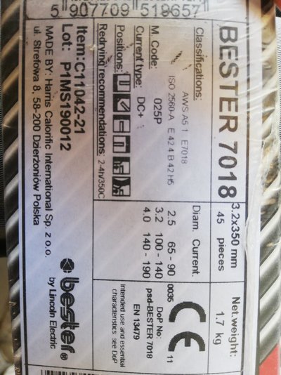

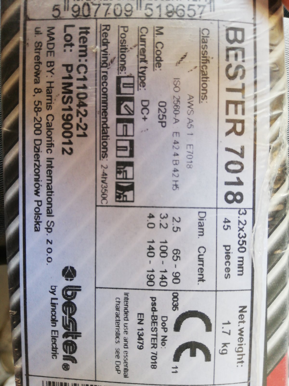

For example my Lincoln 7018 025P are not registered?
What?
Just codes but not approved

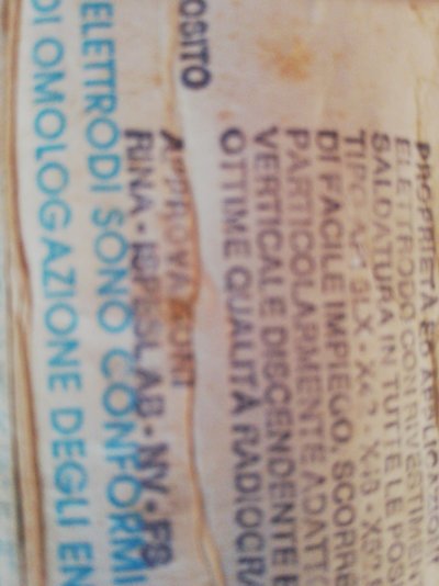

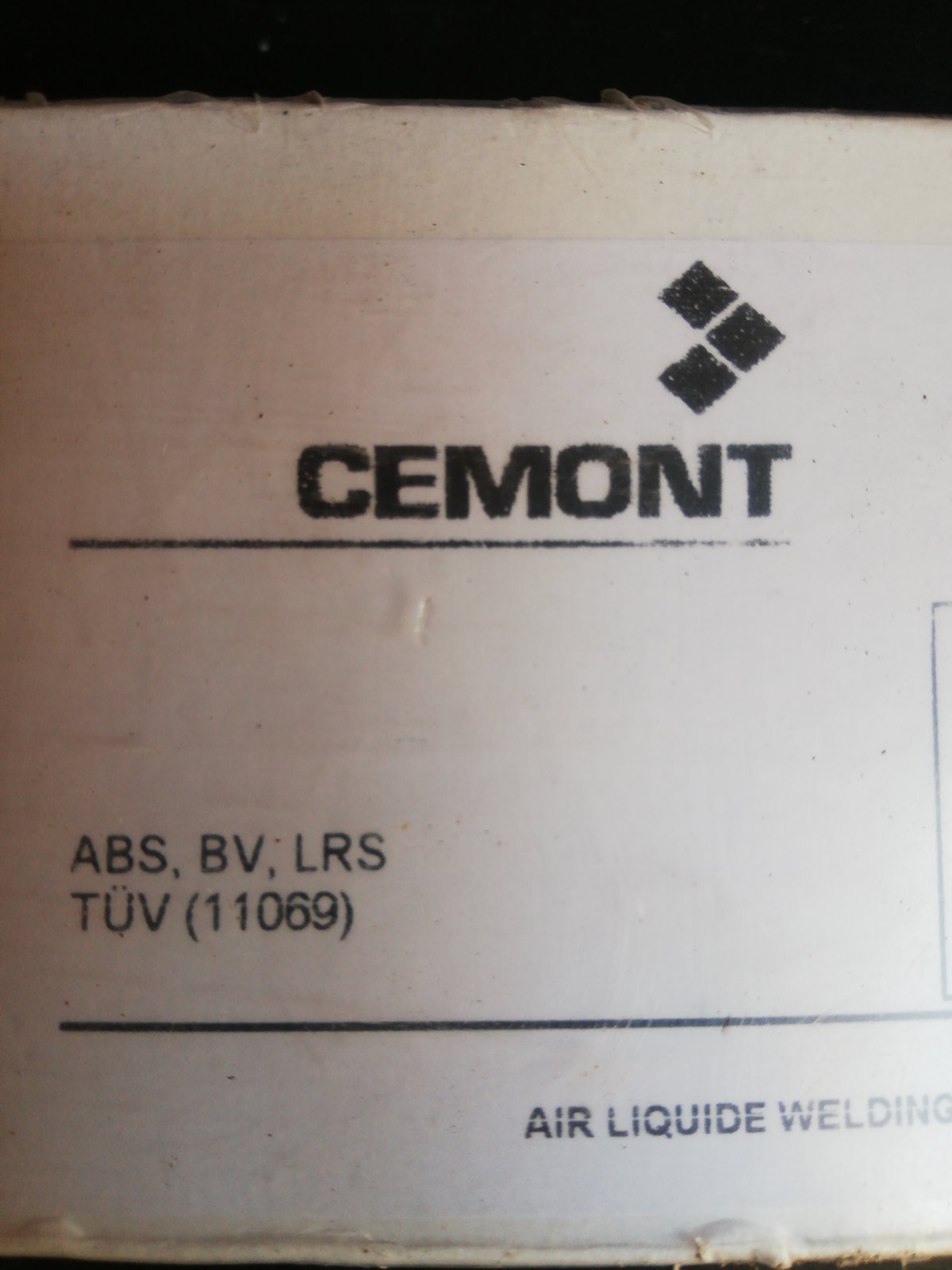

Let's check my citoflex box and my cemont box
Citoflex are approved by
Rina Ispeslab NV (Norsh Veritas again don't know if I wrote right) and FS
They are expensive to obtain and maintain and manufacturers often choose not to gain the approval so they can sell them cheaper.....
