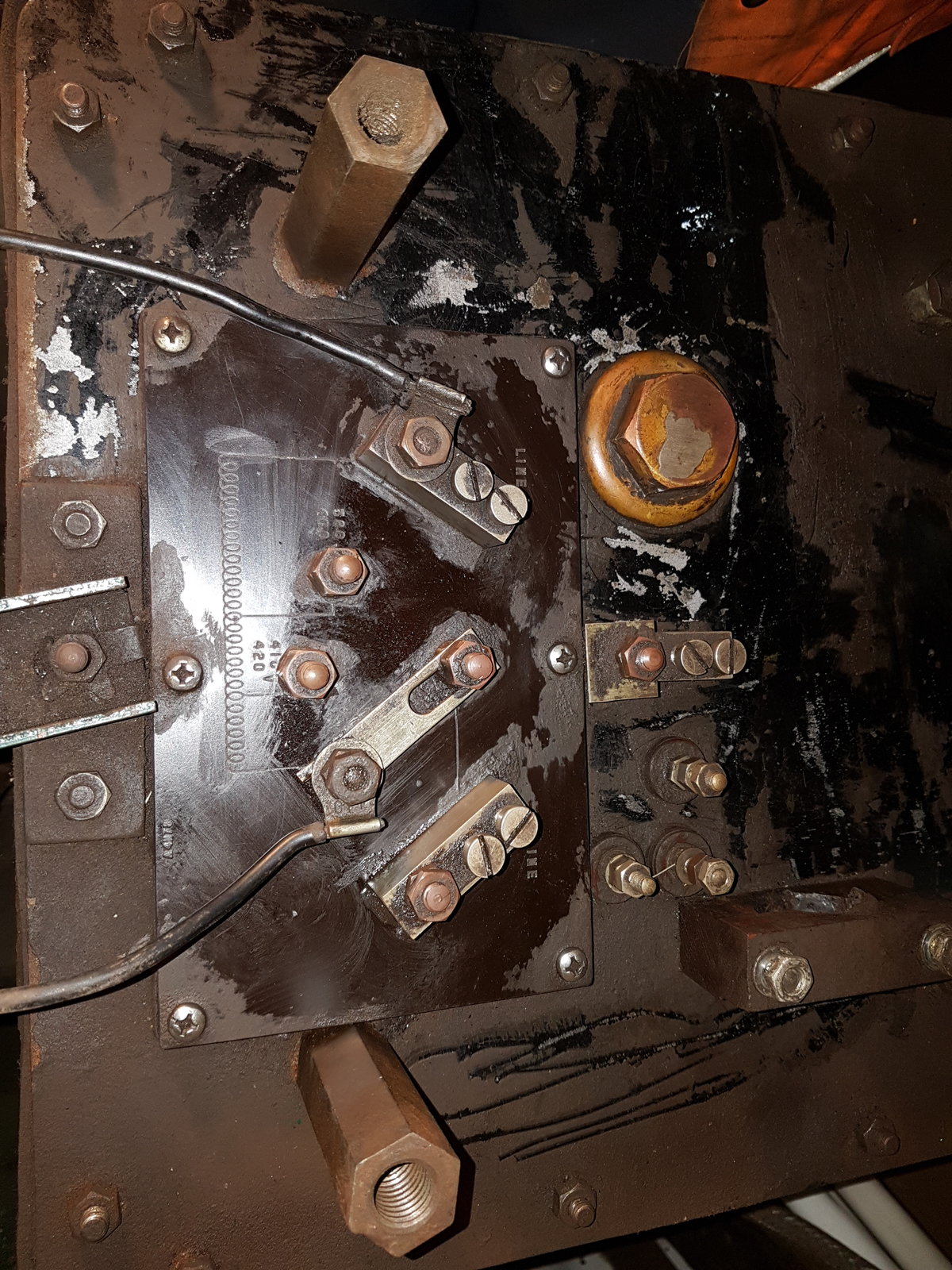

Sorry I know this is a tad late View attachment 165291 View attachment 165292

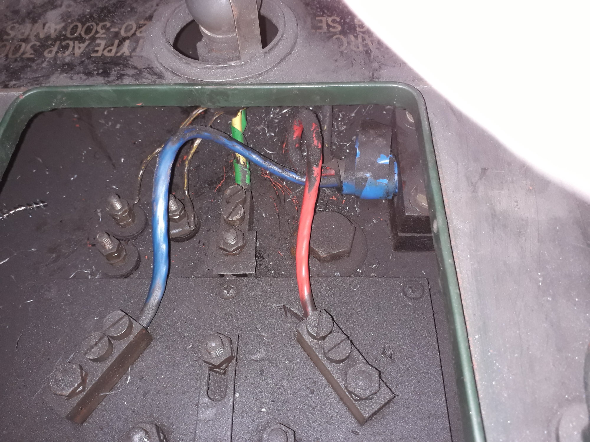

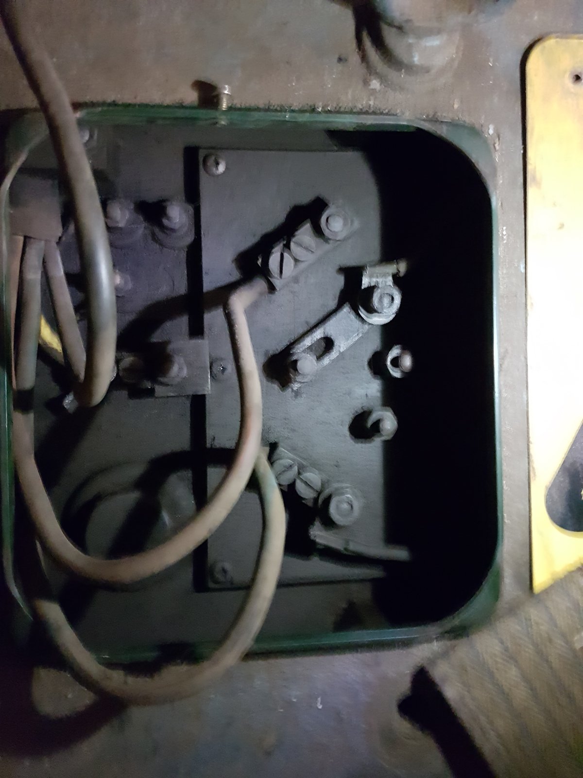

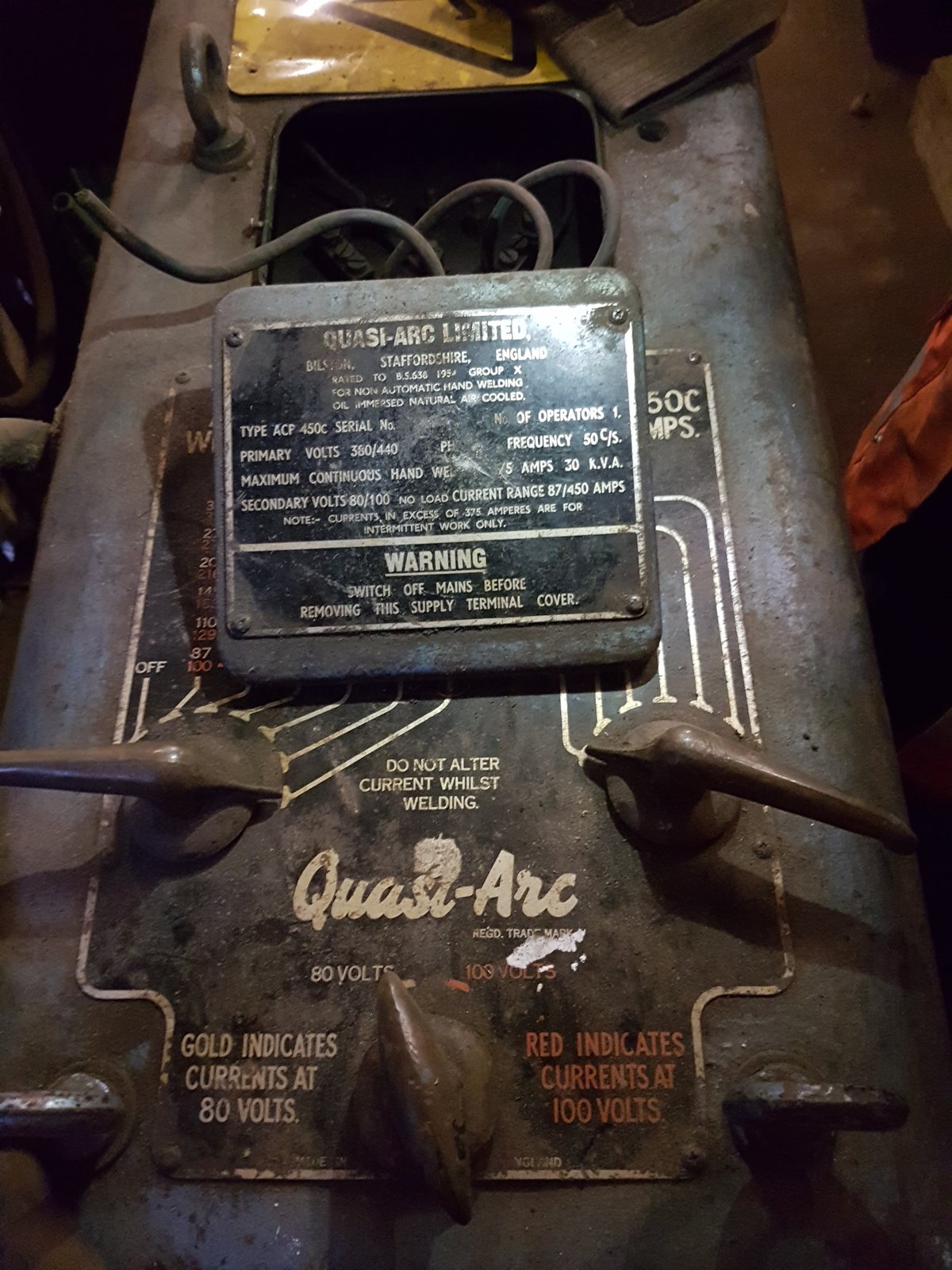

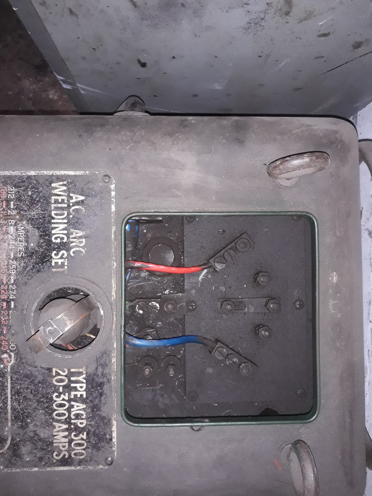

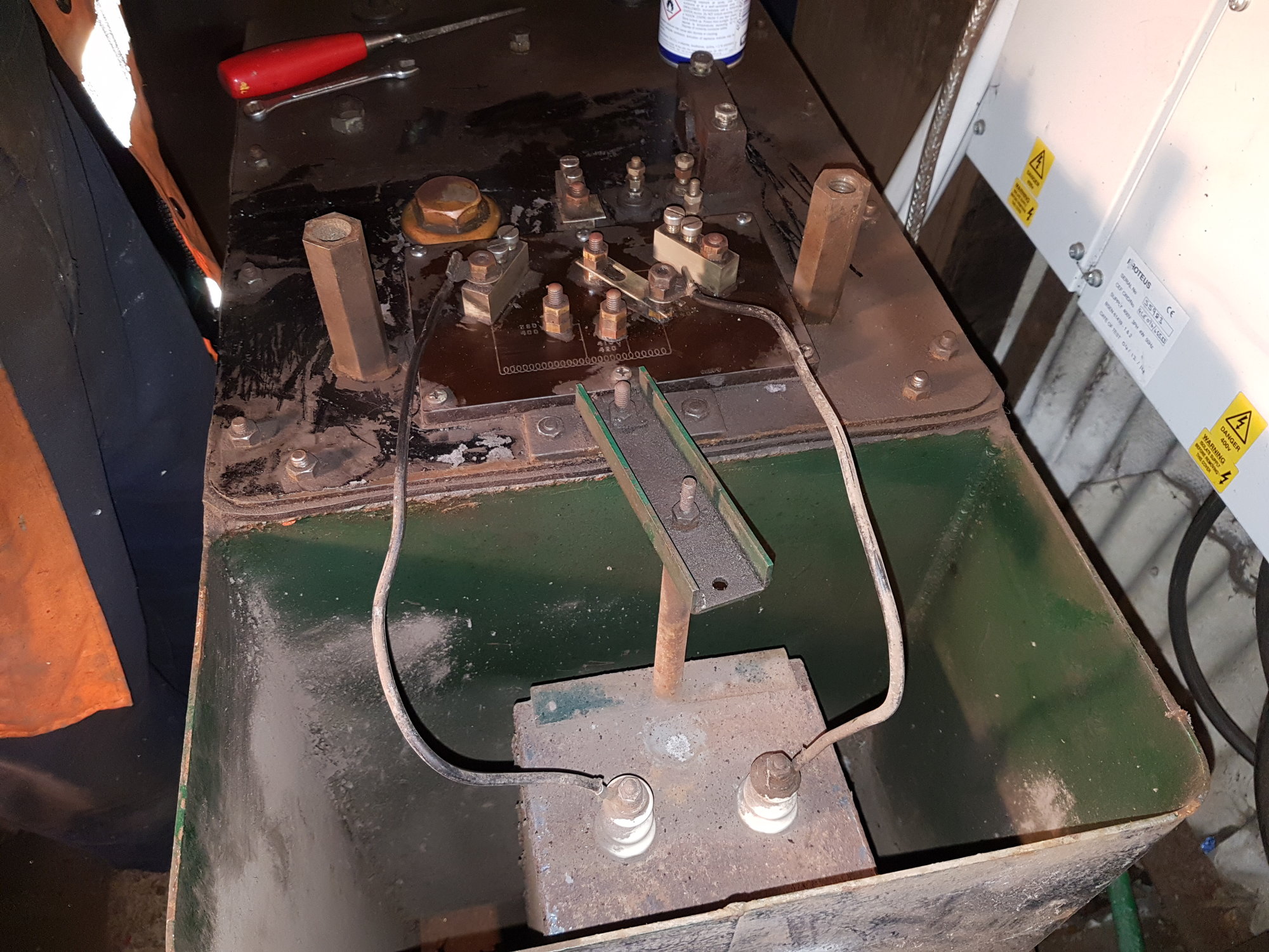

thanks for the pics tigman, the only difference i can see is ours has a smoothing capacitor fitted between the two phases, ive added a couple of pics.Sorry I know this is a tad late View attachment 165291 View attachment 165292
up and running now, turns out that of the three phases to choose from in our building we used one that was disconnected at the distribution cabinet,Dont get a shock cause of me will you , im not certain but thats what it looks like to me !
