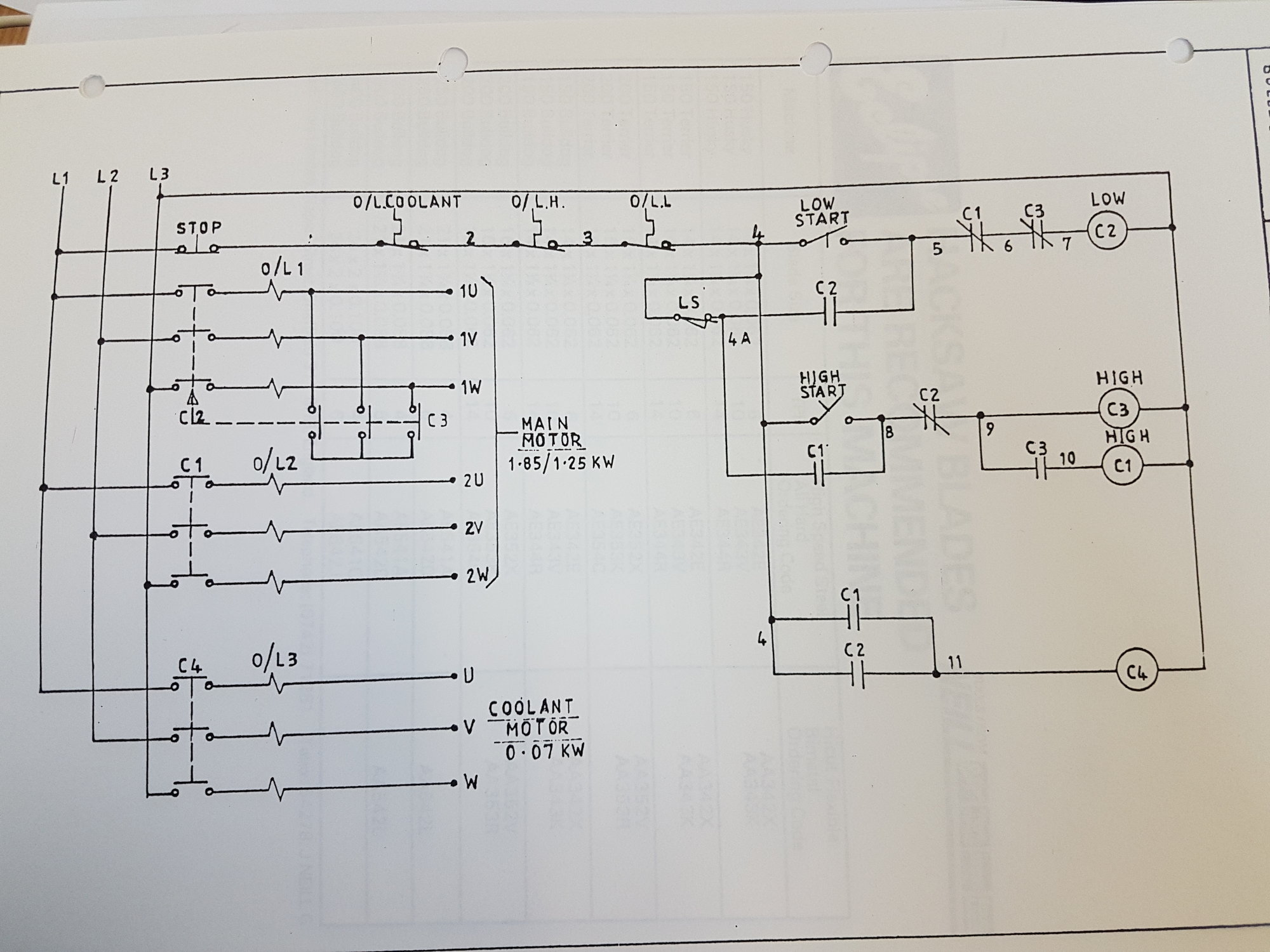

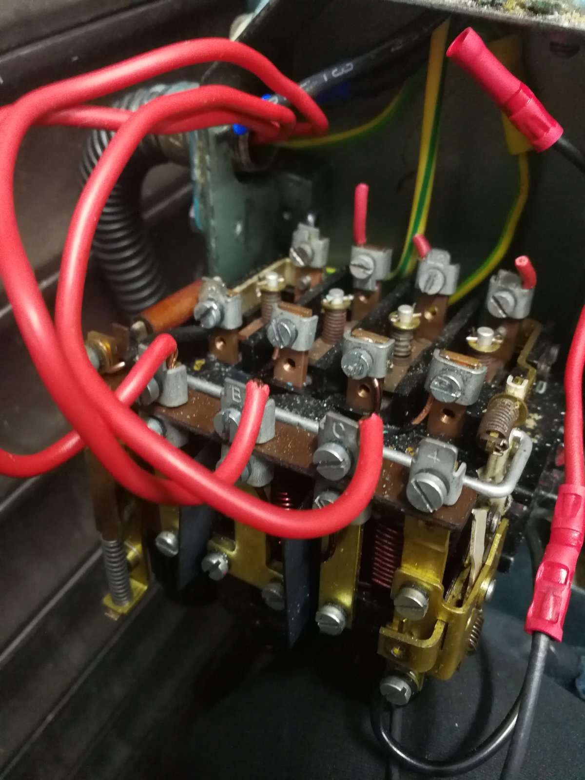

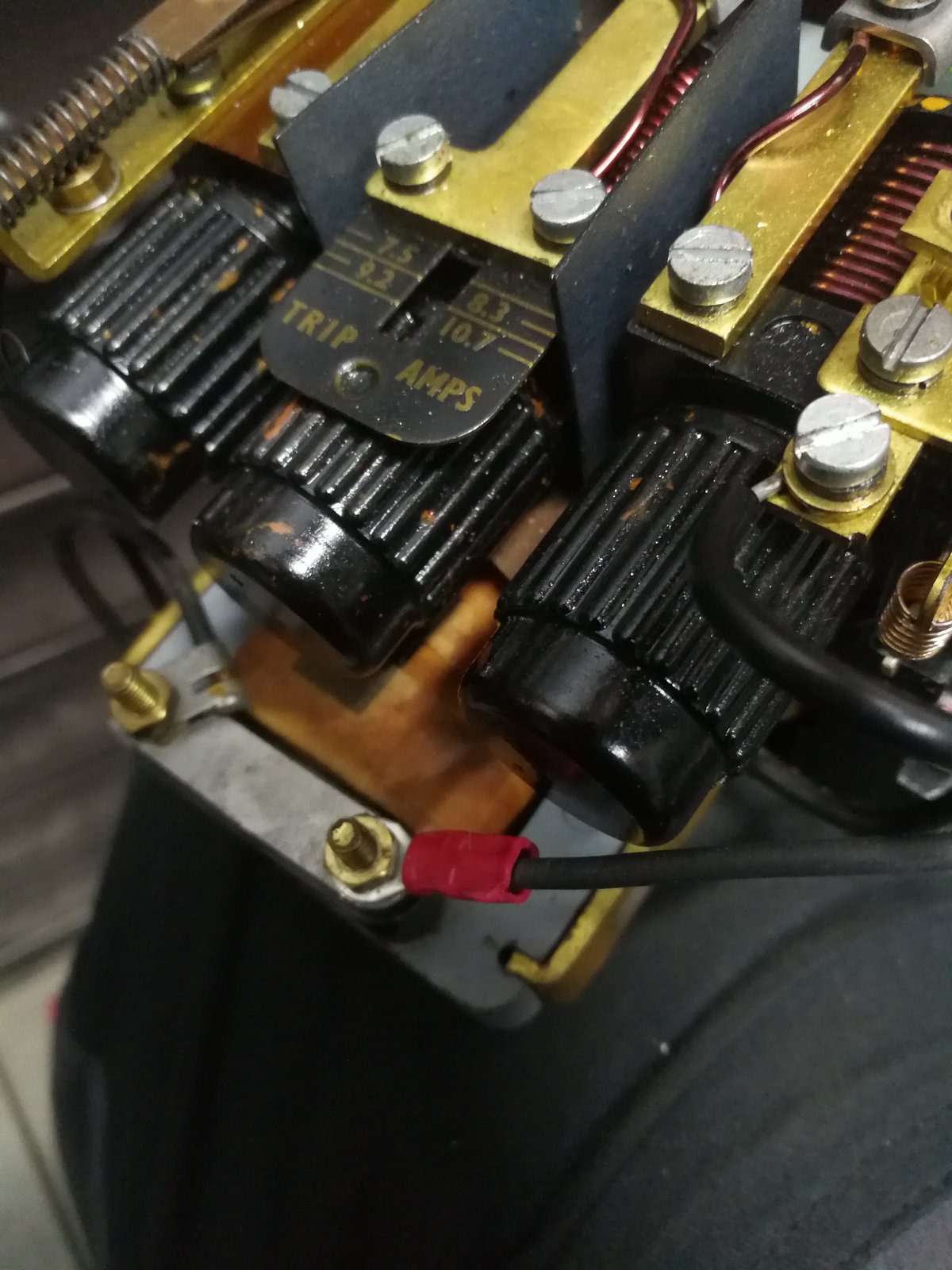

I have a Q&S hacksaw that I pulled from a workshop where it was being used so I know it works.
When removing I disconnected (cut) the 3 phase wiring to the contactor and took it away.
In the process of moving I snagged the conduit that carried the cables to the cut out switch and managed to pull one of the cables off the contactor.
I have no wiring for the contactor ( Allen West & Co) and no idea where the cable went. I was hoping there would be some evidence left but appears not
Given the length of the cable it would have come from the top of the unit
This is the cable to one side of the switch that was still attached
Any help greatly appreciated
