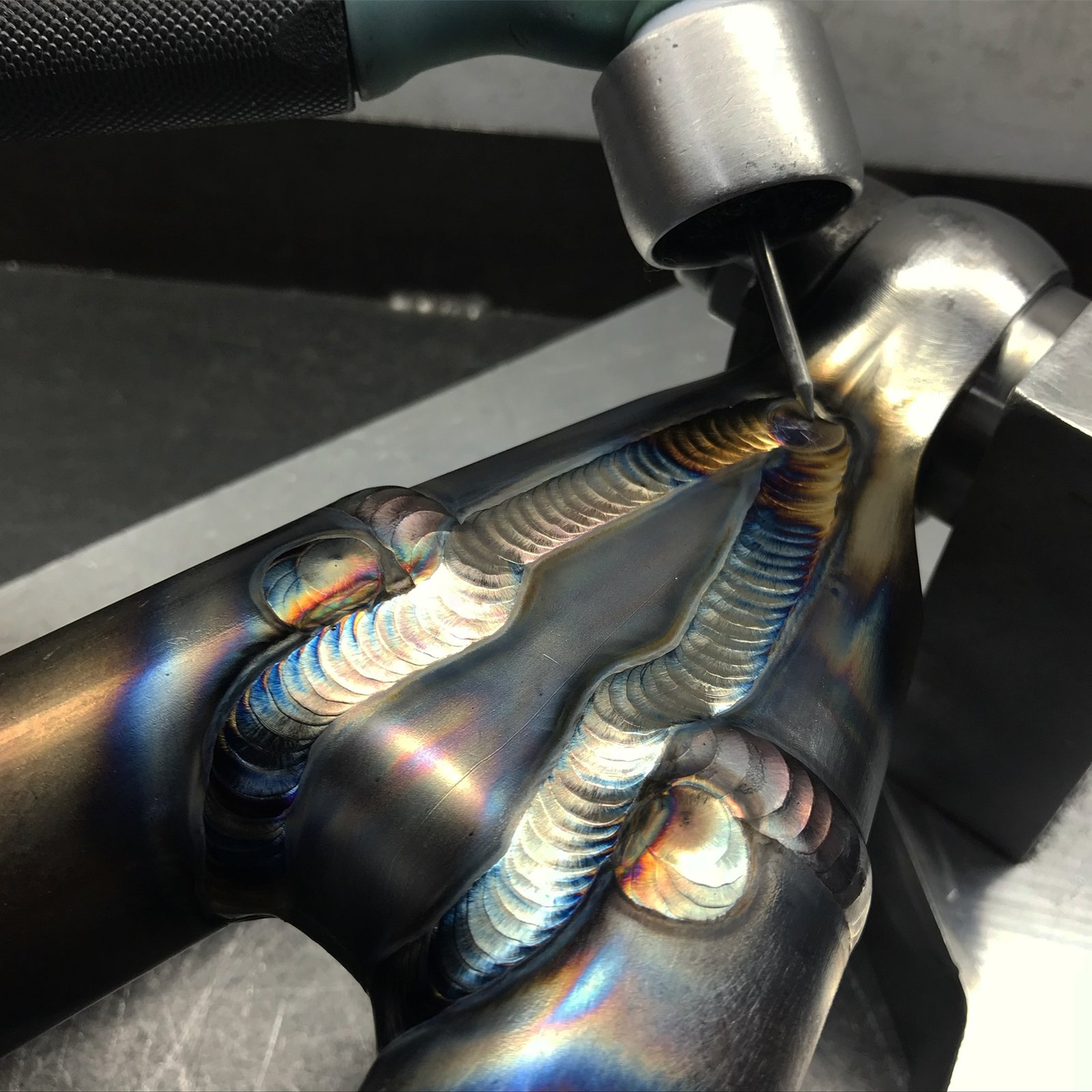

I thought I’d give a Pyrex cup gas lens kit a try..
Mines a 1.6 gas lens for a WP 26 Parweld torch and a No 12 Pyrex cup..
I must say for me personally it’s superb.. I can really see my electrode clearly now like never before, I know many experienced Tig guys will say they are not needed but in my case with sight in one eye only it’s making a massive difference..
The Pyrex cup is staying clean and the little kit came beautifully presented superbly packed etc.. been using it for two months now with out issue..
Took 2 weeks to arrive from China but was well worth the wait.. I’ve ordered a couple more but with No 10 cups this time..
