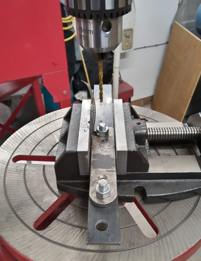

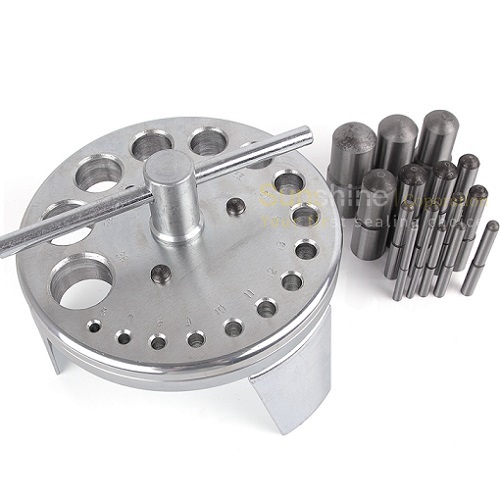

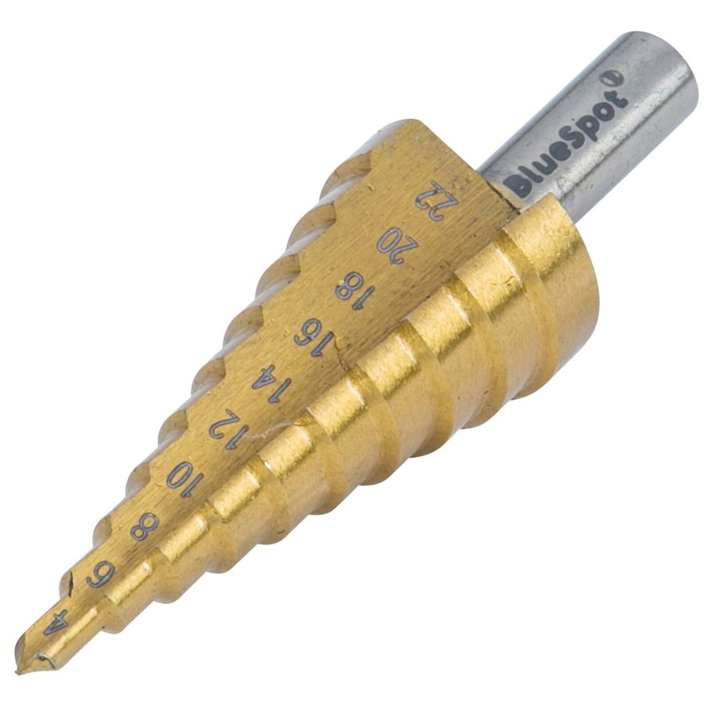

I need to put some 4mm (5/32) holes in some very thin (0.5mm) and narrow (8mm) stainless steel. Jubilee clips to be precise. I've tried a hand drill and whilst it will put a hole through, it wont put it exactly where I want it (despite centre punching) and as it breaks through it mangles the clip.
In my head, I think I need a punch of some sorts. Any ideas/suggestions?
