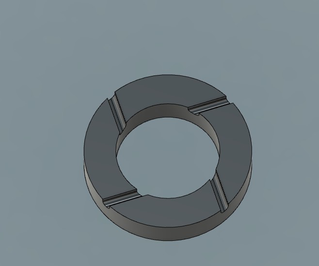

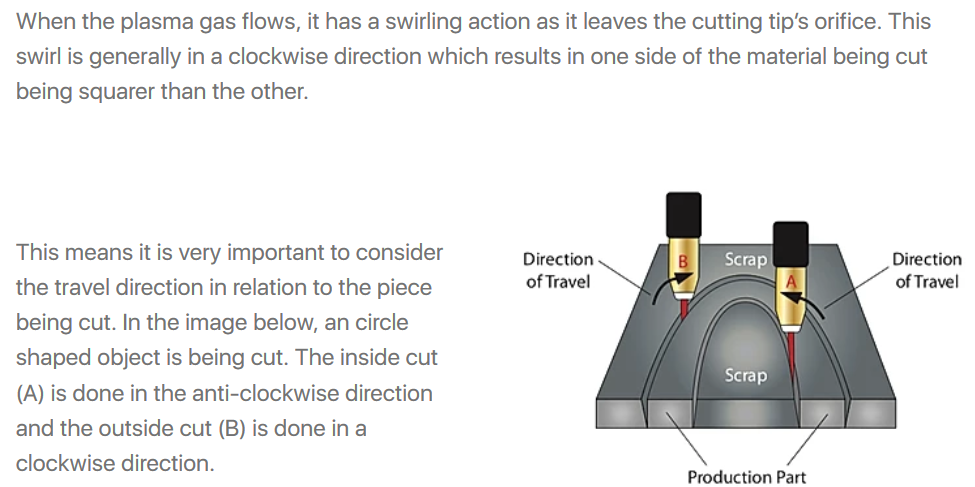

HI all it says on the internet human machanics makes it easier to pull a plasma torch rather than push it.
It also says if you are pushing your torch the square edge is on the right side, there is no mention which side is the square side when pulling your torch toward you. Anyone know?.
