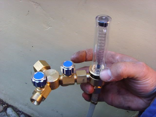

ok so ive had the hf inverter a while now (IFL 200 hf) and ive managed ok with the supplied twin gauge regulator , but will need to do some purging on stainless tube fittings ive got to weld up .
so today i bought theses bits
thinking about it tho i think i need another flow meter to go to the welder
or would it work ok just using the purging line with the one flowmeter
oh and approx what flowrate shoulsd one purge at , ? or is it just suck it and see
cheers mike

, say you want 7 lpm at the torch, and ten to purge, set seven on the peashooter, 17 on the regulator, and ten will go to the purge.
