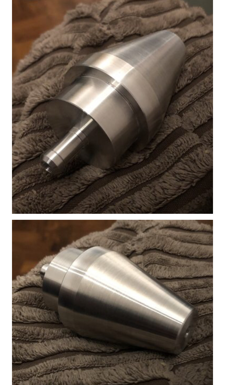

I’ve seen such things been sold in kits for extortionate money and thought that would be an easy thing for the little Myford to knock up.
Aluminium cone with barbed fitting for a pipe suitable for 20-40mm seamless tube purging.

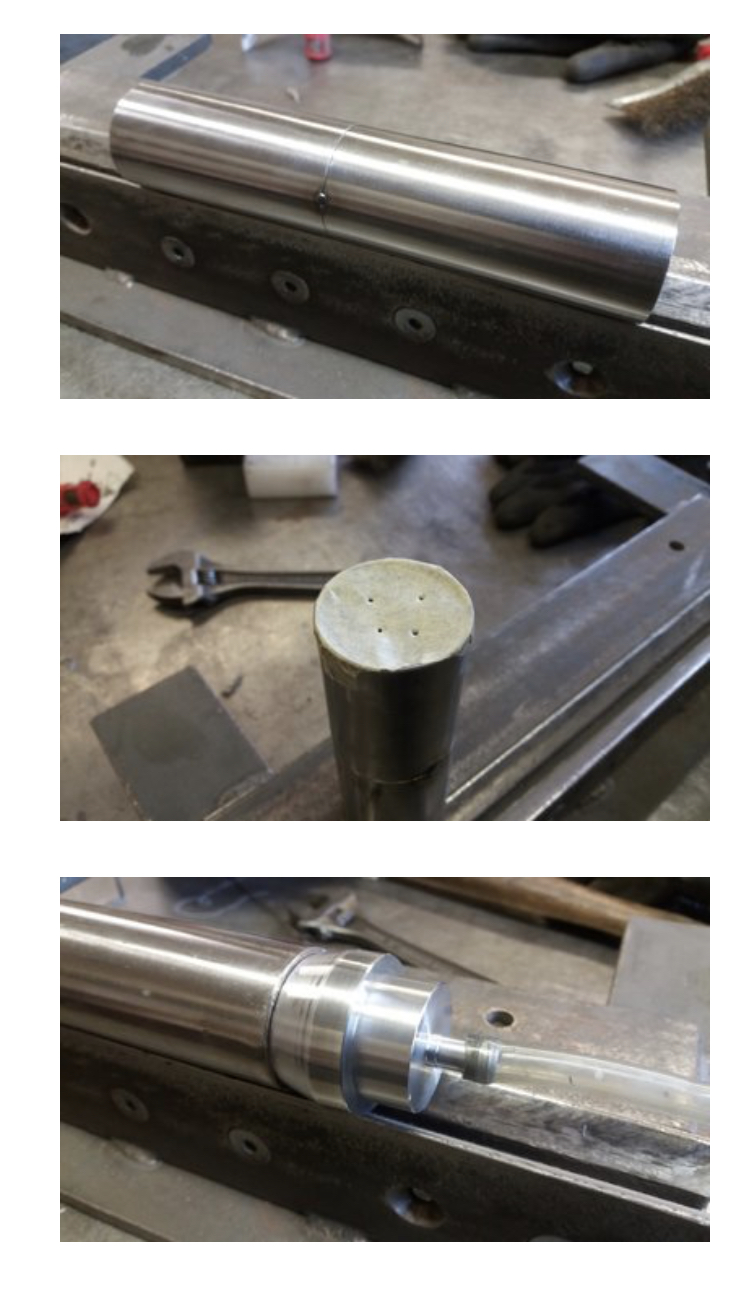

As I’m not in a position at the moment to try it out I donated the device to our full time stainless fabrication man @Paul.

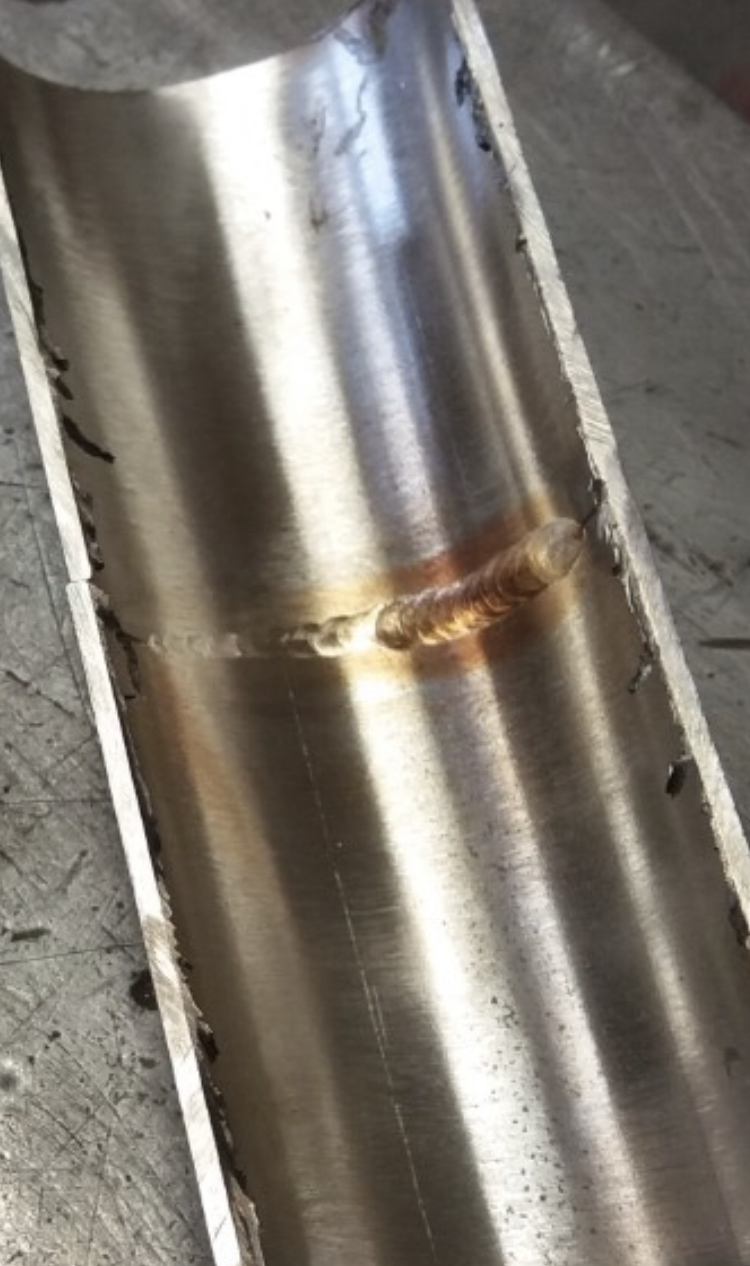

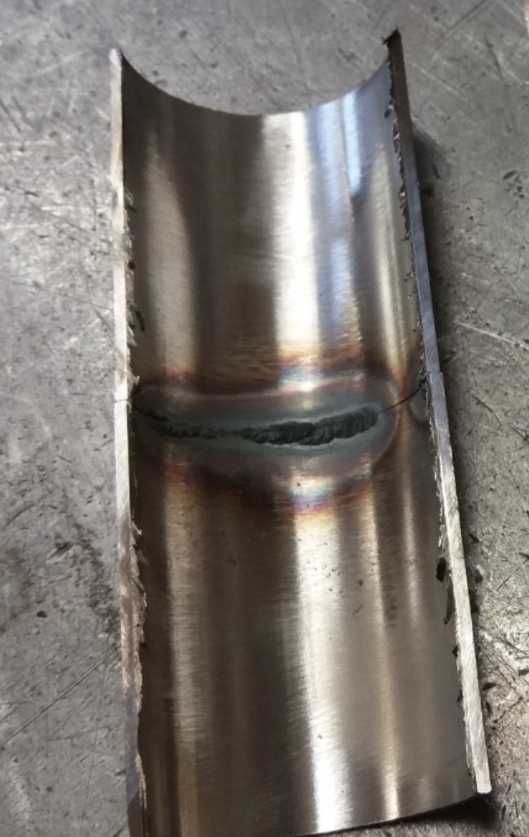

He cut up 2 lengths of tube and did half with the cone half without and from the results it seems it works pretty well.
Feed back I got was on the next one to use a slightly longer taper to help it fit better in the tube other wise it does it’s job.

Before they left
On arrival at Paul’s place
Without the cone purge
With the cone purge

Before they left
With the cone purge
