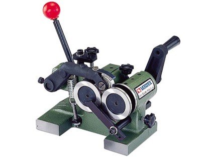

Morning All, I’m part way through head rebuild on motorcycle and have some valve seat cutting equipment on the way. Like most of them it uses a guide that slides into valve guide to cut seat concentric with newly reamed guide bush.
I want to be able to grind my own guide pins so looking at options between a pinch grinding spinning body like this.

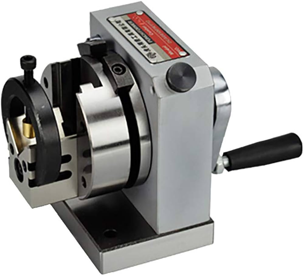

Or this other style which I think will reduce what material I can hang
out the back.

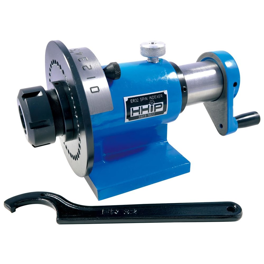

Or a simple spin indexer like this.
I know nothing about punch or cylindrical grinding so would welcome advice on accuracy and usability of the above. I have rotary table and indexing head so those abilities are not of extra use elsewhere.
Final option is grinding head in lathe but havent measured concentricity of my spindle I can’t imagine it being great.
