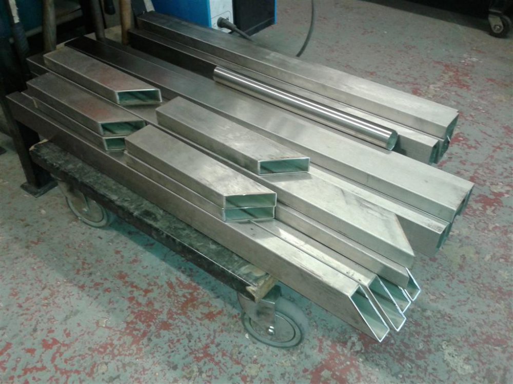

These are for use in a chemical works for moving servicing and storing pumps, framework is made from 60 x 30 x 1.5 box section

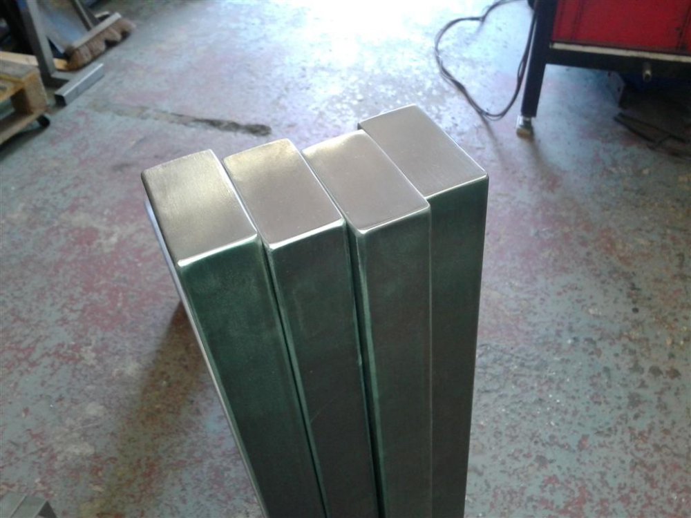

First get it all cut up

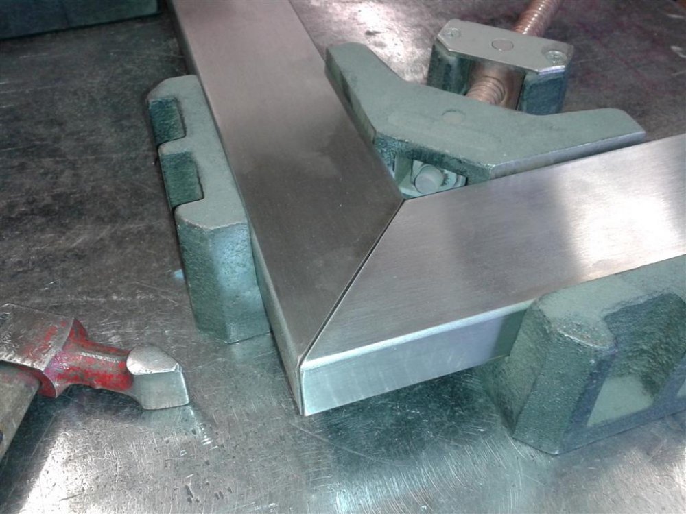

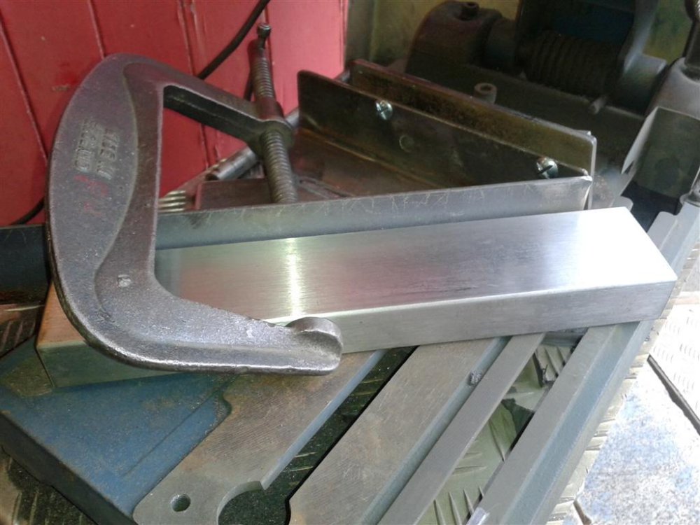

All done on an abrasive chop saw, a simple mitre attachment saves having to keep moving the vice and fiddling with the set up
Close enough for me
Ends capped and polished off

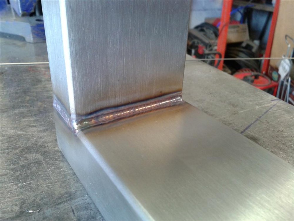

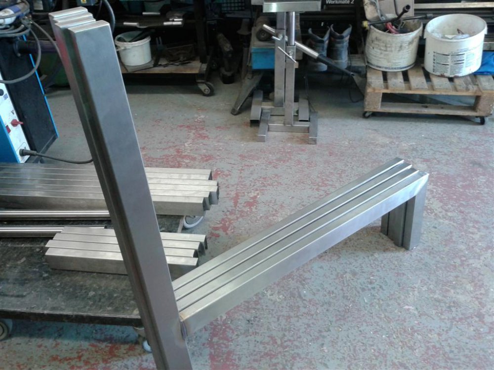

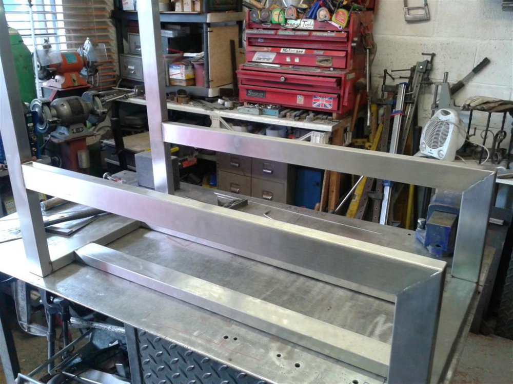

Side frames fabbed up
Then onto the bench to build the rest

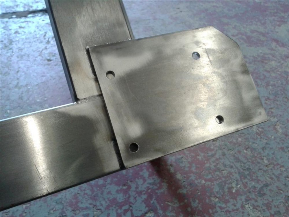

Castor plates drilled and welded on

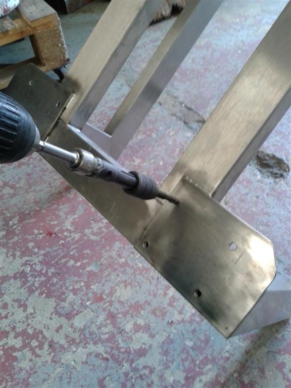

Then drilled through into the box section and tapped M8, a cordless drill and a machine tap get used here, much easier on the wrists than manual tapping

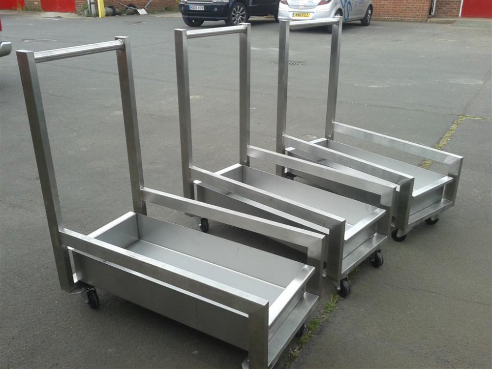

Bolt on the wheels then fold up some simple drip trays from 1.5mm stainless sheet, and we're done.
Actually they are not quite finished, there will be a couple of cross bars or a plate on the top for the pump to sit on, the customer will do that when they decide which of the many different pumps they will be used with.
