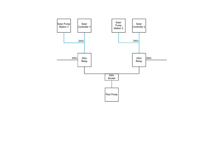

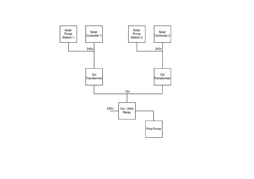

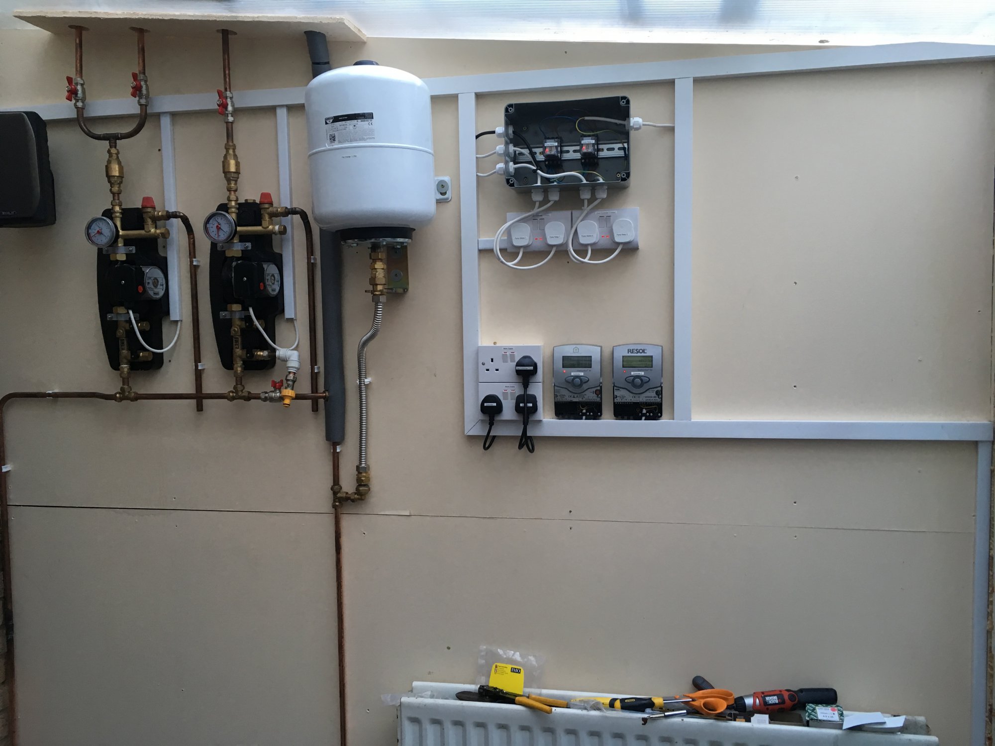

I want to control a central pump from 2 different controllers, I've thought of 2 scenarios and was just wondering if there is any other method I have not thought of. The two solar pump stations need to operate independently of each other but if either one or both of them is on then the pool pump needs to be running.
