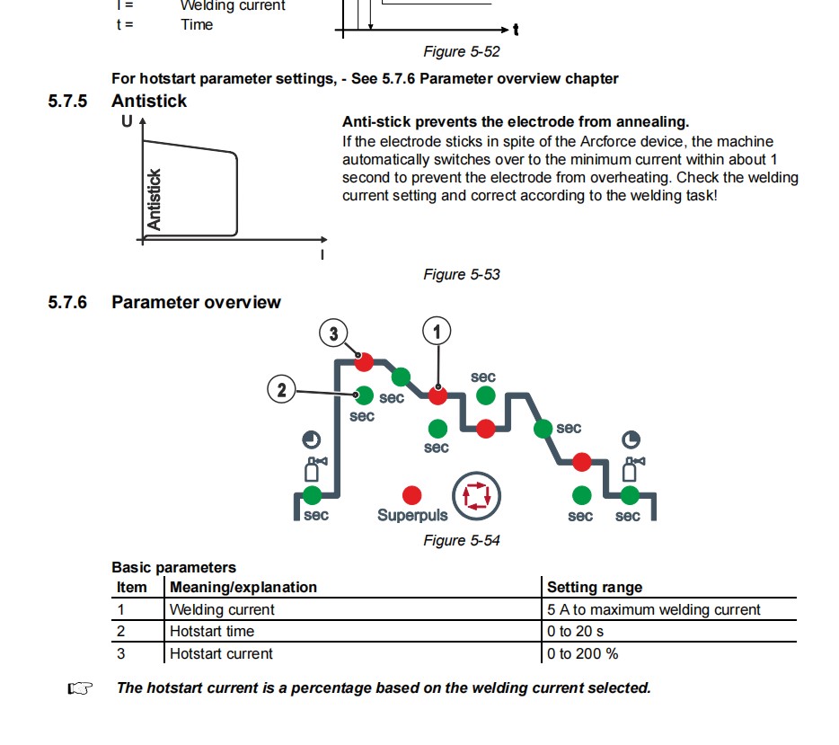

Anyone have experience of pulse mma, I am toying with the idea of getting one but not sure if it will have much advantage.
I only have experience of Tig and Mig pulse welding, Tig I don't really find much benefit but Mig (Aluminium) it is fantastic.
I was thinking it may be good for stainless positional welding. I don't have too much bother with positional welding stainless with mma but then I never really had issues with positional Mig welding of Aluminium either but the pulse Mig has made life much easier for me and I would hate to go back to a standard Mig on Alum.
