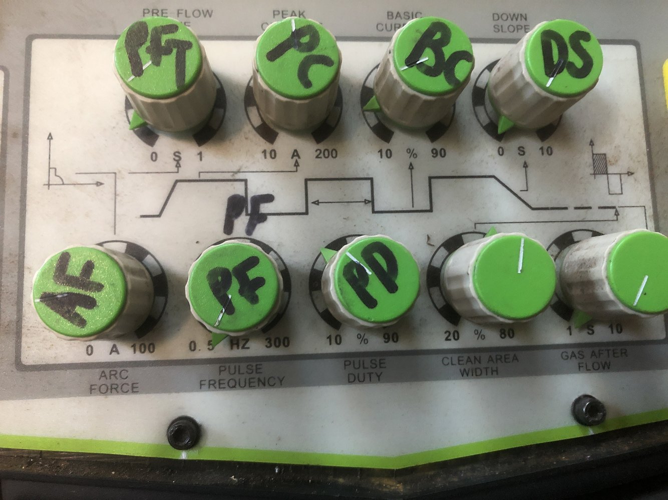

I’m having trouble getting my welder to pulse as slow as it says it should. Even when the dial is put to 0.5hz it seems to be actually pulsing around 2hz, and I could really do with it being slower as I aim to be working on some thin tubing. Any ideas? It seems to be the same if I’ve got my foot pedal attached or not.
I’m using an sip p214. Pic of my settings below if that helps.
