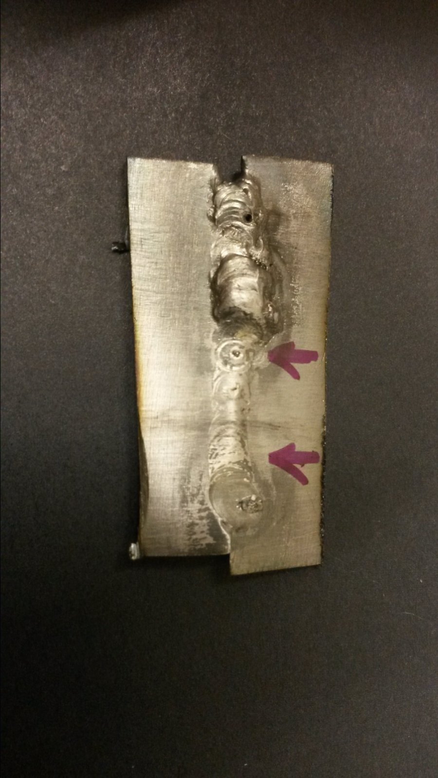

Hi Folks,
I was messing about last night with some 1mm sheet steel, only a short run say 3". Never TIGd anything this thin before and took it down to about 15A and still managed to blow the edges apart. I was feeling adventurous and decided to play with the controls on the RTech (160). I'm still on the torch button here as I'm not quite comfortable with the pedal yet. So I set up a pulse program (do you call it that?), and after not much fiddling was welding beautifully. It helps me time my travel, which I struggle with, and I know when to add filler. After much frustration when setting this machine up a while ago I now remember that this is how I laid my first good looking weld on some 3mm. Then I read up and the most common school of thought seems to be 'turn it off when you're learning', so I did. (And have had a lot of success since...and a lot of failures.) So my question is why? Will I miss out on the fundamentals and have to make sure I always have a welder with a pulse function in future?!
I also came across some videos of manual pulsing with the pedal today - looks like fun, and makes me want to plug the pedal back in.
What say you, learned tutors?
